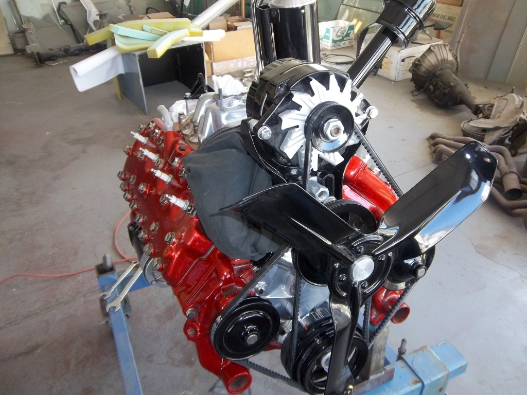

    Here are a couple of shots of what it looks like in better light. Got it on the cart pretty close to being able to fire it. 100_3732.JPG 100_3733.JPG 100_3734.JPG

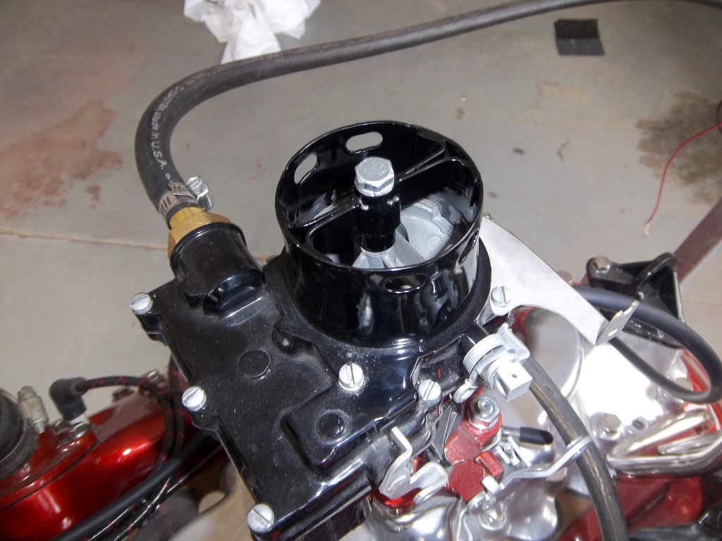

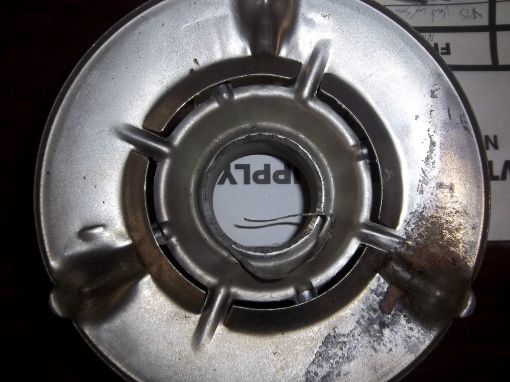

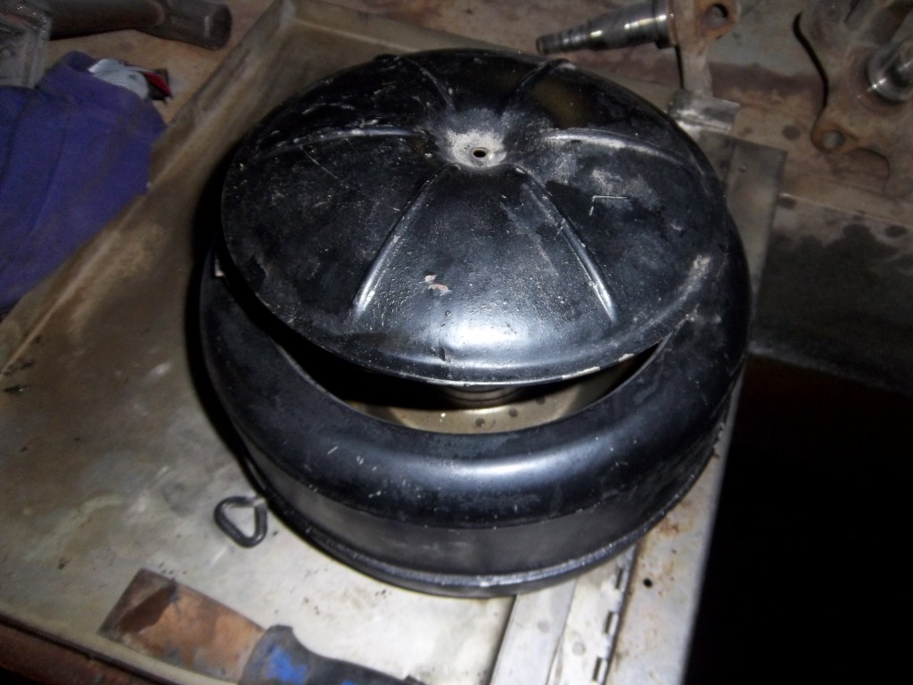

    I know it has been awhile but it is my busy time of the year and it wasn't happy being awakened from it's slumber. It blew the lower radiator hose at the end of my break-in just as I knelt down to try and find my oil leak. So I took an impromptu 190 deg shower. Burned side of my face,back of my head, arm, shoulder, and a large portion of my back luckily (I guess) all just severe second deg no third. For 2 weeks I wasn't supposed to do any thing in the shop. Got a lot done on the old flatty since my last post. Here is my air cleaner set up. I cut the oil-bath air cleaner up and gutted the inside.
    The horse hair and mesh from the filter part of the lid. 100_3669.JPG 100_3670.JPG 100_3827.JPG 100_3828.JPG 100_3829.JPG

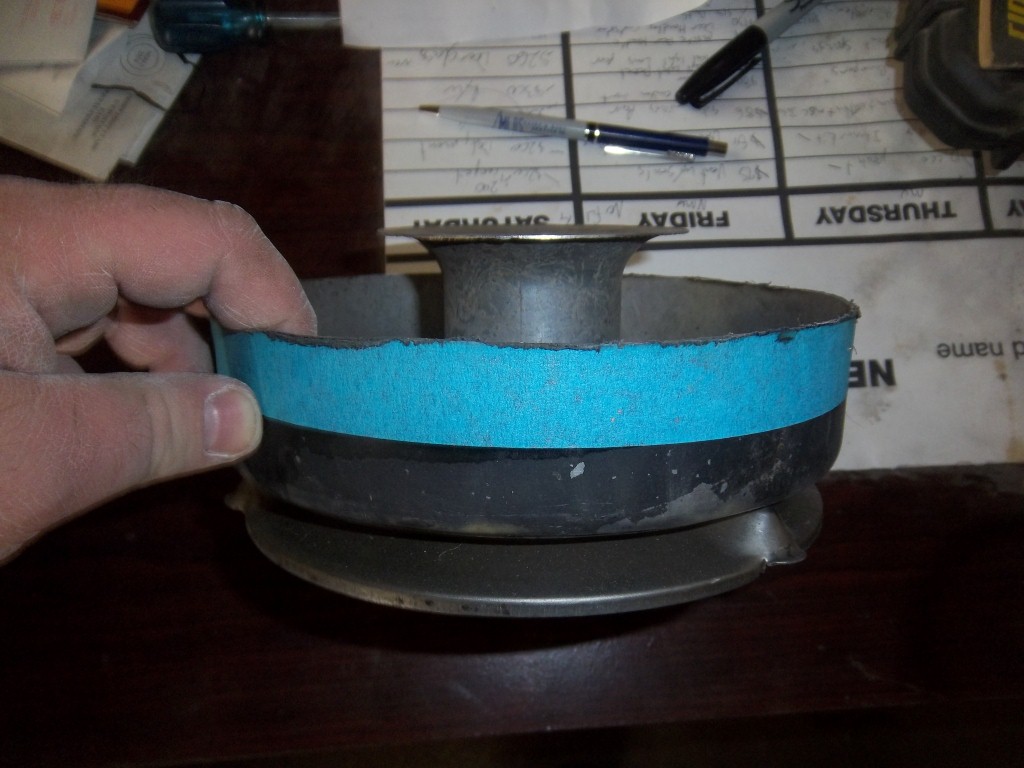

    I centered up the between the seem and the top of the flat section. Then measured out even spacing and used a green-lee punch to punch holes. I connected the hole and filed the opening true(true enough for an air cleaner). 100_3832.JPG
    I hand some perforated stainless left over from another project. I rolled it to fit the curve on the air cleaner and then welded them in. 100_3834.JPG
    I made an adapter out of a piece of exhaust tubing to mount the air cleaner to my 2g and clear everything with out having to beat in the bottom of the air cleaner. 100_3912.JPG 100_3913.JPG
    All done and powder coated. I had to make a plate for the inside of the filter body for the element to sit on. I used an element for a 70's slat six out of a 1/2 ton dodge. 100_3914.JPG 100_3915.JPG 100_3917.JPG
    I found a screw in pcv for a foreign car and turn a piece of aluminum to fit the road draft tube hole and cut grooves for two o-rings to seal it.
    I have had it running and have it tuned fairly well for no load but I think I might have to play with the carb a bit more when when get it in the car and under load. It only pulls 14 inches of vacuum at idle (550rpm) but bump it up close to 1000rpm and it pull 17-18 inches. I will try and figure out how to post a video or it running sound pretty good.
