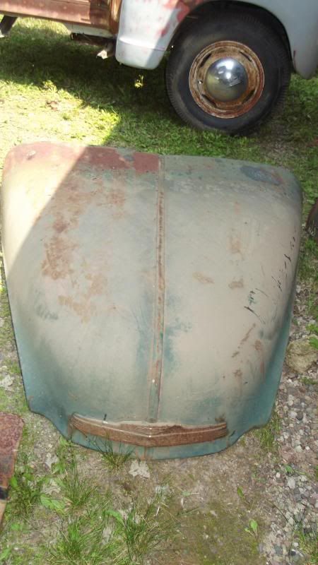

    I am keeping one of the chevy hoods, but will need to find someone who can swap me a gmc hood. Also keeping the gas tank, but will not be using it, will sell/trade to someone here if interested. And now I head off to work so I can have funds to build this thing!

    Anyone have a gmc hood they want to part with, or maybe trade for a good chevy hood? I will be making myself a list of parts needed over the next week so I can start looking at the iola old car show in Iola, WI. Any of you hambers gonna be there?

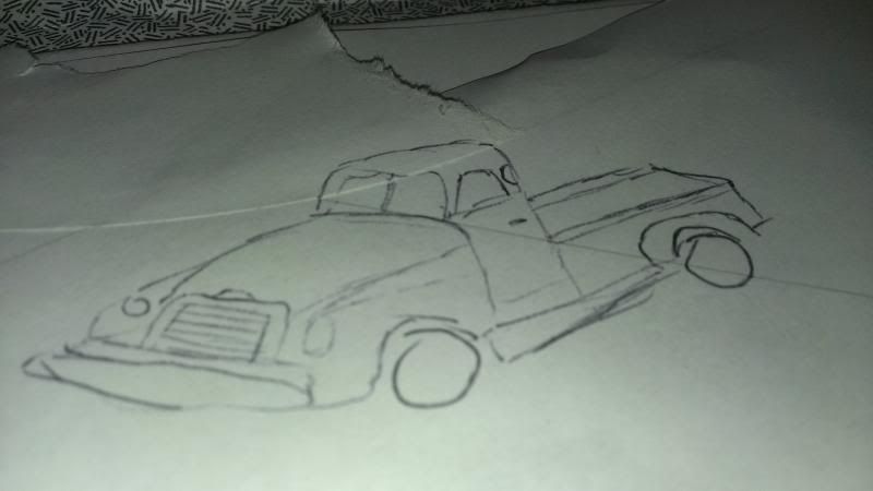

    The wife wanted to go to the store, so while I was waiting I picked up a pen and did a little doodle on an envelope that was on my desk... 30 seconds of work proves i'm no Chip Foose!
    But I figure I can copy it and try out color combos :)

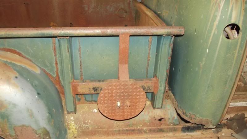

    Then with parts from both trucks I decided I had a complete seat:
    The back spring section is bent on the bottom, but I think I can handle fixing that, unless someone else needs a decent seat to fix up so I can get modern buckets :)

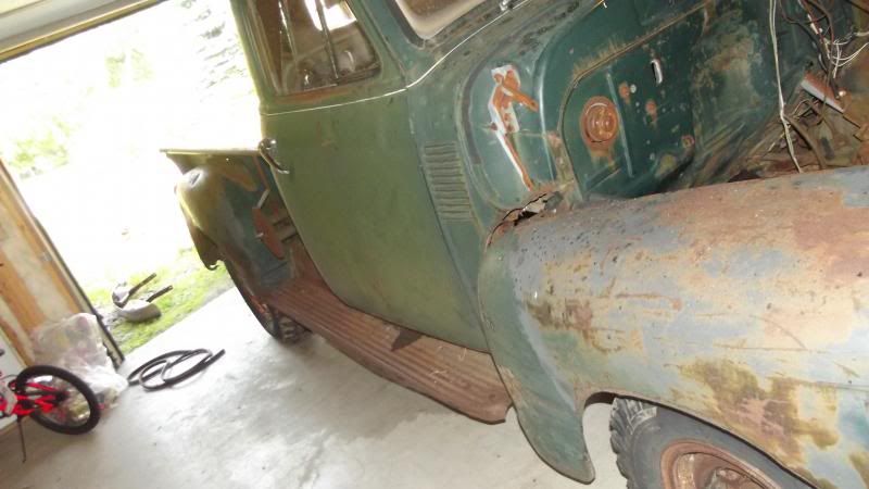

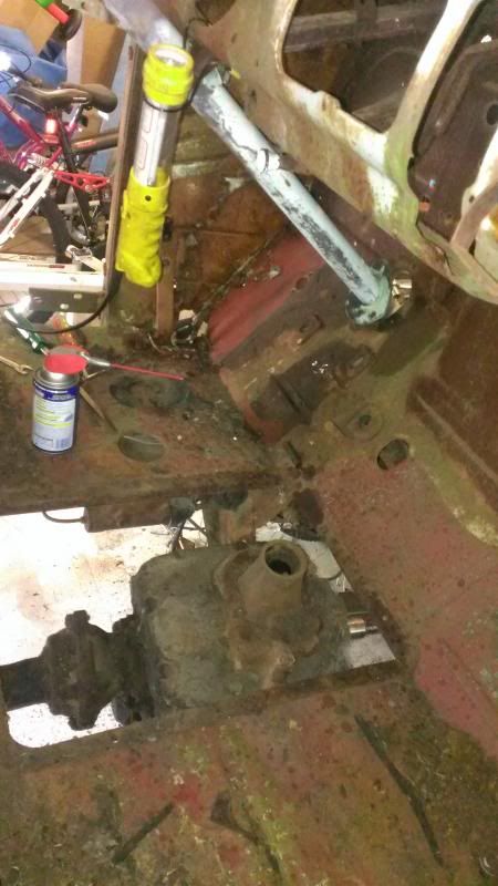

    I got the steering wheel off with a few blows to the backside... The bolt circle in the wheel was too narrow for my puller!
    I also found a little more work for myself when I was trying to locate the cab mounts. It seems someone welded a piece of sheet metal over the passenger side front mount! The nut came off the bottom in spite of that, so all is good for now!
    So can anyone tell me if the steering column comes off from the box at all? Or do I really have to lift the cab over the column? Anyhow, as soon as I figure out how to lift it, or get some help, it is ready to come over the column...

    Looks like you got the front fenders off?
    I was able to removing the steering box and column as an assembly after unbolting it from the frame and link with the front fender off.
    Then lifted the cab off later.
