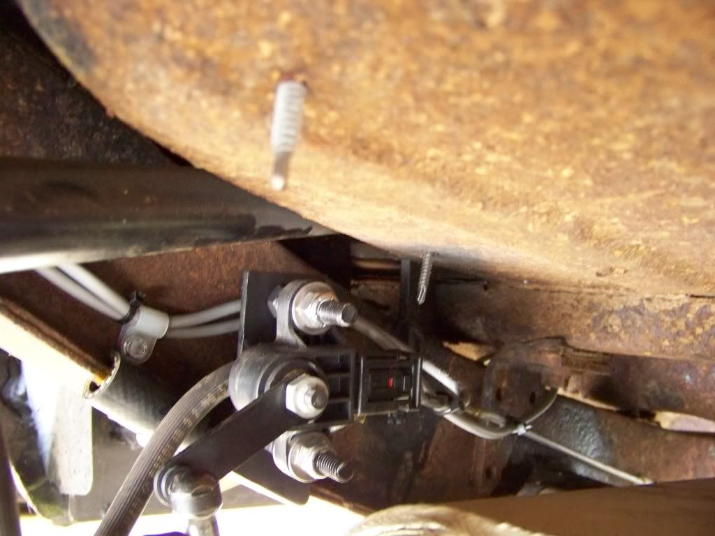

    Since our car already had air, the install was reasonably simple and straightforward. Our largest obstacle (as well as everyone else's that I've spoken with that has done one of these installs) was coming up with a mounting point for the sensors. The instructions call for the sensors to be mounted in a location that will allow the arm to have 2.75" of travel....We were having trouble finding a spot that would work. We did find a spot that was going to allow us just over 2" of travel so I called the guys at Accuair to see if I could run it like that. I was assured that they had tested the system succesfuly with as little as 1" of travel so we were golden!
    I think just about every single picture I took under the car looks like leftover dammit. Anyway, here's a shot of one of the sensors on the rear with a bracket we built to secure it. The sensors have "Ford" script on them as well as a part# so I guess in theory if one ever failed I could order it myself from any Ford dealer.
