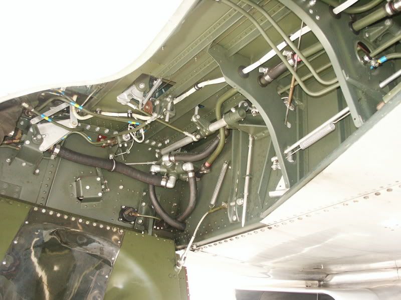

    P51 wheelwells....

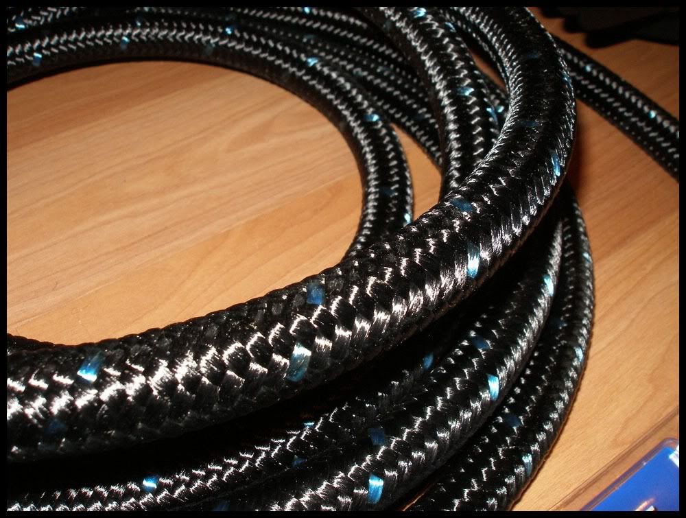

    Hoses get a little tricky. All of the companies do the traditional... er... standard braided stainless hose. There is a black cloth/nylon covered braided line that Aeroquip, Earl's, and Russell sell which is pretty cool. Its similar to what you see in the picture of Norwell's truck. I don't know the brand he used, but the lines I sell don't have the cool tracer in it like his does. Aeroquip 'Startlite' hose has a red single trace in it.
    The Russell and Earls hose appears shiny while the Aeroquip has a cloth appearance to it.
    Here is the Aeroquip
    and the Earls
    and the Russell
