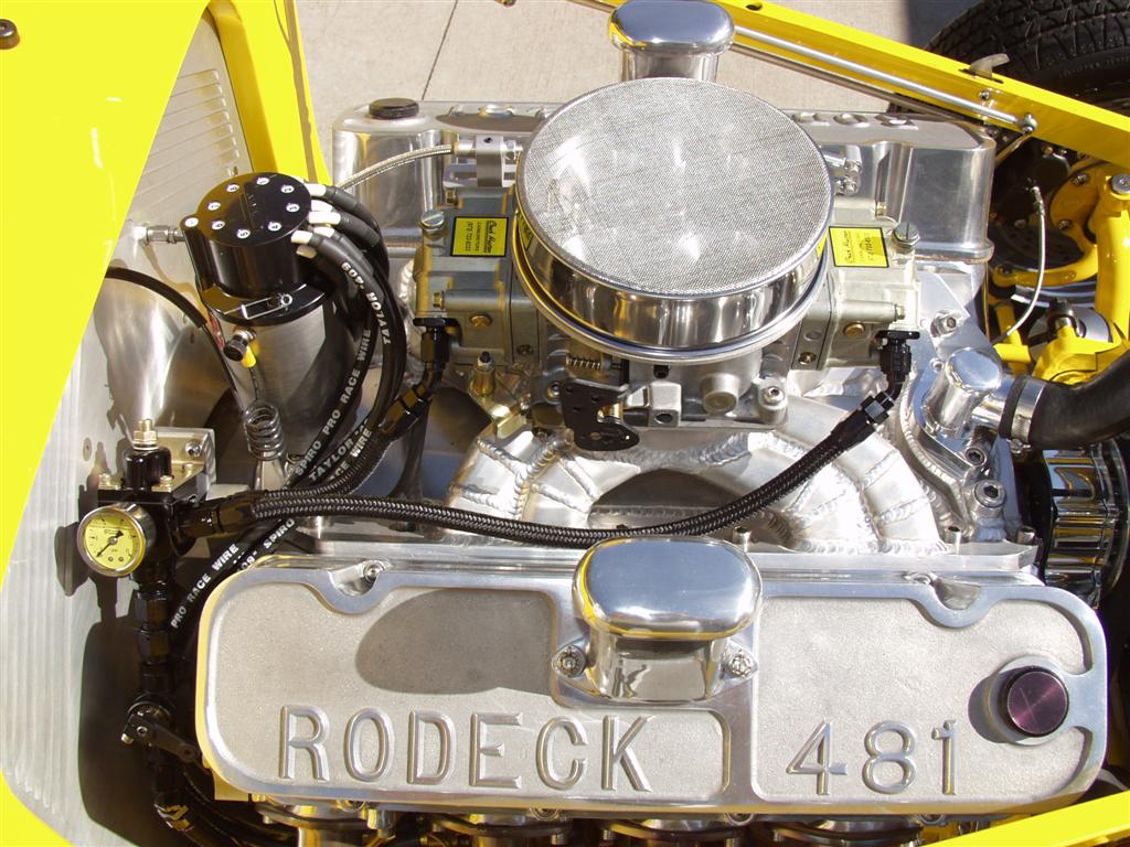

    We went with the Earl's ano-tuff all-black hard anodized fittings - they are a nice alternative to the red/blue...
