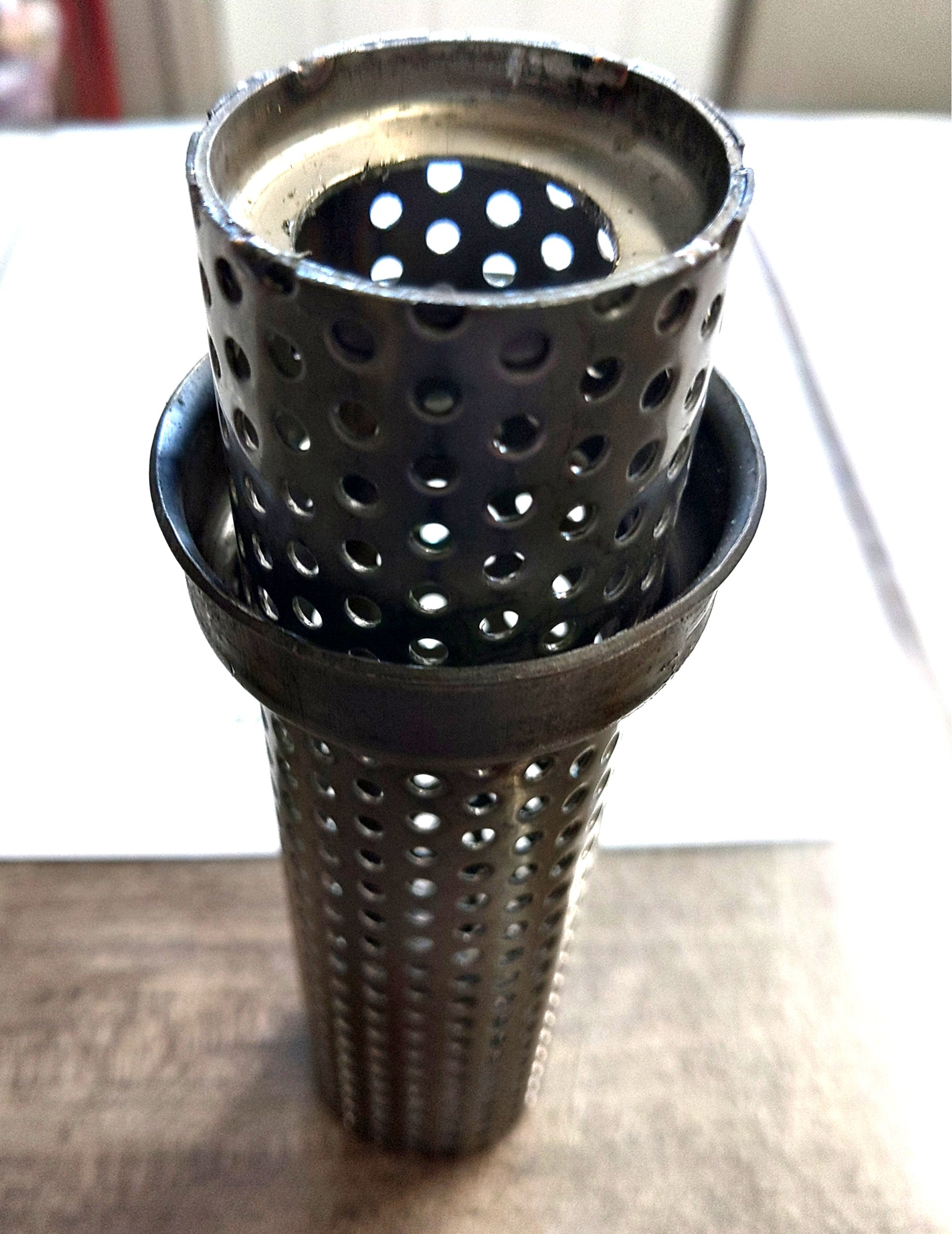

    I found these motorcycle baffles on Ebay. They can be ordered in different diameters to fit inside Lake Pipes. They even come with an installed collar, that we tack welded in, and slides flush into the pipe. They come closed on the ends, so I drilled them out for more flow. You can talk normally next to the '53 Buick with a SBC at idle, and it sounds like a full exhaust with glass packs KIMG0213.JPG KIMG0214.JPG PXL_20250518_001551609.jpg PXL_20250518_001605765.jpg PXL_20250518_001638934.jpg at full roar.

    from So Cal
    Did you wrap the baffles in fiberglass or pack steel wool around them before inserting them into the pipes?

    No. They just float inside the pipe.

    So they don't really reduce volume. I would try wrapping them or packing them to absorb higher frequencies, tone down the exhaust note. Some steel wool would probably be the easiest to find, but condensation in the exhaust will cause it to rust and then it will eventually blow out. Some fiberglass packing would be great. Or go traditional and get some metal shavings from a machine shop and pack that in there. The way those baffles work is the holes allow sound waves to exit out of the exhaust stream, high frequencies travel faster than lower frequencies, so they will exit through the holes, and if you add some packing it will trap those frequencies and lower the exhaust volume and mellow out the tone. Try it.

    If I was allowed to post a video you would hear it is muffled just enough. No packing. It's not an open exhaust sound at all. I hate to tell you you're wrong, but you are. Lol.

    Speedway makes these, and they have a straight section on the engine end. Plenty of room for these to slide in. I used a manual pipe expander inside, until it just slid in flush using the collar.

    https://www.carchemistry.com/3-disk-insert-2-3-4-diameter/
    I put these in my pipes about 6" behind my mufflers...like those you used there are numerous ways to install them wrapping, packing using different combinations of rings and caps...very tunable really...I opted for no wrap/packing and they still brought the decibels down to 90 from 110 which was pretty dramatic but its still loud and pushes 100 at speed with some of it due to wind whistling through the unsealed seams of my rolling brick...yours being a much later Custom is no doubt sealed and deadened but I get wanting the rumble as it's part of the ambience...

    Can you post a pic of the end, looking through them? I tried this and it was way too restrictive. The ones I bought reduced the inside diameter too much. The engine would lay down at full throttle. I can’t have that shit. I used stainless steel wool , made for muffler packing. Worked best for me.
