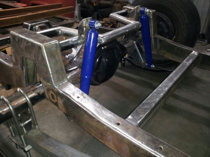

    Got shock studs from speedway, i welded them on the front and back of the plate. Got the uppers almost done. Ill do the lowers tomorrow. Also, im super **** about this, My frame is a tad over an 1/8" lower on one side in the rear. Its been like that since i bought it. Obviously these old frames flex some. Should i just stop worrying about fixing that ? Lol

  3. Buzznut
    Joined: May 9, 2008
    Posts: 2,349
    Buzznut
    Where are you attaching them below?
  4. Saxman
    Joined: Nov 28, 2009
    Posts: 3,556
    Saxman
    I would...stop worrying about it, I mean.
    Man, you are kicking some serious *** on this project! Looks like it's going together nicely.

    The axle is upside down in this pic but you get the point. 3/16 plate, the stud is welded front and back of the plate and the plates that mount to the axle are welded inside and out. Ill cap them off tomorrow. Seems wicked strong. They wrap around a good chunk of the tube, and they also straddle the axle tube and the center housing section. Also my battery door and floor piece came from flat top bob. Looks like stink but its actually nice

  7. Buzznut
    Joined: May 9, 2008
    Posts: 2,349
    Buzznut
    Looks stout. Do your shocks end up straight up and down or at an angle?

  9. Shane Spencer
    Joined: Oct 3, 2009
    Posts: 2,160
    Shane Spencer
    Haha thanks chad. And buzz, From the rear they are at about a 20 ish degree angle.

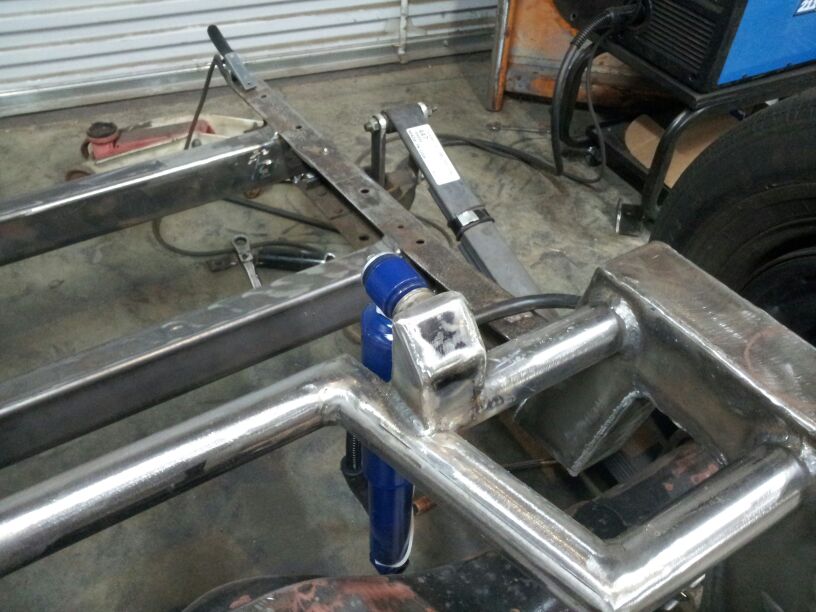

    Today was good. Got outta work early, knocked out the lower mounts. Layed down a few welds.... Finally gettin a grasp on it

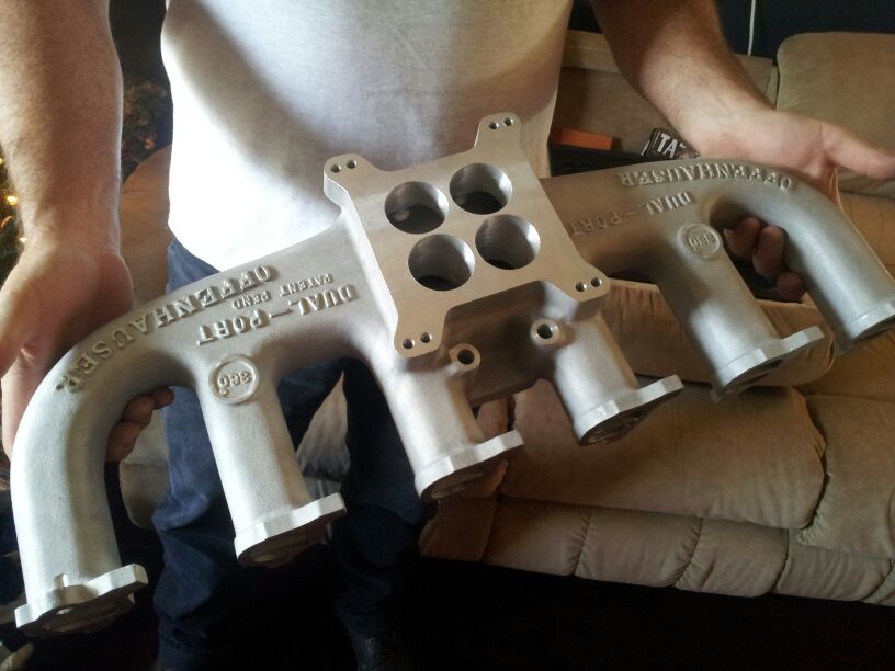

    My dad got some *****in parts for his 300 ford 6. Offy dual port and hedman headers
    Sent from my DROID device using the TJJ mobile app
  22. 1959apache
    Joined: Nov 22, 2009
    Posts: 2,635
    1959apache
    nice loot. my wife was trying to order those exact sun visors for me, looks like you got the last set ever made!!! lol

    I've heard the same about hot rod flatz, some find it great while others struggle to get it to lay properly. But it wasn't until after I ordered it that I found all the negative press about it. The main reasons I went with it was price and the color is damn near the same as the factory blue only with a metallic in it. I'm going to do a fake patina paint job on mine so some of the paint is going to get sanded off anyways.
    Oh and a question about your *****in welds. Did you just move in circles to get it so smooth? And what was your wire speed if you don't mind me asking. I am using a Lincoln gas mig but can't get my welds to look that purdy
