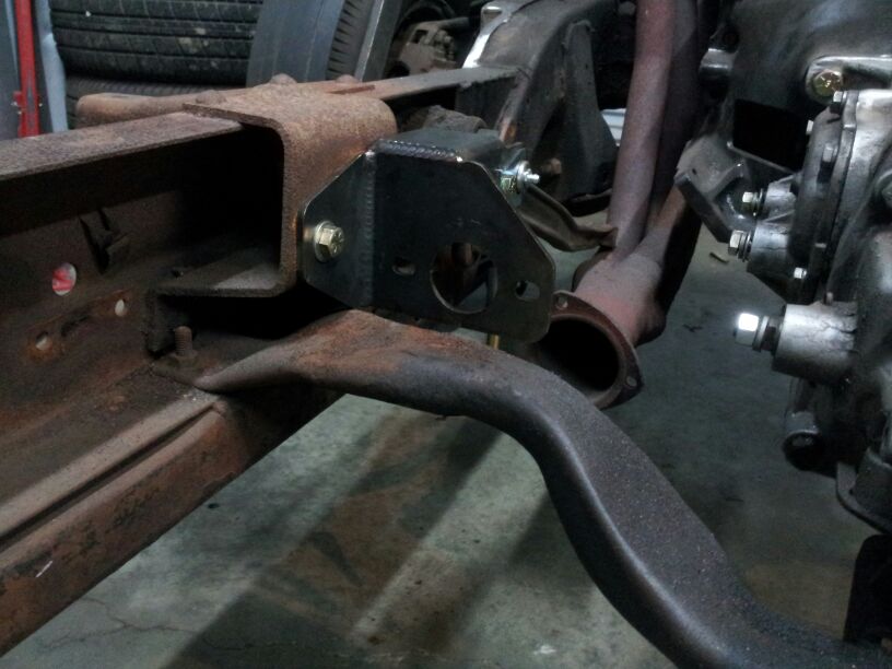

    Well i came down to throw in my new master cylinder........ Hits the trans crossmember. This actually isnt a bad thing per say, ive been looking for the slightest reason to ditch that ****ty stamped camaro unit. Ill fab a new tubular one tomorrow with the leftover tube n plate steel i have. Anyway, the new parts look nice :D

    No power boost? Just curious. I'm running stock but if I was to go this far I'd be feeling like adding power boost would be nice to have. I've seen them advertised for under cab mount but never been down that road.

    Na, no power. I had manual brakez in my 54 customline n it honestly didnt feel much different. Buzznut hooked me up with this brake setup. Its an old corvette style master setup for manual disc/drum. I like stuff super clean and simple. Power woulda been more expensive and more to worry about imho. Also unless i designed and fabbed my own brackets and system, NONE of the framerail mounted power brackets offered work with the stock mechanical clutch

    Looks good man, just like my set-up. I'll be interested in seeing what you come up with on that trans rear crossmember...I was think about buying or making one myself also.

    My brake setup is exactly the same. Works great with no booster, my subframe is earlier and has a slightly different crossmember and it does not hit the master at all. If you know someone with that type 69-70 you may be able to use it instead of making one. Its a stretch I know its not like they are all over.........just throwing it out there

    Well it snowed all day today so i just camped in the shop. Almost got the crossmember done and ran outta wire AGAIN!!! I need to start buyin bigger spools. Heres some pics, almost done. I couldnt figure out how to bolt it to the framerails because of the clip so i just welded the sides in solid and the center section is removable for trans removal. Ill get better pics tomorrow of everything. The removable center turned out killer. I need shorter bolts as well

    I dont know much of anything about vettes, i think the master cylinder everyone uses is very similar in construction to the vette types but they are setup to be run with disc/drum

    I have no way of knowing if that is true or even finding information to verify it. All I know is that this master cylinder is called a Corvette style and is available in either disc/drum or disc/disc....and it works for our trucks.

    You got some mad fabrication skills there Green - I like the crossmember a lot. Wish I had a better welder...I'd fab one up just like it.

    Thats a great idea for the drop out cross member...looks nice!

    Thanks everyone im trying to make some cool parts to the best of my ability. I may put another small gusset tube underneath the outer bars bridging from the camaro clip under the frame. Still undecided. I need to buy bigger spools cuz running out of wire is annoying lol

    Hey I could be wrong but I thought I heard somethig about peoples exhaust over heating brake likes, and brake fluid? If thats true are you concerned about the header collectors being that close to the master cylinder? I know everyone runs mastercylinders under the floor like this so maybe I'm wrong, I just wasn't sure?

    You are correct that it could happen, the pics are deceiving the angle of the shot makes it look a lot closer than it is. Mine are similar to his and have never had an issue, if you wanted you could use some exhaust wrap on the beginning section to give some ***urance.

    the pics are deceiving. as a reference point, the headers dump in front of where the trans case and tailhousing meet. its a good foot+ away from the master. im just running 2" pipe all the way back with gl***packs dumped before the rear. should have a nice cl***ic gl***pack sound

    The angle of the pic really does make it look like a bad set-up, but like everyone else here, I know from first hand that it's not that close.
    As far as wrapping the exhaust, I plan on doing that on both sides just below the collector and all the way back to the muffler. I figure it will help due to my battery location (inside the frame rail opposite the m/c) and will also help keep under-cab heat to a minimum.
