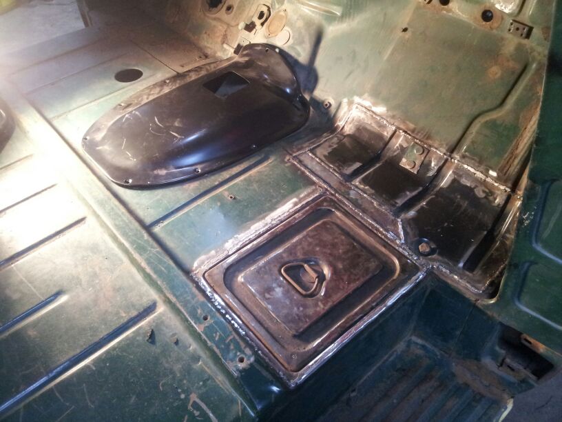

    Got the cab on tonight. Ill post pics soon. Gotta do the floor patch, battery door, column n other sheetmetal work
    Sent from my DROID device using the TJJ mobile app
  11. Shane Spencer
    Joined: Oct 3, 2009
    Posts: 2,160
    Shane Spencer
    Alright heres a few pics. i need to mock up the bed and front end eventually to see how much the front needs to come down. I finally got to sit in my truck for the first time in a LONG time tonight, felt good. I had to cut a hole in the floor for the driveshaft notch. Im gonna shave the driprail as well. The battery tucks in nicely, toeboards need patches, dash needs some m***aging, column, battery door and a frenched antenna are also in the plans very soon. As well as door bottoms and a lower fender patch

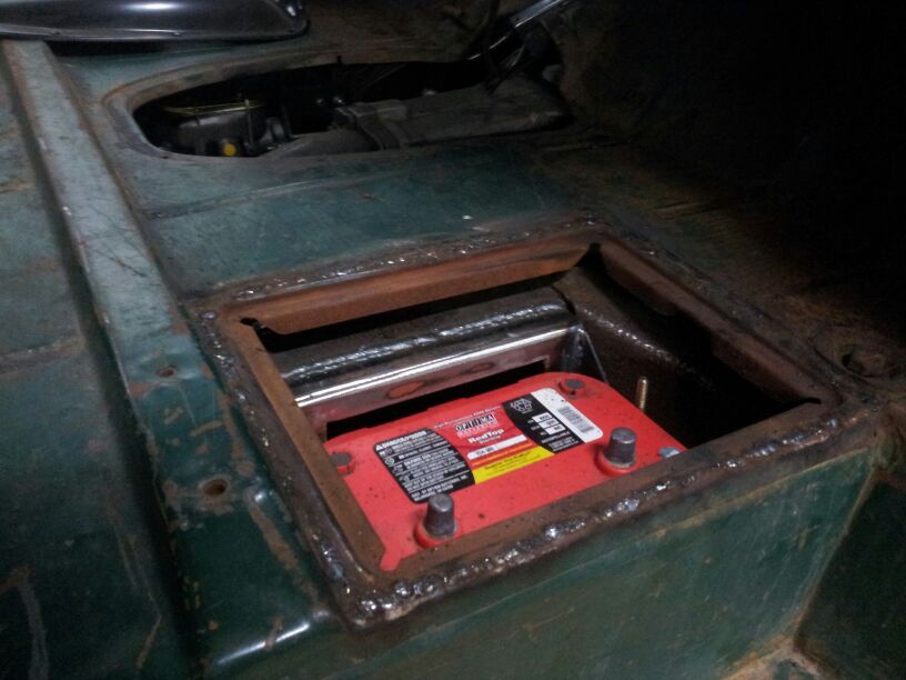

    Thanks guys, i knocked the battery door out. And took the old floor section from the battery door and made a bump to cover the notch hole and still have the factory lookin floor ribs..... the *** draggin stance is growin on me .......
  20. sqrlnts
    Joined: Apr 2, 2007
    Posts: 314
    sqrlnts
    Very nice progress, love the battery door! If I can find a lid like that I am stealing the idea, just saying!!!
  21. MEDDLER1
    Joined: Jun 1, 2006
    Posts: 1,590
    MEDDLER1
    REALLY DIGGIN That battery set up. Mine currently sits behind my seat and I hate it. I may just steal this idea lol.

    Thanks guys, i gotta throw another shoutout to flat top bob for the battery door and flange. Killer part and service

    Knocked out the toeboard patch tonight and finished the bump in the floor for the driveshaft notch. These little harbor freight welding clamps are awesome especially for 5 dollars

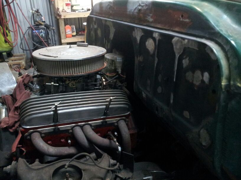

    Joined: May 9, 2008
    Posts: 2,349
    Buzznut
    I'm using the Mallory Unilite and I have at least 3 inches if not more. Even with the old Accel dual point I had at least 1 1/2 inches. I'm sure the measurement will be slightly different on trucks clipped with the Camaro front end or something similar, but with the transmission bellhousing sitting on the stock mount locations, you'll have room...unless it's a HUGE HEI.
    BTW: did any of you know that, even though they don't list themselves as having them, Energy Suspension has poly bellhousing (front ******) mounts that are 1000% better than the ****py reproduction rubber ones you're going to find anywhere else? I have the part number if anyone is interested. They're around $55 for the pair.
  28. dubie
    Joined: Aug 17, 2004
    Posts: 698
    dubie
    I'm using the bigger HEI distributor on mine. I've always run them because they're easy to find at the local wrecker for not a lot of money and they just work for me
  29. Shane Spencer
    Joined: Oct 3, 2009
    Posts: 2,160
    Shane Spencer
    From what ive read the hei works great, and if i was keeping the 4 barrell and had a larger air cleaner to hide it i might keep it. But with the 3x2 i just want a smaller, cleaner lookin distributor. I also wanna make spark plug tubes to conceal the wires and i need to make some low mount alternator and p/s brackets
  30. Buzznut
    Joined: May 9, 2008
    Posts: 2,349
    Buzznut
    You're honestly going to have to test fit the HEI. I've seen where they absolutely won't fit and where they will. One of the issue with these trucks is that very few of them came with V8's, so when they are upgraded years later, the engine ends up in a few different locations. My buddy has a '57 and his 350 sits about 1 inch more forward than mine does. You may or may not end up being able to run the HEI...you'll only know once you get everything mounted.
