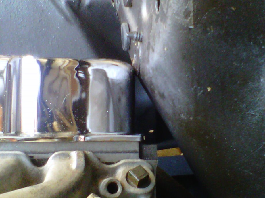

    Either way the hei will be gone off my engine. Ill probably run a small billit msd. Not traditional at all, but ive never seen one fail, ever. and if i run a black cap it wont be noticable anyway

    The Mallory Unilite is a billet deal...I painted the cap black to help it blend in.

    Yea i was lookin at mallory too, we will see when i get there. I just measure, i have 2 1/2 inches from firewall to distributor with the hei. Also heres a pic of the finished floor bump

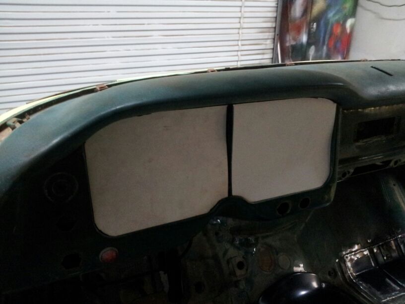

    My buddy came down and was using the power and air tools on his car today so i just did some busy work in between helping him. Knocked out templates for gauge panels, ill be making engine turned aluminum panels for the gauges. Also fixed some dents in the dash. There was a gnarly dent under the ashtray, the pic doesnt show how bad it really was but its all squared away now

    Another option is an original small cap delco with points. That's what I got on my car, with an MSD 6AL. It's rock solid, & I had it curved to my setup. It also has a B28 vac can for my low idle vac. My car has never been so responsive. If this sounds like something your interested in, I can give you the name of the guy who built it for me in Denver.

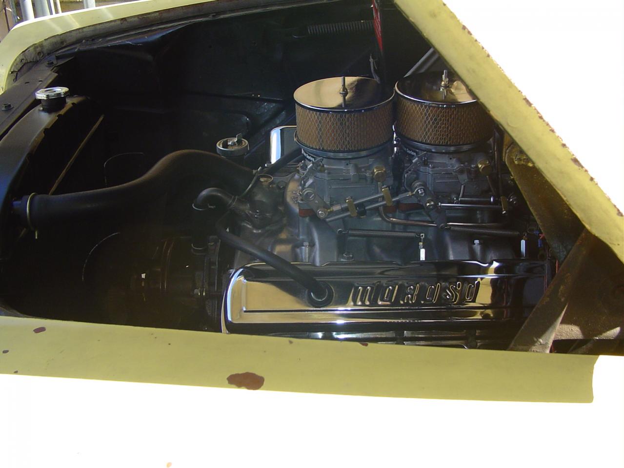

    Yep. I'm pulling out my 455 Olds (which I had as far back & low as possible) - see pic.
    It's getting a built 355 now...

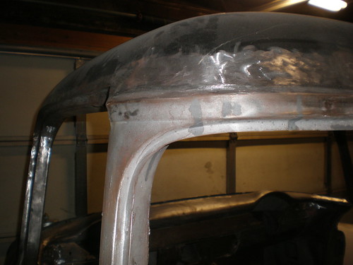

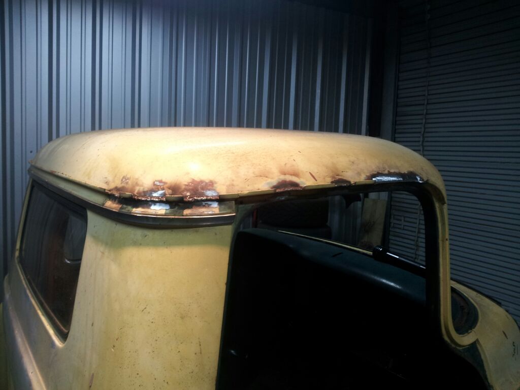

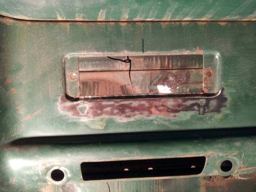

    I started on the driprail tonight. Still working on my sheetmetal welding......
    Sent from my DROID device using the TJJ mobile app
  28. BAM55
    Joined: Nov 2, 2012
    Posts: 26
    BAM55
    Thanks for the invite and of course I will take you up on it. I love to look at peoples build threads also. Plus its always nice meeting fellow rodders, customizer, and builders. I like a lot of the HAMB builds because I like all styles.
    If I can be of help in any way please feel free to ask because I believe knowledge not shared is knowledge wasted. I learned from others so I try to past what little I know along. That's what its all about in my opinion.
    You are doing a good job on the drip rails shaving. Removing a little at a time and welding it up is the way to go because the drip rail is what ties the roof to the cab. Also when you do the back you may have a hump where the drip rail use to be (well a least mines did). So what I did was save the back for last and welded up both sides. When I removed the drip rail at the rear I noticed from the side I could see a hump and I did not like it. So this is what I did cut out about an inch of metal out along the back and made a patch so that it would lay flat. After going to shows I would notice some people left the hump and it looks cool but I like the way mine flows a little better. Its a personal choice.
    Just remember when welding sheetmetal take your time and keep that metal cool and you will be fine.
    Once again great job you are doing on the truck.

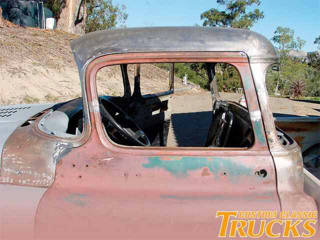

  29. matthew mcglothin
    Joined: Mar 3, 2007
    Posts: 970
    matthew mcglothin
  30. Shane Spencer
    Joined: Oct 3, 2009
    Posts: 2,160
    Shane Spencer
    Killer pics man, i read an article in custom cl***ic trucks or one of those similar magazines and the guy just made relief cuts to bring the roof in or out and have a smooth profile. Either way would work well, also ive read a few other threads where guys didnt have to do anything. As we all know, these old vehicles are FAR from precision perfect from the factory lol. We will see when i get to the back
