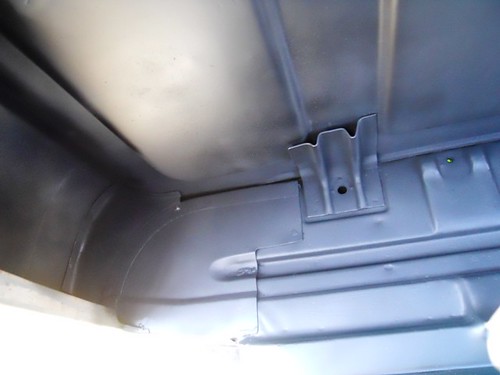

    Lmao nice finds for the wallet!!! I need to make the floor extension next to cover the hole. I may spray it with liner as well, sounds like a good idea. That design just seems so dumb in stock form, its pretty much designed to create rust lmao.

    I also cut the inner cab corners short when I replaced mine. Its nothing more than a moister trap in my opinion. I did this to the inside and like Joe P*** I will be seam sealing and than undercoating the interior as well.

    Lmao theres always something you forget to modify untill the last second. Happens to all of us ! And i agree man, the corner pocket has to be one of the stupidest factory designs ever. Pretty much made to trap crud and moisture and cause rust issues as fast as possible lmao

    Same story on the other side..... Pocket full of ****. Almost got it finished. Not quite tho. Idk if ill get much done this weekend. Whole state and city is hyped for football, and i refuse to miss out on that action. Few pics ......

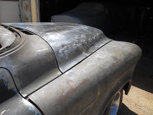

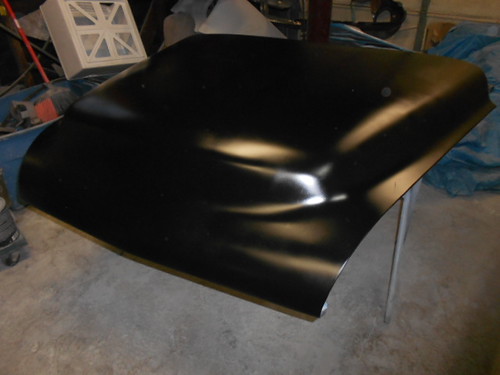

    That is good. This is what I do when mig welding a panel. I get the panel to fit as perfect as possible and I tack it in place about every 2 ot 3 inches and grind those welds. Than I tack a in between those tacks and grind those welds and start my light hammer and dolly work if I have access to the rear. This work between welding is allowing the welds to cool as I continue to work. So I would grind previous tacks so that I'm doing something while the newer tacks are cooling. I do this until I complete the patch. That way I'm almost done with the metal finishing. I hope that makes sense.
    This is the pancaked hood inside and out. Huge welding area but doing the hammer and dolly work paid dividends very little filler was needed.
    This is it with black epoxy primer.

    You don't run a bead on sheetmetal you tack weld and move around alot to keep the metal cool. What I do is tack the piece in and grind my welds use my hammer and dolly, tack some more, grind, hammer and dolly until the patch is completely welded in. This allows the metal to cool and I'm also continuously working.
    Oh yeah when your hammer on dolly to stretch the metal, hammer only the HAZ (heat affected zone). The haz is the area where the metal changed colors from the heat. If there is warping from welding getting rid of that warping is all in the HAZ even though the warpage may be outside of the HAZ it could even be on the other side of the panel. Stretch the HAZ and the warpage will disappear.

    I don't know how many times I've had to put my hand down into that hole to retrieve things :eek:
    Sometimes it was like this...
    http://www.youtube.com/watch?feature=player_detailpage&v=g36lYOdlZ-k#t=13s
    Did you add a drain hole?

    I did not put a drain hole but of course that would work if you chose to do so.

    Also as far as a drain hole both of my patches from brothers came with a hole drilled already, but i dont think its that necesarry with the inner cab corner cut out. Theres nothing to really hold water there without the inner
