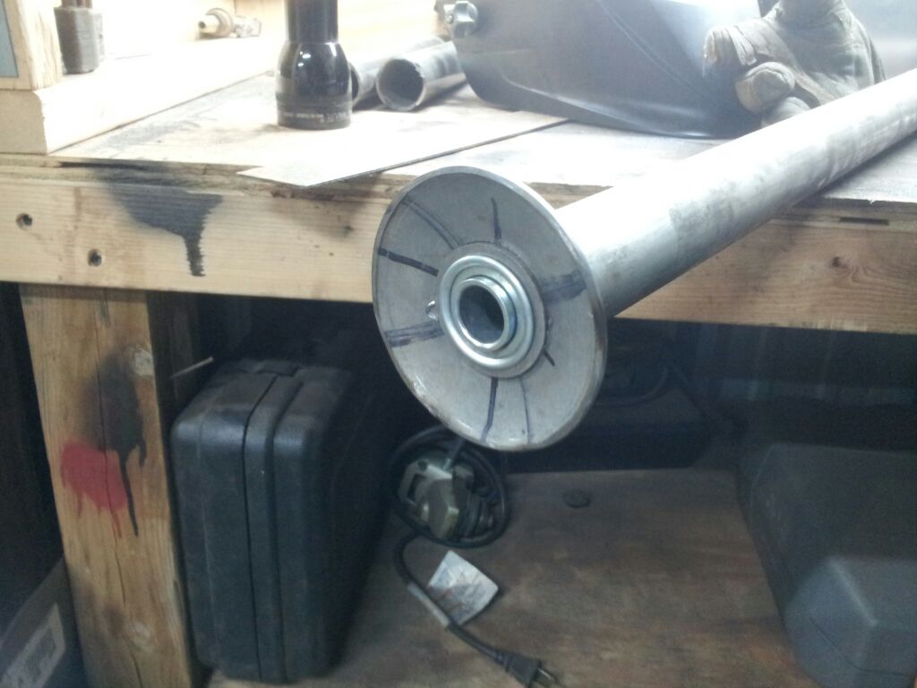

    i've been checking your build pretty regularly, nice work you have a skill for this! I'm buildn a 55 3100 right now and just did my colunm easy peasy, find the length you need cut your outer tube off leaving aprox 1.5" outside the firewall. Now get your self a 6203-3/4-2RS bearing fits perfect, about 7/8" from the bottom of the tube make 2 small cuts 180 from each other tap the top side above the slit in a little with a punch this will stop the bearing from sliding up the tube. Now you can simply crimp the bottom of the tube and the bearing is stayin put. to hold the shaft i compressed the spring topside of the column marked the shaft at the bearing slid it out and cut a grove for a snap ring worked great and took about an hour.

    Thanks guys, chad column pics finally !!!!! Well a start at least. I didnt have time to get welding gas today since.i was at the super bowl party at the stadium. I did get the driver side floor patch ready to weld in tomorrow. And you can see how the upper half of the column will go together. I caught hell finding pipe caps so i just cut down a larger one, hole saw in the center and that slips over the outer column tube. The steering shaft rides in the bearing on either end. Btw the steering shaft is from borgeson for a 55-57 chevy car. It comes with the lower end splined and the upper is the universal gm spline count for there steering wheels, i just needed to pick up a nut to bolt the wheel on. I am also going to use this weldable collar to make my upper mount, something similar to the last pic. Ill weld it all up and show you the lower end of the column tomorrow
