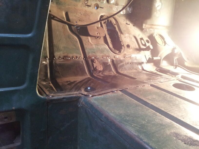

    Well i got the floor patch tacked in, got the column tube cut. Drilled the hole for the set screw and started to tap it with threads. Broke the ****in tap. I have no ****ing clue how im gettin this out. Im done for the day

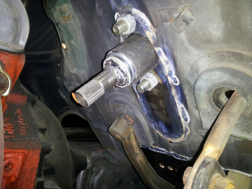

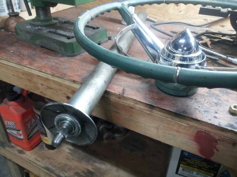

    Ok so ive decide that the set screw idea is just not gonna work and seems kinda weak. theres a hairline crack in the shaft from me trying to beat the tap out. What im going to do is order a new shaft, and then weld a thick washer around the steering shaft where the set screw would be. The shaft will slide up through the bottom of the column untill the washer hits the lower bearing with an o ring between the two. then the wheel will just bolt up top against the top bearing, if that makes sense

    Just weld that shaft up!! No need to order another! But a 67-72 column would've been quicker! ;)

    Try welding a bolt to the tap and then unthread it. Or like Chaddilac said, weld it up and keep moving forward! Truck is looking good!!!

    Thanks guys, and the hairline crack just turned out to be a scratch anyways so its all good. I tried welding bolts, nuts and other **** to get it out. Tried drilling it too. Im just gonna fill it with weld and move forward

    If you have a torch its no big deal to blow that tap outa the hole.

    Well i got the column knocked out except for the mounts. Ill do that soon. Under the welded washer is a rubber oring sandwiched to the bearing face. Everythings nice and snug and it spins effortlessly

    hey man its looking good! I am digging the column, its looking nice

    So today i welded up the driver side floor patch completely, did a little grinding on the p***enger rocker and hinge pocket. They still need a bit more work but its close. I then filled the stock column hole in the floorboard and made progress on the lower mount. Everything is pretty much just tacked for now. Steering linkage looks like itll work great and i just sat a door in there for the pic so the gaps are wayyy off
