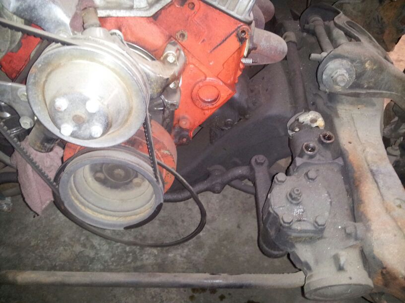

    Theres no way im keepin that bracket. Mainly because it hides the entire side of the engine. One company makes a mid block mount that sits the alt down way lower. I may do that

    N847 i was lookin at that first bracket for a while but id rather mount it lower down. The second bracket is a great solution but id have to move the power steering. I have seen one low mount alt bracket for the p*** side but i cant run a mech fuel pump with that. i may just run manual steering. I had it in my 54 ford

    Exactly why i may go manual. I hateeeee dealing with fluids, power steering, brake, coolant etc. and ive had bad experiences with power steering pumps going up in short time. Theres a manual box thats a direct bolt in for my camaro clip. Im strongly leaning in that direction. Plus itll free a wee bit of power up from the mill

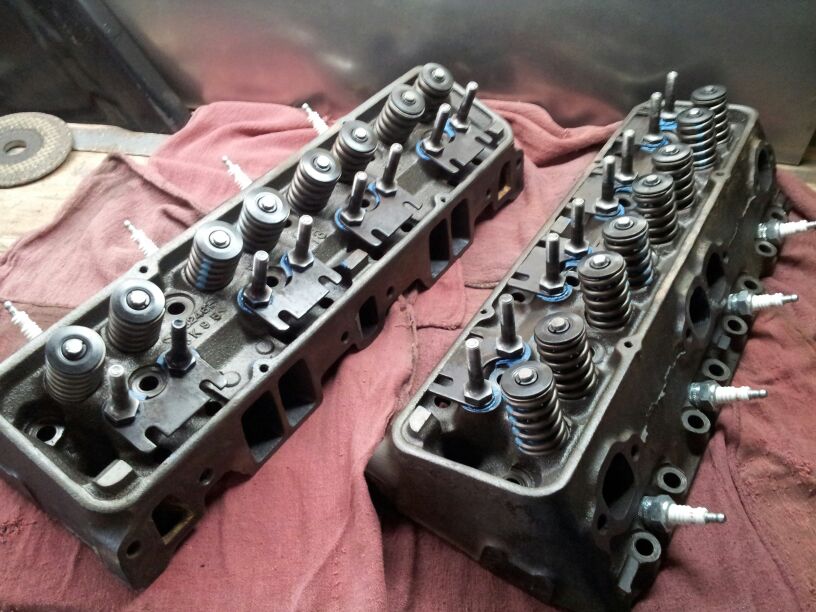

  7. Shane Spencer
    Joined: Oct 3, 2009
    Posts: 2,160
    Shane Spencer
    Picked up some 2.02 double humps with screw in studs and upgraded springs off craigslist. I was hoping to trade my 4 bolt main block for a set from a friend but it didnt work out. They are fresh with 0 miles since the rebuild
    Sent from my DROID device using the TJJ mobile app

  10. chaddilac
    Joined: Mar 21, 2006
    Posts: 14,084
    chaddilac
    Dig them double humpers!!! :D
  11. n847
    Joined: Apr 22, 2010
    Posts: 2,724
    n847
    Sounds like a nice set of "humps"...

    The clip is an 81, i surfed around google and apparently a manual 85 - 89 s10 box will bolt right up. So im pretty positive im goin that route. Anyone know if one of the low mount alt brackets from speedway or whatever will clear in a camaro clip ?

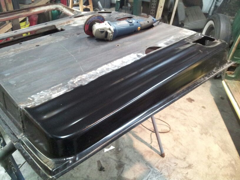

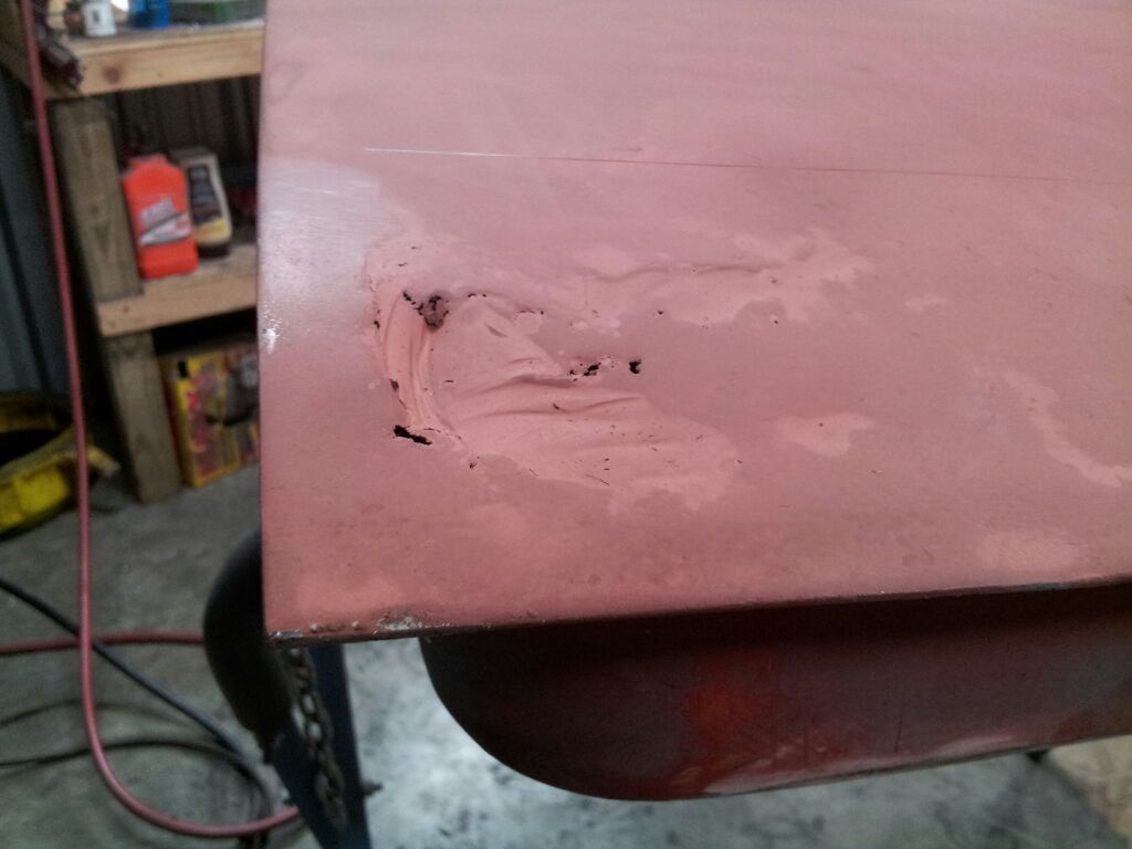

    I started on the driver side door. Got the inner tacked in, trim holes filled. I still need to fill the mirror holes. Anyone know the easiest way to remove the bolt pocket and re weld it into the new inner ? I used my trusty harbor freight clamps ( probably the only thing they have worth a **** ) to line it up. Check out the butchered speaker holes someone cut.....

    Got the inner finish welded for the most part... Gotta fix the botched speaker holes still

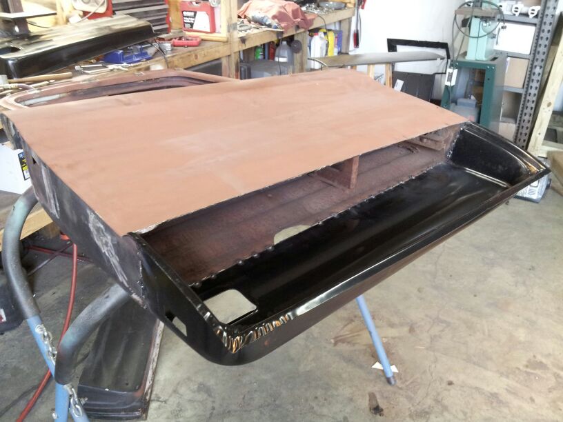

    Im kinda pissed, the patch fits like ****. I had to manipulate it for like 45 minutes before i could even weld it. It still fits like hell. The front edge profile is absolutely terrible. The back is seamless tho. The front is gonna need hours more work. Anyways i yanked the power steering. Idk if a low mount alt bracket will work or not. I may have to fab something. Steering is really close.....

    Not telling you how to build your truck because you obviously know what your doing.....but I didn't wait until the door was done to throw it back on the truck to test fit them.....would hate to see you or anybody have to rip things apart....doors are a *****

    agreed. Test fit it.. I had a problem with those lower door patches, they are junk sometimes. I would toss it on there to be safe. I would hate to see you waste money and more time on something stupid like that.

    I only have the inner on right now. The back side of the door is perfect, the front edge profile just needs to be reworked to match the door. Its a pain in the *** but nothing to cut the patch off for. Do you guys have any tips to re use the stock hinge receivers or just buy aftermarket ? Looks like a ***** to remove the stockers, but chuck you said you had issues with the aftermarket ?

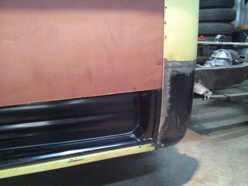

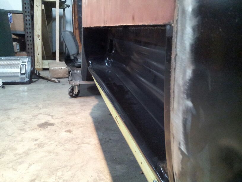

    Yeah i know, taxes just came in so maybeee......... A new set of doors would be sweet. Heres the issue. The door is just sitting there in the pics but i tried to hold it up so you can see whats goin on. The back as you can see is damn close. Few minutes with a dolly and it should work out. The front however as you can see bows out about halfway up the door and the profile itself is just way off. Im thinking multiple pie cuts to fix it but then i have to deal with the damn receiver too. The rest of the patch is lined up perfect just that front edge is screwed...... And this is the easy door. The other is an absolute WRECK. So idk man this is frustrating
