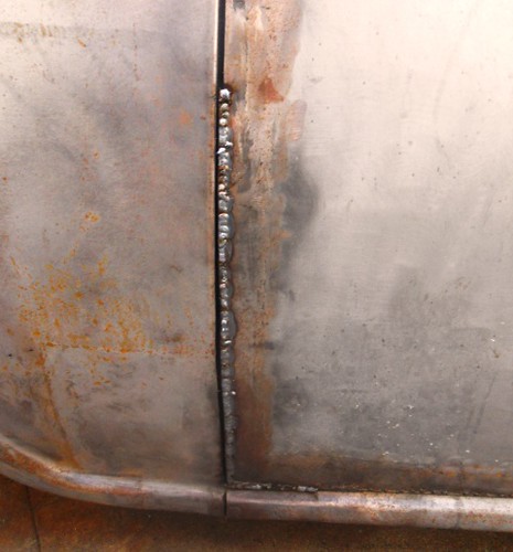

    Bam, you have any pointers for the lower door patches ? Im catchin hell man, probly gonna grab different doors

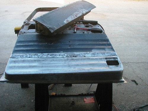

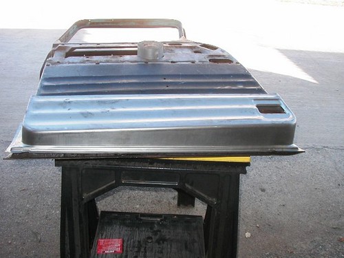

    Well this is how I did mine. I picked a place of reference in two spots and measured to the bottom of the door. Then I wrote that measurement down on the door. The I laid the patch over the the door like to have the hinge hold match up and made a temporary cut line. Like so
    Then I cut the measurements of the cut line on the old door to the measures of the patch and held my breathe and make the cut and tack the patch in place then measure from the reference point I spoke of earlier and all looked good.
    I installed the outter skin and took it to the truck to check things out.
    All looked good at this point but wait a min no fenders.lol
    I had a gap when I installed the front clip on. So I shimmed everything the best I could and fit the doors the best I could and added metal to make everything fit nice.
    I say to fit the doors the best you can and deal with the aftermath the best you can. You can not expect a perfect fit on trucks that were seen as farm and work trucks when Chevy built them. GM had no ideal we would still want these old truck today. They had no idea how cool they are.lol

    Thats pretty much how i did mine. Everything fits great but the patch just kicks out towards the front of the door. You can see it in the stamping. Inside of the door fits great. Just the frontside profile is way off. I may try to make multiple cuts and bring the profile back in to line. Idk how well thatll work tho. Btw bam those door gaps look incredibly good
