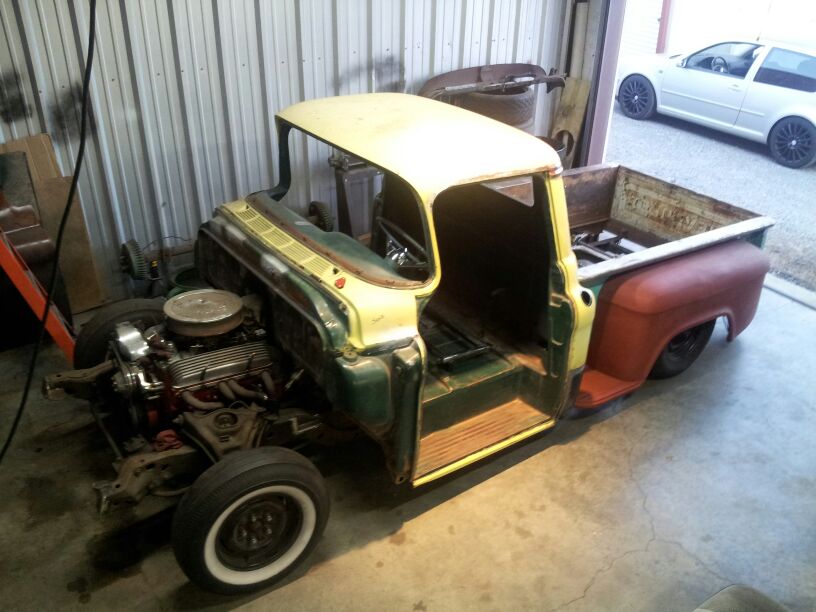

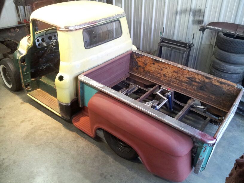

  20. Shane Spencer
    Joined: Oct 3, 2009
    Posts: 2,160
    Shane Spencer
    Couple shots from up high, my vw is parked outside in one shot. Its dropped on coils. The truck only sits an inch lower right now even tho it looks wayy lower
    Sent from my DROID device using the TJJ mobile app
