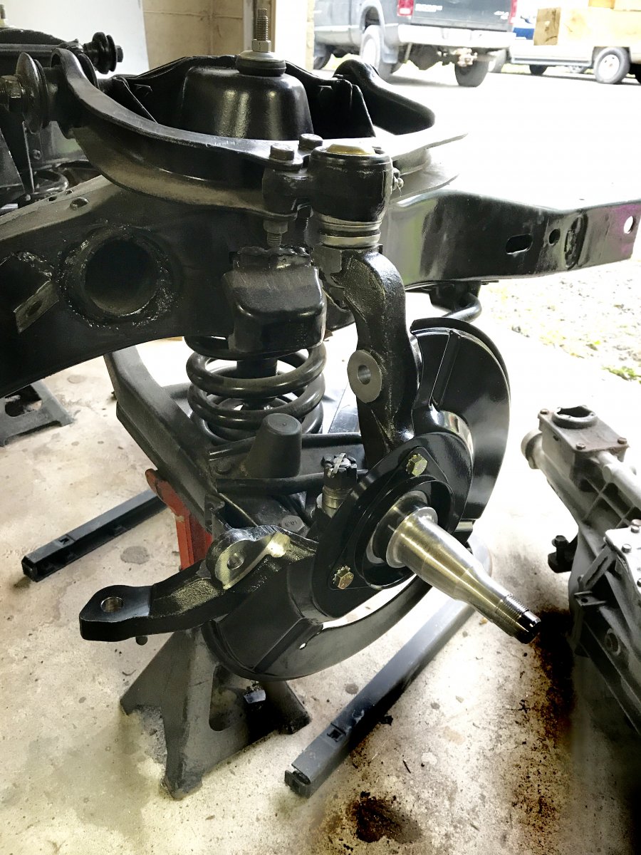

  4. grower54
    Joined: Dec 11, 2016
    Posts: 95
    grower54
    initially i tried to use the existing '54 spindles and mate the '94 mustang discs. Squablow mentioned a potential fitment issue with the backspacing with the newer style callipers. Bang on, brother. The whole thing turned into a giant PITA. So, as much as it pains me I broke out the wallet.
    Granada style drop spindles with callipers, master, and booster. Nice kit. I hate admitting defeat, but this is really the way the way to go!

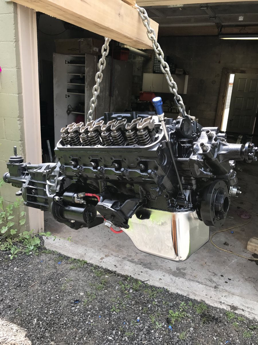

  10. grower54
    Posts: 95
    grower54
    cleaned up, painted, and ready to drop back in and get bolted down. IMG_3556.JPG
