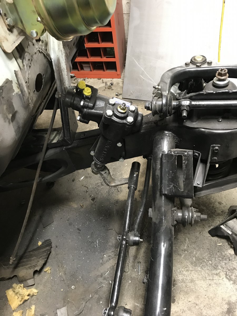

    should have just done this in the first place. Borgeson box works perfectly. Costly mistake. Oh well, thats hotrodding! IMG_3667.JPG

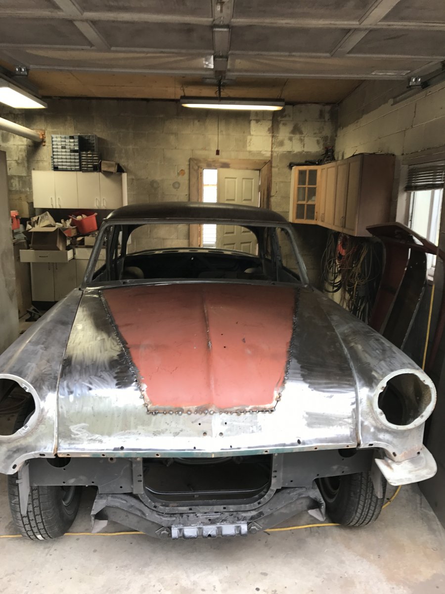

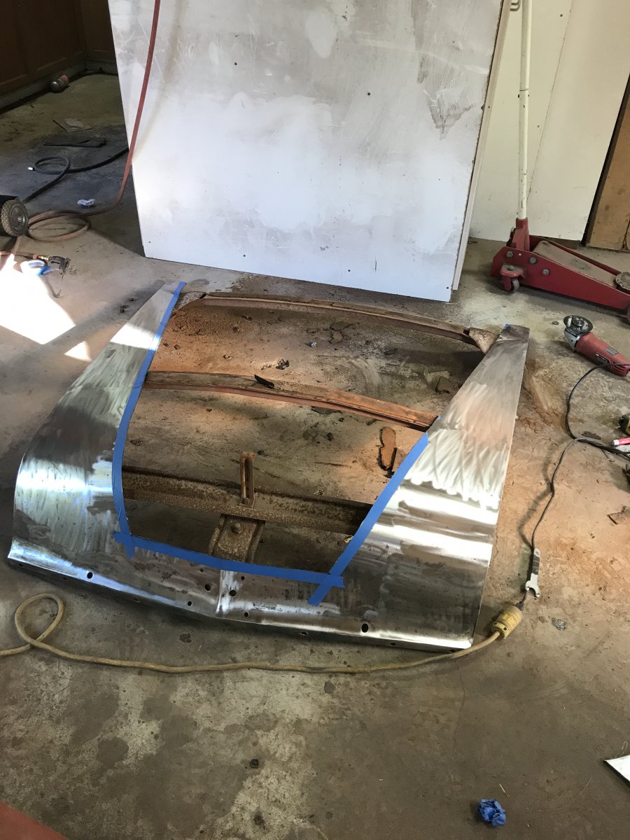

    never did like the mercury hood scoop/bump. cut the centre section of a '54 Lincoln hood out and grafted it into the Merc hood. IMG_3702.JPG

    Did you get the whole kit ? I have a rack someone fabbed onto my 54 and it's just not right. I wanted to do the borgeson box too but didn't think it would work since I have a 302 in mine but I'm still looking for options
  6. grower54
    Joined: Dec 11, 2016
    Posts: 95
    grower54
    the box has the proper bracket to bolt right to the existing holes in the frame. I bought a non power steering centre link off e-bay. The factory 5.0L headers that i have on there right now needed to be bashed in pretty good to clear the box, but Headman has a header that will fit. They are on my list of things......
    Do the box conversion. So much more solid.

    What's the difference with the center link ? I don't have one but my main problem is that my oil pan is behind the cross member I don't know if I'll have room or not. I don't know what to do

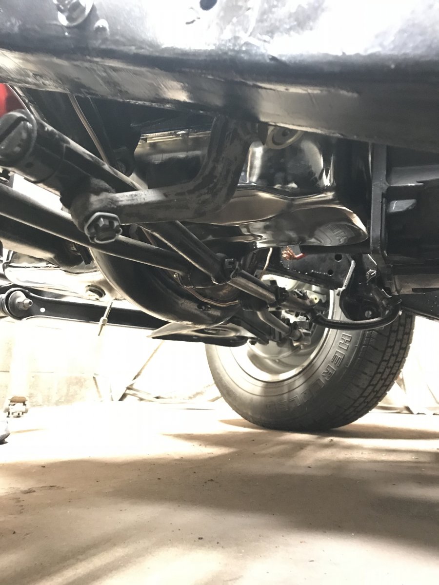

    how did you mount a 302 with a rear sump in the same place as your rear steer rack and pinion? the centre link should go where the rack is. IMG_3734.JPG

    Like I said it is a mess steering set up wise , the rack is mounted to the bottom of the cross member so it hangs down and tie rods are at a bad angle so I need to figure out how to go back to somewhat stock

    Knghtcadi, in order to get my 5.0L to fit, I bought a package from Jegs that had the proper front sump oil pan and pickup and a timing cover with the corrected dipstick location. You may need a different water pump as well. To use a steering box you will need the idler arm and mounting bracket on the p***enger side frame rail, the manual centre link, inner and outer tie rods and a pitman arm. Might be a bit of an expensive job if you need everything.

    Yeah it probably will be a bit costly but I still need it no matter what , the car has no turning radius and it needs a new rack anyway so it's just better to convert it. Plus I can't lower it anymore with this setup , I have the Aerostar springs in it but it needs to be lower so I'll just start collecting the parts. Thanks a lot
