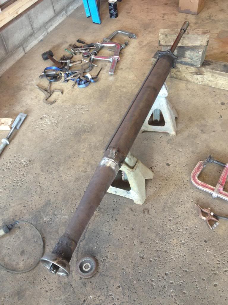

    Today's progress:
    I managed to finally get the torque tube cut down and also the driveshaft. Got that all ****oned up and installed. I left the center bearing. It Fits great .planning on fitting the pedals tomorrow and get the wishbone changed out to a 36' style. That way I don't have to split it.

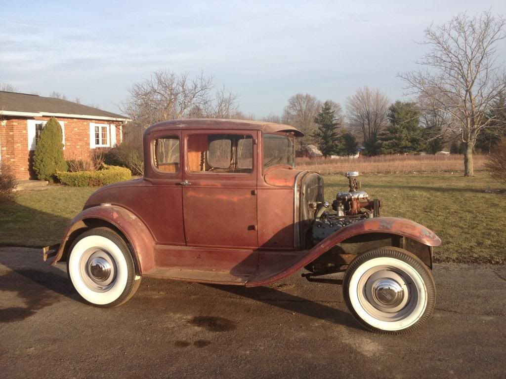

    Moved it outside to clean the garage, figured I would take some pics being as it was 55 today:

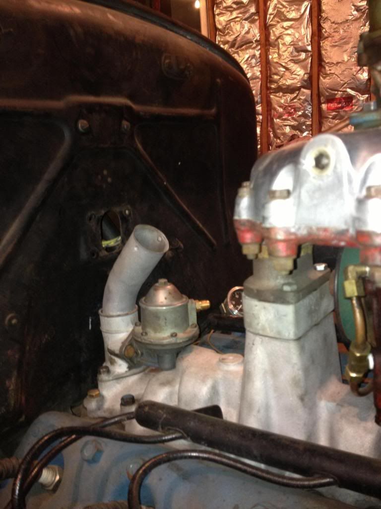

    I'm back to the fuel pump stand.... Dave did me a huge favor and gave me a new stand.. It's alot shorter than the original and the casting around the breather tube is smaller in diameter on the outside. It bolts on and clears the firewall with no problem!! Ah ha... Bout damn time! After a little heat the breather tube popped right out. I will not be able to just slightly miter cut it to lay forward. I will have to extend it 2 inches up and lean it forward about 20 degrees . That will make my breather clear the firewall and it will look correct..... I threw the old temporary breather/oil fill in the dumpster, as everytime my wife comes out she giggles and tells me it looked like a **** sticking up. So bye bye to that thing ..

    Made a little progress today. I spent alot if the day riding the wheels off my harley enjoying the sunshine.. Beautiful day! I got the breather all done. Used the original tube and added a bent extension to it. Welded it up, gl*** beaded it and you can't even tell... Also made some progress on another small project of mine. The model a mail box.
