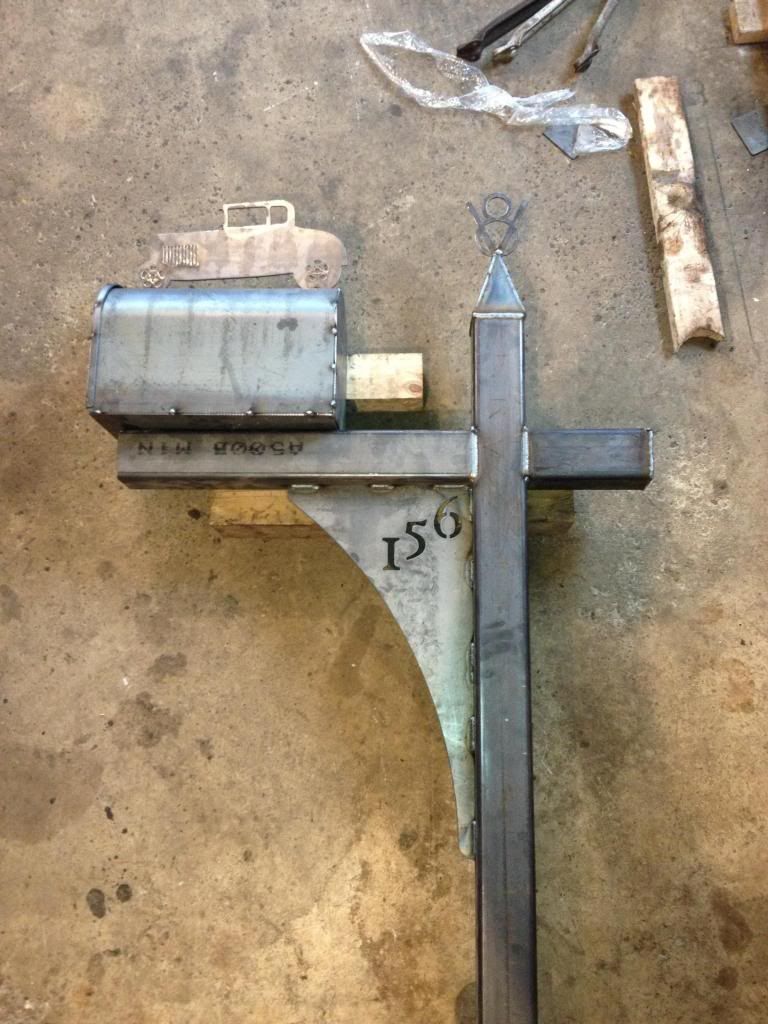

    Got some side work done also. just need to do some finish welds and smooth it all out

    luv the mailbox, and the build.
