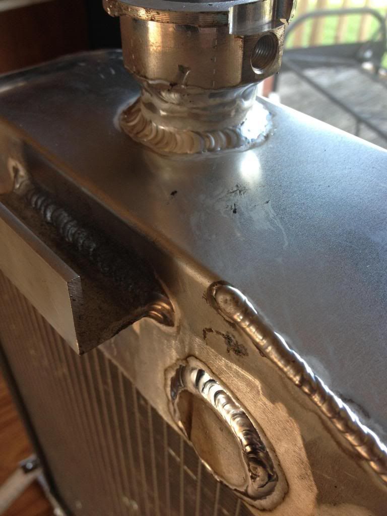

    Radiator is finally welded. Thanks John! [​IMG]

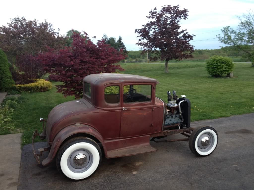

    looks nice----i have be-utiful flowers all over my gr*** too---lol

    The magic question is.. Did you push it onto the gr*** or drive it there? :)
  7. hotrodderhaag
    Joined: Jan 22, 2007
    Posts: 2,147
    hotrodderhaag
    Damn I hoped no one was gonna ask that. ! I pushed it......... :(. Just for now. Lol

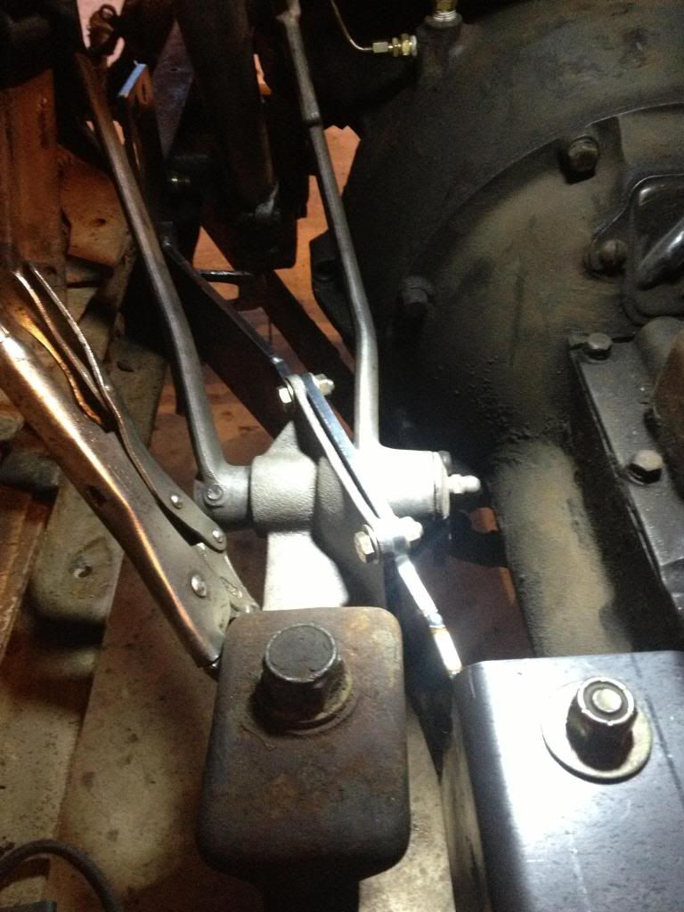

    I did get the carbs cleaned and fresh gaskets to seal them up good .. Still working on pedal brackets . I'm really hoping to be able to run it soon
  10. hotrodderhaag
    Posts: 2,147
    hotrodderhaag

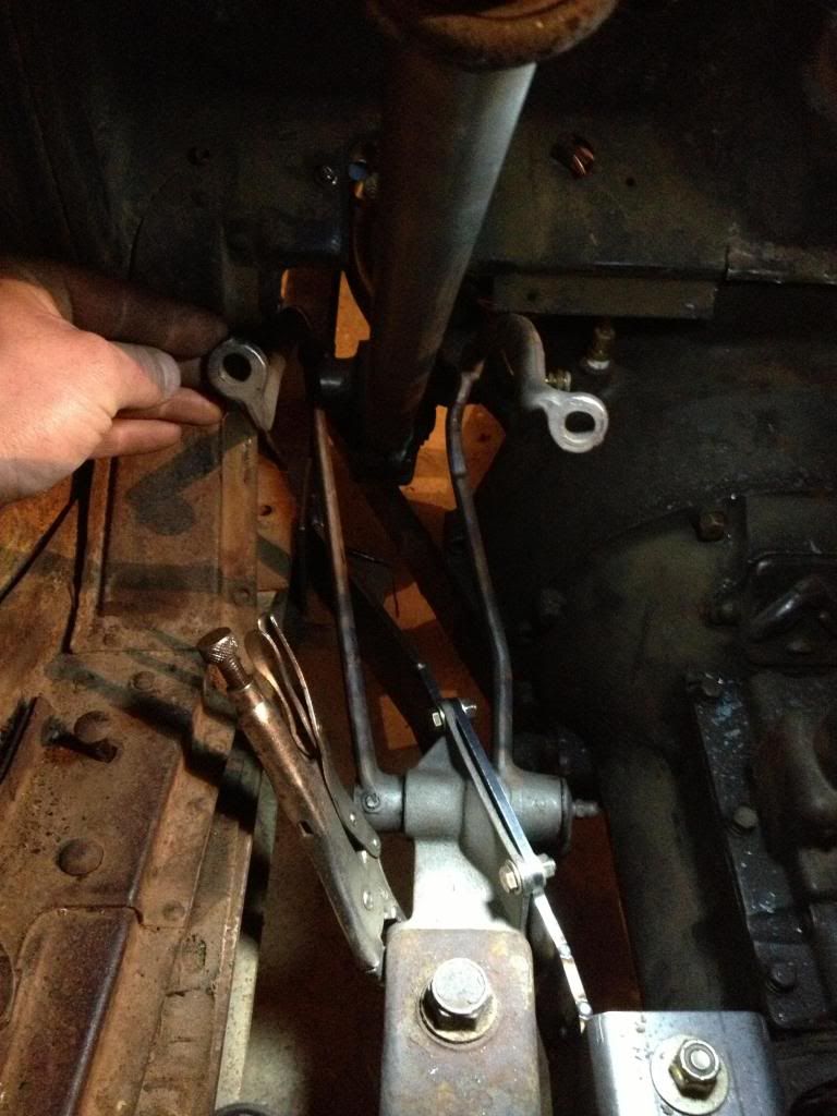

    Had the water tunes bent up today out of stainless. Also finally got my pedals all mounted. Still need to heat and bend the stems just a hair. But they fit great

    I managed to get the fan cut down and put on. Also heated and tweaked the pedals as best as I can to fit the car comfortably.. I also got the exhaust welded up and I heated and dimpled the fire wall behind the fuel pump stand for a lil more clearance. Installed a high volume fuel pump also. Making progress

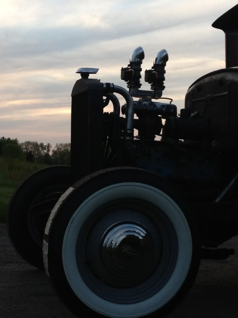

    It's alive and running. Will post several videos tomorrow. Here are a few pics... Got alot done today .engine seems to run hot even with the fan . I need to put restrictive plates in since I'm not running thermostats

    An ol' flathead roundyround racer I visit at his shop occasional, told me they used to run the 37 block with the waterpumps in the block, then flip the early heads (left-right) so the outlets are in the back of the block, to increase flow to the back cylinders and block. It would require someone to cut up the firewall, which you aren't doing. Just some useless information. :]'
    Anyway, nice car and build.
  29. hotrodderhaag
    Posts: 2,147
    hotrodderhaag
    Saxon. That makes alot of sense. It seems mine with a four core radiator still gets hot after a while of running in the garage
