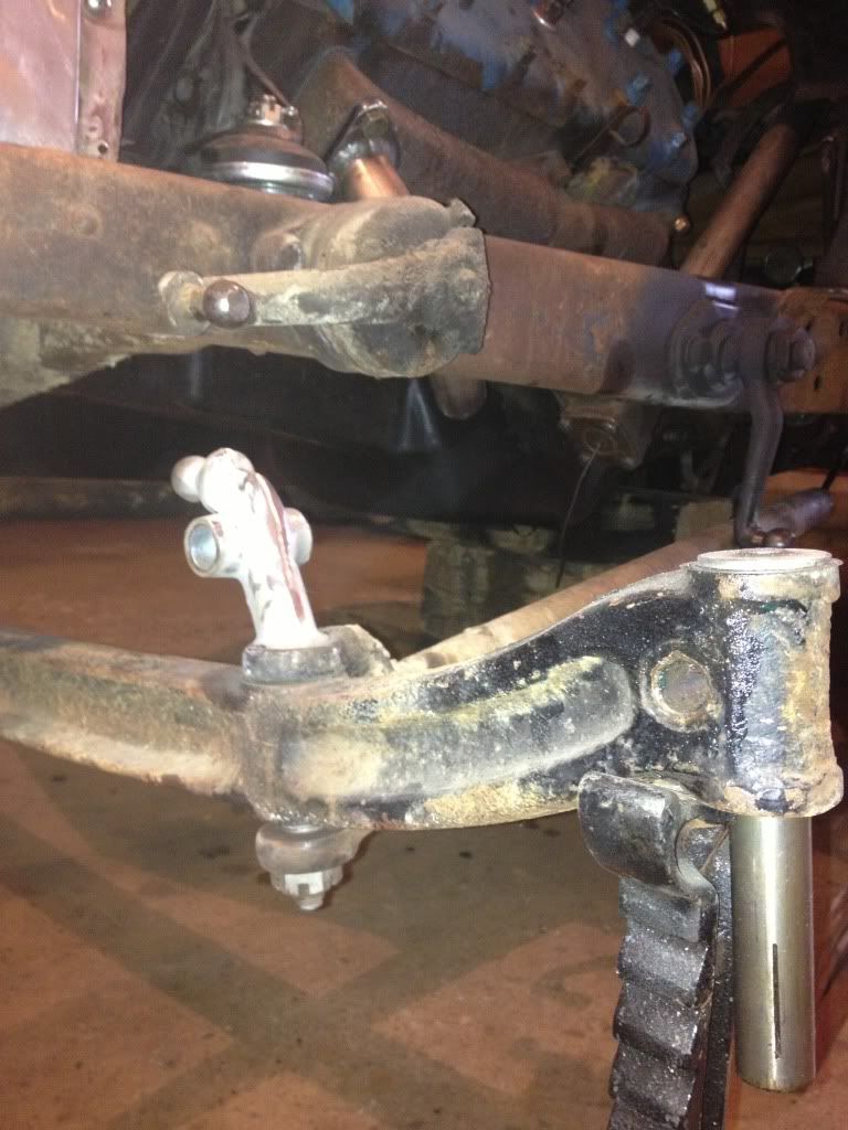

    I started the front end today. 1936 front axle beam with model a split wish bones, reverse eye spring with 3 leaves removed

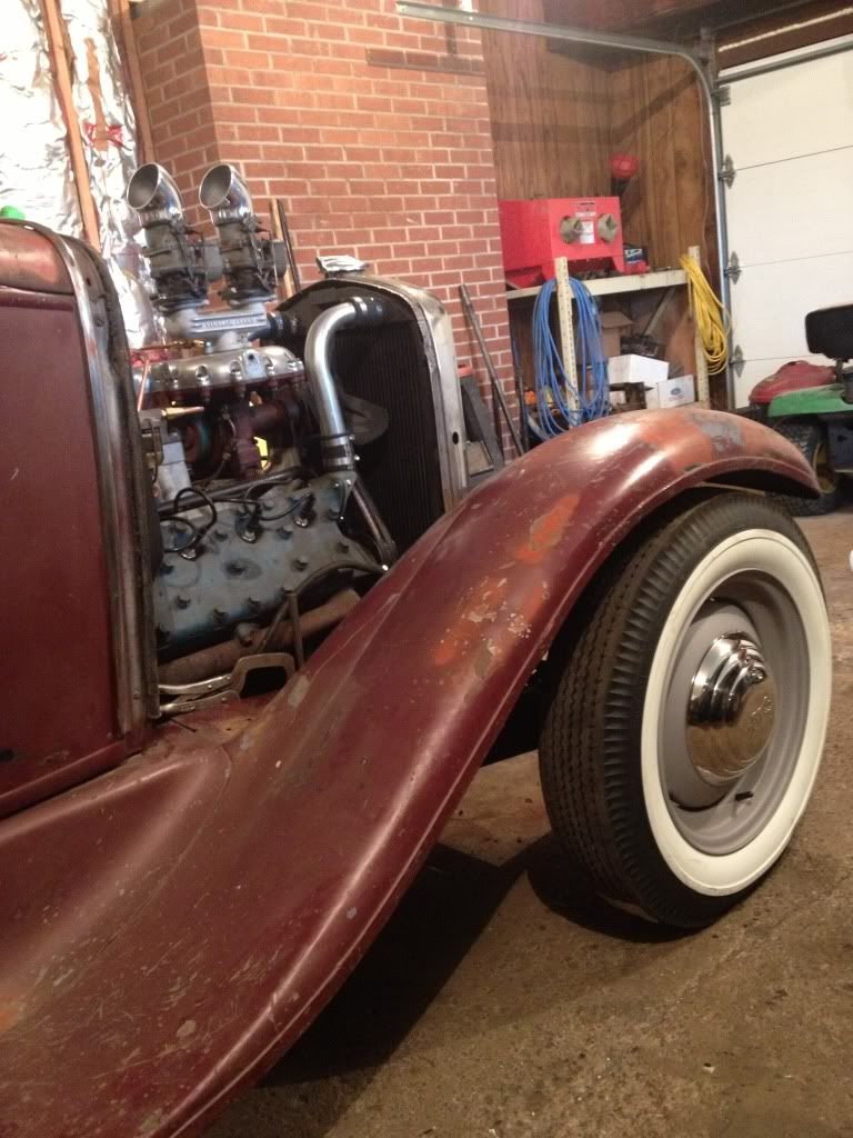

    Much better looking now.... Could use anther inch of drop but im happy with it . the rear is next .....

    how about a fanshroud? a shroud would force the fan to **** air thru the rad. As it is now the already smal fan will take it´s air from al over the place.
    Greetings from Sweden :)
  13. hotrodderhaag
    Joined: Jan 22, 2007
    Posts: 2,147
    hotrodderhaag
    I thought about that.. I may have to hand fab one . I'm gonna work on that now that you mentioned it . Thanks for the tip!

    i think im just to concerned about the engine.. it really does run good and i am going to have to weld a pipe pung into the fabricated water neck for a temp sender, also i am not running any thermostates. which i have seen work well and work against you in situations. i need some restriction in there to circulate water. so im ordering a set of the later style drop ins that should help also. not to mention the carbs are not dialed in and im still working on what to do with my distributor.... In a normal flathead engine, the intake is drawing vac*** through a tube for the brake on the distributor, on a supercharged engine, your now pressurizing that tube... which then makes that brake work differently... and suggestions? a friend and i came up with jsut backing the adjustment bolt off the brake as far as possible making the brake inoperable...

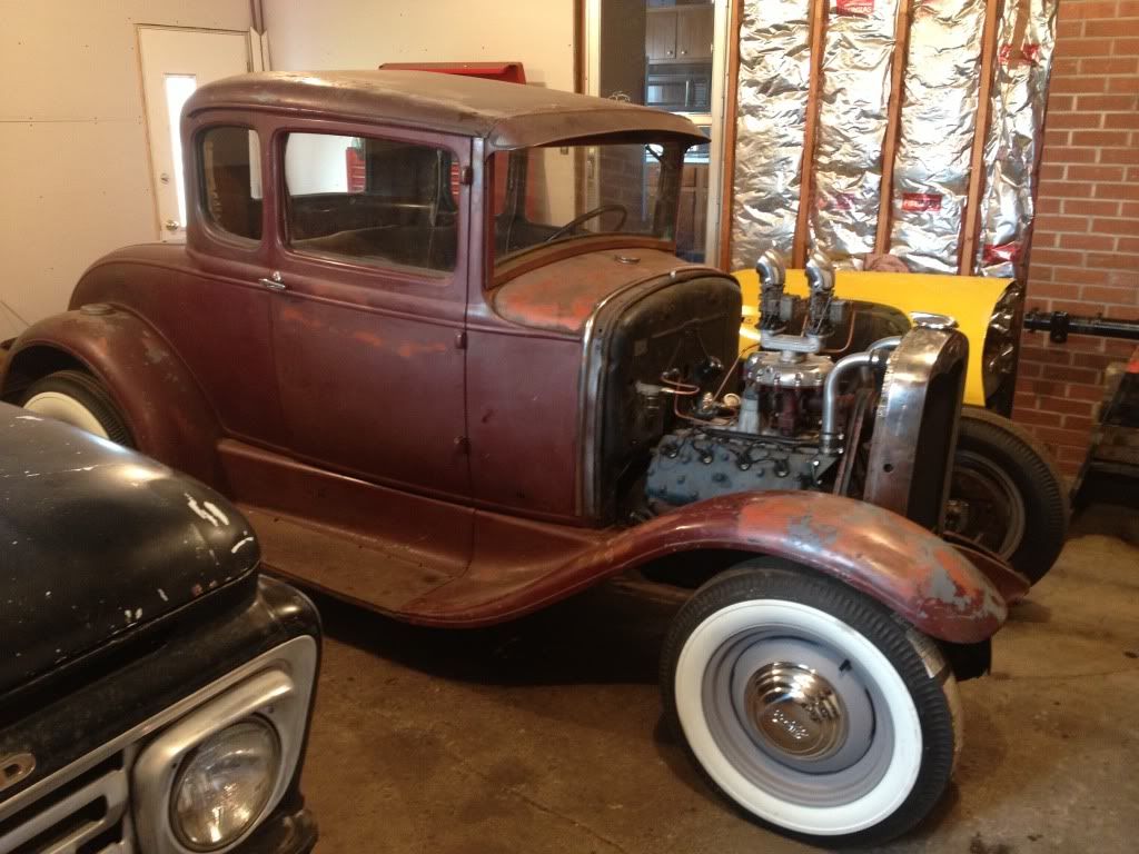

    Ok guys well today was a good progress day... I kinda slammed my front axle together to make sure it all fit well. So today I installed new perch bolts, all new bushings, had to heat and bend the steering arms and pitmant arm for clearance. Re packed hubs, all new cotter pins and grease fittings , the front is finally done ! I got all the front tin on and mostly bolted tight . There will still need to be some tweaking so i imagine ill have it all back off tomorrow . I need to install light bar and front bumper yet . I want the car complete and original minus the hood ad side panels. Basicly on my agenda is to plum the brakes, wire the car. And take it to the exhaust shop for the rest if the pipes . After all that she will be relatively completed . Other than some small odds and ends . So far I am very very happy with how this car has came along. It sure was a big difference from when I got it. I can't say enough how much I appreciate all the comments and ideas that you all have given me. Since I started this build, I have met some great people and got the opportunity to see some amazing parts and car collections . I posted alot of pictures on this thread. I wanted a person who was interested in building an AV8 to be able to see what is does really take to ***embly a car like this. It was alot more work than I first planned , but that's how every project goes. And to think I didn't have to do any body work at all! It give me a completely different outlook on guys who build there hot rods from scratch. You have my respect !
    Well guys here are a few pics from today... I was very happy with the progress. Hope you enjoy. Until tomorrow......

    Definitely needs a slight adjustment in ride height.. But it looks great!
  30. hotrodderhaag
    Posts: 2,147
    hotrodderhaag
    The only thing it's getting is 2 inch lower in rear.
