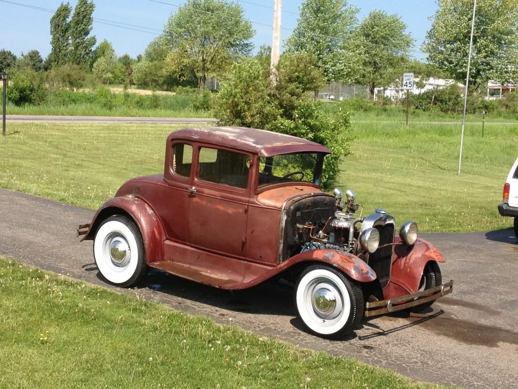

    I de-rodded it some today. I put the bumpers and factory lights back on it... I kinda like it with the original stuff back on it.

    Not so sure about the front bumper .... Keep it or tear it off ???? Advice
  4. would leave the bumper there, keeps the lurkers away from grabbin' the engine . ;) . very nice build, dude

  6. tomkelly88
    Joined: Aug 31, 2010
    Posts: 382
    tomkelly88
    Keep the bumper, and keep those lights exactly where they are!
    I think the rake and supercharged flathead are all this car needs to be cool.

  8. Carter
    Joined: Mar 18, 2006
    Posts: 1,542
    Carter
    Leave it on there. Looks perfect.

    Rolled it outside this morning so I could get a better look. I gotta tweak the bumper a lil on the divers side. But I think I'm happy with how it turned out

  13. Bigcheese327
    Joined: Sep 16, 2001
    Posts: 6,741
    Bigcheese327
    Exactly. Nobody's going to mistake this for a stocker, and it's got nothing to prove!

    It got a bath today for the first time in many years.. Boy those white walls sure doo shine!
