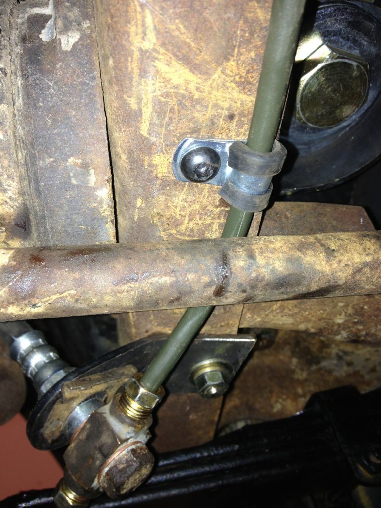

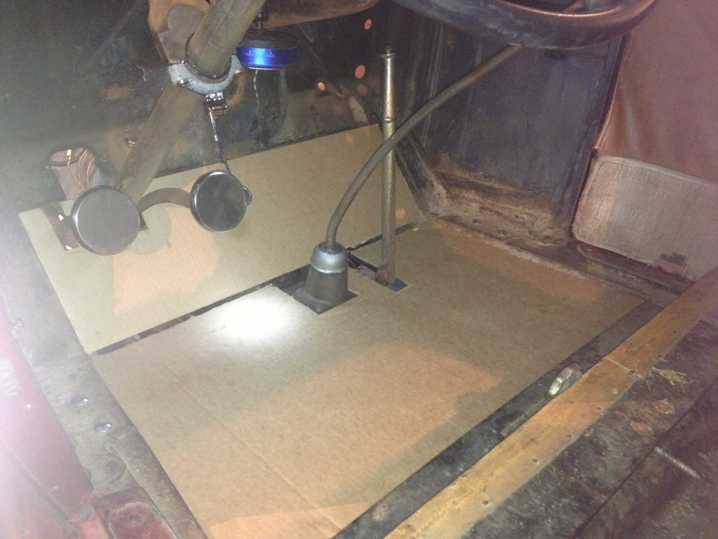

    I managed to get some things tied up this weekend. First off I ran all the brake lines and attached them to the bottom side of the frame. That's just how I preferred them. After that I installed all new wheel cylinders and brake hoses. Everything came out nice. Since that was all done I moved into the Interior. New floor boards which I made from 2x36x1/2 pine strips of all different grains, glued them all together and clamped em. After about A day they were ready to be plained down smooth. Two setups like this was enough to make all my floor. I made some cardboard templates for all the locations for the pedals and levers. After an hour or so of routing out the holes and chamfering everything, they fit right in. Next on the list was the water temp gauge that I never did get around to installing. So I figured I would try to hide it. I took off the right water pipe and drilled a hole on the inside face of it welded in a simple pipe bung , installed the mechanical sender and it was perfect . I was worried before because it felt hot to touch. Well I ran it for 20 mins at 2000 rpms in the garage with no air movement other than the little fan on the engine and it warmed up to 170 and was good from there. One other concern was the oil supply to the charger. I'm not sure why Its still on the back of my mind. I cracked all the supply lines loose and they seem sufficient . I cracked the return line loose also , same thing. Sufficient oil volume. Maybe I'm over thinking it due to its rarity, and how I don't wanna hurt it. My new/ different throttle linkage came yesterday also.I am waiting on my vintage carb spacer w/ vac*** port. So I wanna hold off till the carbs are at correct heights. Same goes for gauge pod for under the dash. That will make it nice for both gauges . I am also trying to figure out what to do about a light switch since the factory a column is no longer in use. Any suggestions? Here are a few pics. ImageUploadedByH.A.M.B.1370823331.050786.jpg ImageUploadedByH.A.M.B.1370823357.051260.jpg ImageUploadedByH.A.M.B.1370823376.589022.jpg ImageUploadedByH.A.M.B.1370823400.246543.jpg ImageUploadedByH.A.M.B.1370823414.404018.jpg ImageUploadedByH.A.M.B.1370823430.285961.jpg ImageUploadedByH.A.M.B.1370823447.442708.jpg
