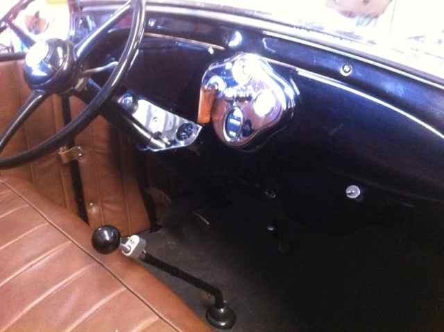

    I have a similar column drop. I built a gauge mount that follows the contour of the tank out of sheet aluminum, polished it and put a 4k tach on the left and a water pressure on the right. The light switch is to the left of the column and an identical wiper switch to the right. I will put an oil pressure in the left and move the tach to a Sun bucket when I find one with a low rpm tach. BTW, The hole in the middle of the F1 steering is the same and I think you could adapt a switch down there, but I could never find the parts cheap enough so I went this way.

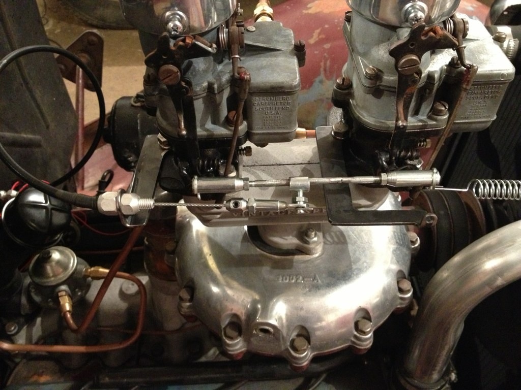

    And here is my non traditional throttle linkage. I did what I had to do. Maybe eventually ill find a 32' pedal and do it correctly.

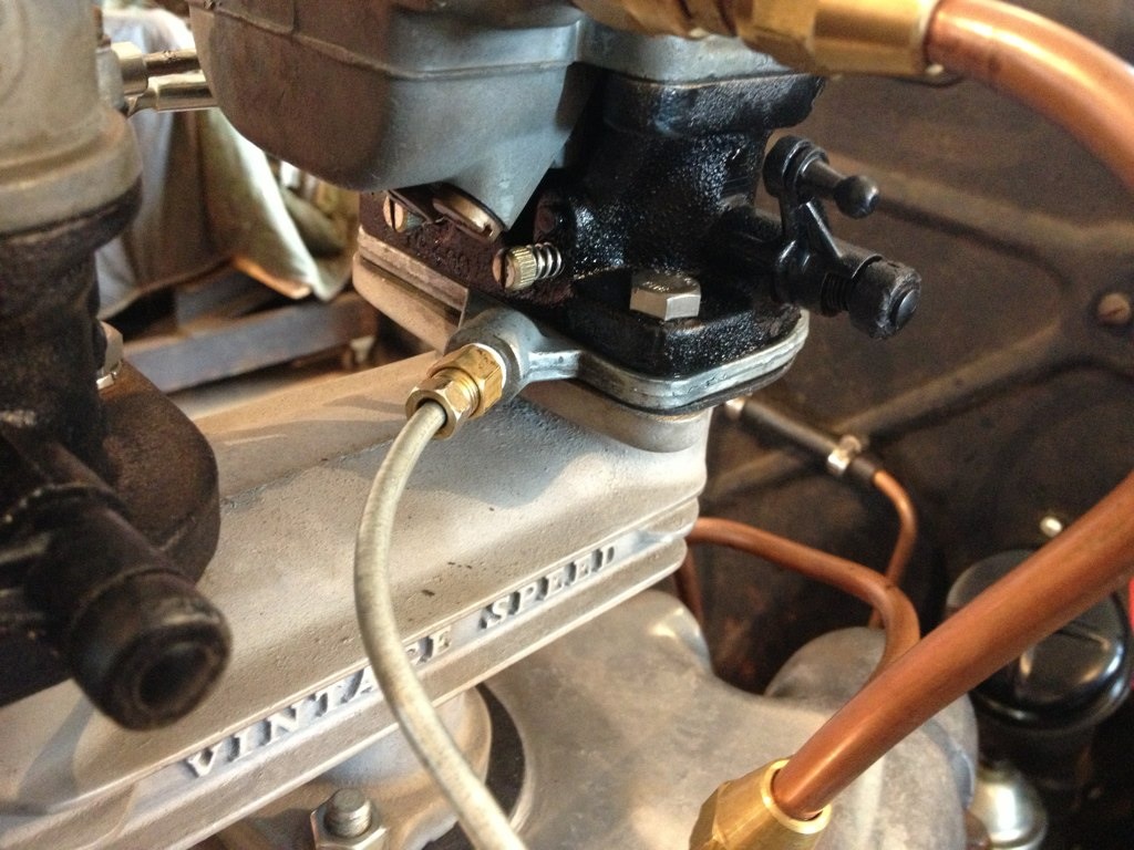

    Installed carb adapter for vacuum. Worked good, spun the tires leaving the driveway, ran right up to 65 all the way into town. Headed home and engine was at full temp, started running bad. Still trying to figure that one out

    Found the issue , leaking condenser and also a bad advance brake spring. Some one cut it down. Car runs excellent. Test drive tomorrow will really show the results , but so far so good ImageUploadedByH.A.M.B.1371094637.551979.jpg

    Installed the gauge pod today, also I received my coil adapter kit . I'm going to try to stick with the factory helmet coil , so this kit will be a back up
