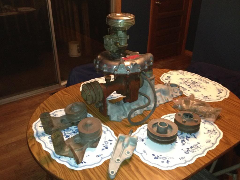

    Ok boys .... Here she is safe and sound .. Had to do a trial fit so I could sleep at night. Looks great and I met a pretty cool old guy when I picked it up ... He had some killer rods and really some amazing speed equipment,,, unfortunately I was not allowed to photograph.. But it was a site to see....
    Well I gotta change the heads yet, but I do believe I have almost everything else ..

    Well...... Here is the progress... Fenders are off, motor is in..temporarily. I cut some tabs just to hold the motor up and look right. Charger and accessories are being fit... Not going so well. Found out the dual pulley that came with the charger won't it my generator , and the dual pulley for the crank won't fit either... This stuff is all for a 24 stud... I'm a little bent about that stuff . Gen mount is also for a 24 stud..
    Well here is some pics
    Thanks Guys!

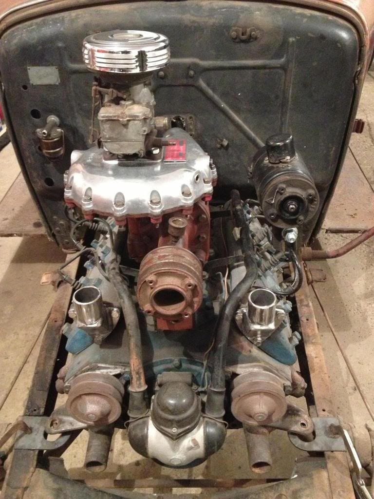

    Well got the water pumps on and generator bracket fit up... Everything looks good.. I may fab water necks for the heads instead of changing them...

    here are the cut parts for the water necks and the new generator bracket for the charger....
    decided to design a second bracket to make see which will look the best and give the most amount of adjustment. ill stick em in the press brake and get them all tig welded up

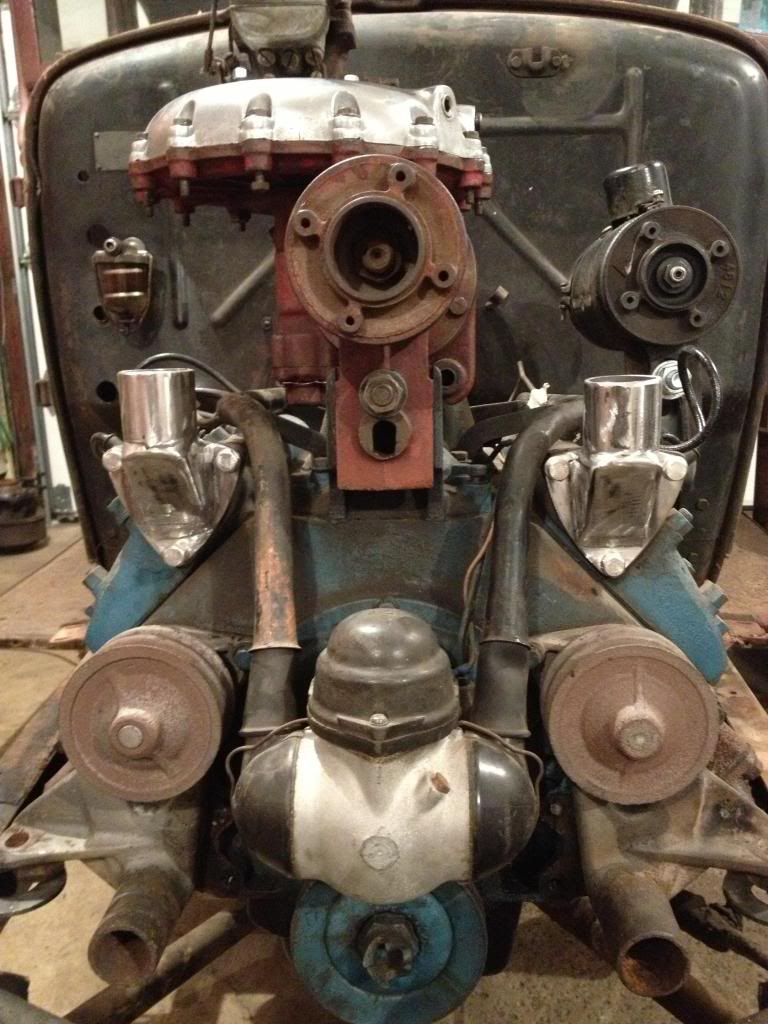

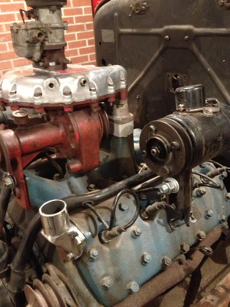

    all done.. im not the best tig welder... so... its decent. still learning

    Made up some water necks so I don't have to change heads. They look and work just fine . Gen mount worked good. Time for belts tomorrow . Waiting on motor mount bushings to come and a few other odds and ends
