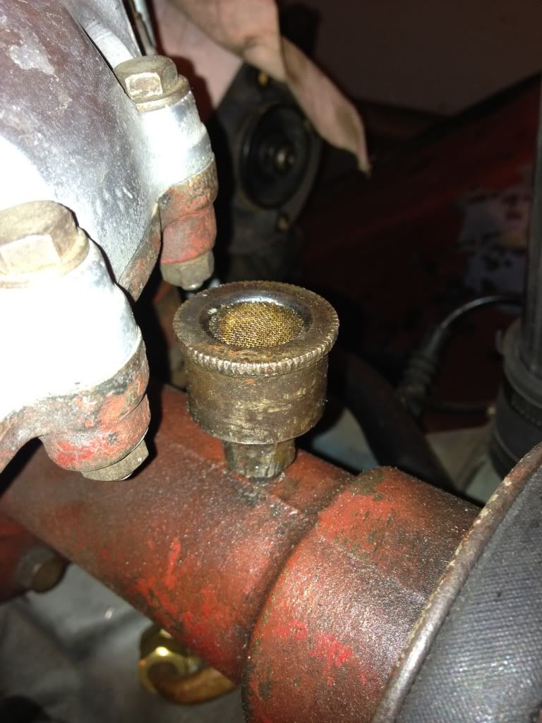

    I was not able to make any progress on getting this car running good at all. Here's what I am running into....
    I replaced the dizzy with one from bubbas. Bolted it on the car, it wouldn't barley even start. When it did, the timing was so retarted that it puffed black smoke and sounded like I was pulling a semi truck up a hill... Terrible . So I had no choice but to advance the timing a few degrees. So I did just that... Score! It ran great... Now the throttle was sluggish. Meaning that when I pulled out on the road it had no power as If it was taking forever for the timing to advance. When it finally did, it would take off like a Rocket, very impressive ... At an intersection you had to rev it pretty high to get it to move along, then once it was rolling you had to very gently ease into the throttle or it would just spit and pop and cough. But if you eased into it, it would lite and take off like a rocket. .... Now after about 15 mins of drive time it would warm up to 150-170 and then run like s
    Dog ****. So in my mind it was either a condenser or a coil ... So I replaced both. And backed the brake off just a hair.. It seemed great. 20 mins of drive time go by and it would just run like *** again... WTF! So back home we go. Popping and coughing, no power. So I got it home and installed the coil adapter kit on it. Remote located a brand new 6v coil with a brand new condenser on the dizzy, now it barley startes at all, no power at all, worse than before. Cannot even pull it out of the garage. So I put the helmet coil back on, bam! Starts good, runs good for a few mins then ****. Shut it off and let it cool, runs good again. I haw excellent fuel delivery, clean plugs, 90lbs compression across the board. Any ideas!? This super charger is about to find itself on a shelf....

    When this happens, what is the voltage at the ciol? Could there be something causing high resistance when hot? Ign switch? Connection somewhere? It has to be something common to both dizzys. Also, what is your plug gap? I have an OT blown street car that is VERY fussy about plug gaps.

    I checked the voltage and its 6v basicly. It matches the battery voltage. Plug gap is .027... I figured that to but I messed with bigger tolerances and it ran terrible

    With the stock coils, pretty sure you need a resistor to knock the voltage down to 3.**, can't remember the exact voltage.

    That's the second time I've herd that.. But no one has ever actually proved it. Am I over powering the coil? Is that even possible? I've never had any sort of resistor in anything. What gets me is using the aftermarket remote coil it says right on the side" does not require external resistor "

    The aftermarket one must be internally resisted. Stock V8 fords had an under dash mounted resistor.

    6 volt system, 6 volt coil should not require a resistor. 12 v conversions need a resistor. The resistor protects the points not the coil. I think you said earlier that you checked/replaced the condenser.
    BTW the Model A guys I run with have found several condensers bad right out of the box. Be sure you dont have a China one. They'll give you fits.
