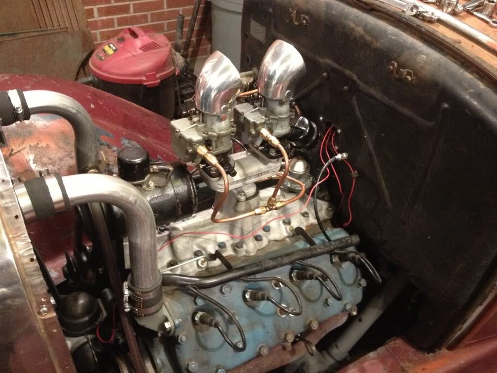

    Removed blower, re blasted intake and checked very closely for crackes using heat... No luck. So a really good guy drive his bad *** green 37 coupe over and brought me a good intake gasket ..nice ride BTW.. Anyways we got the engine all resealed and installed both carbs ... Fired right up. Ran perfect. Did a couple hot laps on the road ..... 165 degree water temp, SAME deal!!! So I removed carbs, stuck one on there... Sammmmmmeeeeeee thing. Terrible. So... I ordered new coil, new condenser, new plug wires and new plugs. Just cause the stuff I was using is off a good running motor but now ill have new. So I still leaning saying I have 4 bad coils here and 2 bad condensers....... Hmmmm.

    So it's midnight roughly ..... And here is an update. It's fixed... Several things were wrong. 1st off.... Champion plugs are the biggest pile-o-**** plug I have ever seen... They are brand new and 3 plugs were shorting out inside the ceramic. I put a set if motocraft in it and it was a world of difference. But that was not all of it. I converted the car to 12v (temporarily) I installed a very hot coil and condenser from my old pulling truck. After that it was still acting up.... So I just stepped back and the one thing I didn't look close at was the the caps on the dizzy... Come to find out after pulling them apart from the wires and throwing them in the oven to see if they were cracked. At 150 degrees there is a very large crack that develops between two of the electrodes. So... It would warm up from engine temp,( approx 140 on the gauge is when it would throw a fit), and split open . making a short between the two electrodes and firing on cylinders when it was not supposed to.. So i dug out the spares, acid washed them and polished the electrodes, stuck it back together. Now all these things I did tonight made it run top notch.. There were several very loud hole shots up the road but no long road test. But I had it running up to 180 degrees , and for half hour like that with no issues what so ever.... So I'm declaring this heap FIXED.... Maybe tomorrow ill drive it a bit and then start preparing the charger to go back on.........hope all goes well
