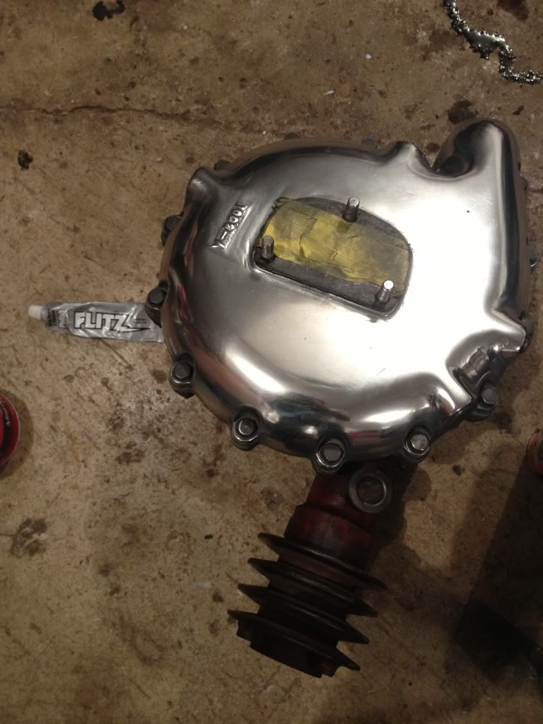

    Well I started to get some things done to the car today. I tore down the entire front end, installed 37 spindles and kingpins, tore the brakes down and blasted all the internals to ensure everything was free and working good. They are like new. I also got my new tie rods from speedway today. However I used the model a wishbones when I put the car together and with the 37 spindles I have to hear and bend the steering arms straight down about 1 inch to have perfect clearance . Also will be installing a new drag link and pitmant arm to match. After I got as far as I could on that with out bending the arms , I decided to start getting the supercharger ready to reinstall. Polished it all up with some flitz.. That's some amazing stuff . Anyways resealed the intake , all the plentum gaskets replaced and dis***embled the charger and resealed it.. Everything looks much better. I'm excited to get the car back together. It will be done tomorrow.

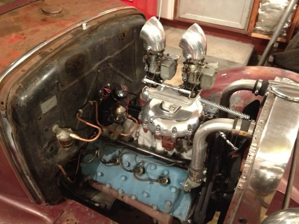

    Ok guys.. So I discovered this info: there is no difference in a 6v and a 12v coil other than ohms.... So... You can run six volt into a 12v coil as as long as you have the correct ohm coil it will be just fine. So I bolted my coil adapter plate back on today, threw my old 12v truck coil on, and supplied it with 6v of juice... Car runs fantastic.!! I'm still having a slight hesitation when into the gas, but that fuel air mix has a long way to travel so that's expected. My timing I still acting funny. It's retarding too much under acceleration. Plus I have 2 normal strombergs , not a primary and a secondary. So that's not helping either. But we hopped in it and drove a total of 100 miles today. First a 30 miles round trip rear. Then a 75 mile round trip cruise. It ran great! Rolled down the road with traffic at 55-60 mph.. A few days ago I installed the 37 spindles and switched everything to newer tie rod end style steering instead of ball and socket. It handles extremely well. I'm still getting some wonder from the body roll of not having shocks hooked up. i aligned it with some jigs we used on our old dirt track car, and it goes good.
    It was good to have it on the road running good. A nice enjoyable day. A few small odds and ends , and the car will be done ready for the rest of the summer. Looking at new projects now.flathead powered 33-34 ford 3-5 window with a heavy lakes chop. I wanna make a road trip to bonneville like some guys have done. That's my goal
