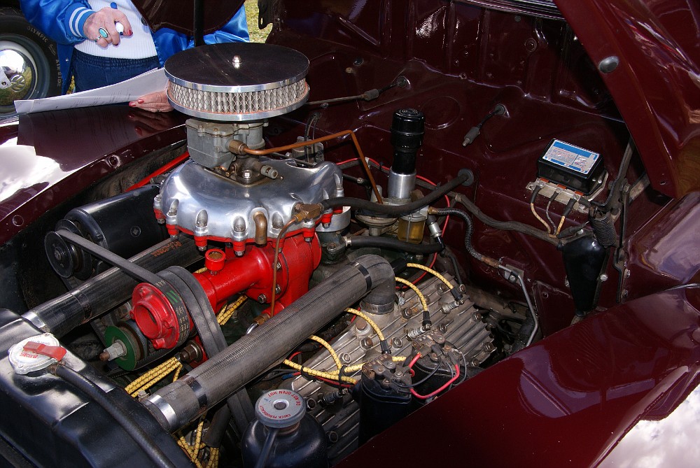

  10. hotrodderhaag
    Joined: Jan 22, 2007
    Posts: 2,147
    hotrodderhaag
  11. hotrodderhaag
    Posts: 2,147
    hotrodderhaag
    Cleaned the garage out after work today and took a few pics outside
    More to come later on.

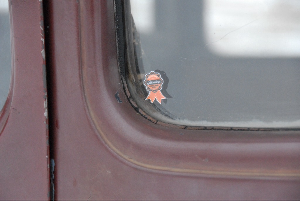

  14. hotrodderhaag
    Posts: 2,147
    hotrodderhaag

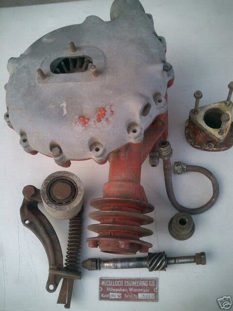

  21. hotrodderhaag
    Posts: 2,147
    hotrodderhaag
    Now I have a new part to attempt to fabricate.. I run across this picture today, an original belt tensioner for these blowers. All I need to do is find the flat roller with bearings in it . The rest is cake . This Is the first tensioner I have at actually seen! Finally

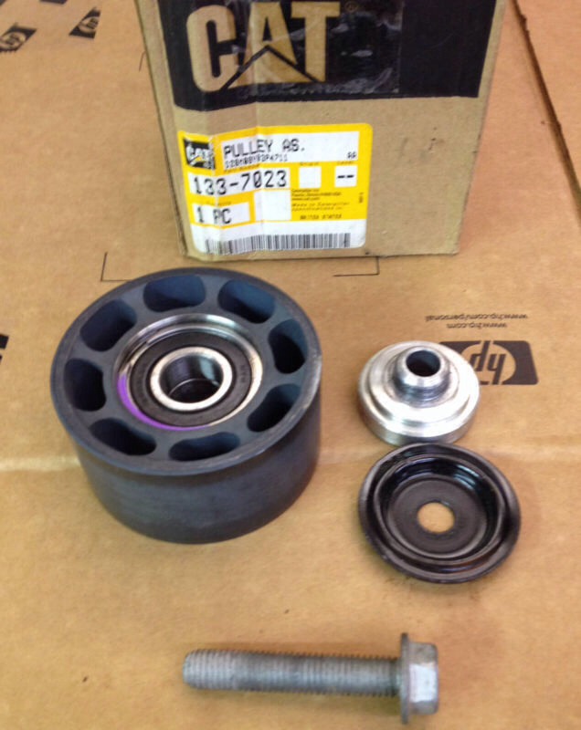

  22. Carter
    Joined: Mar 18, 2006
    Posts: 1,541
    Carter
    Pulley looks similar to the fan belt idler on the C15 in our Peterbilts at work. I can grab ya a used one to try.

  23. hotrodderhaag
    Posts: 2,147
    hotrodderhaag
    Dave
    You bring up good ideas
    THis is what I found
    See what you can get :)
  24. Carter
    Posts: 1,541
    Carter
    Sort of like that but steel.

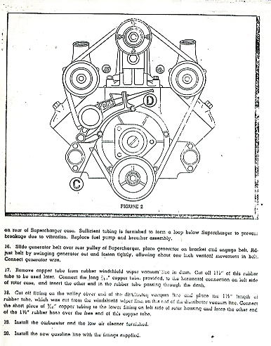

  25. Rockerhead
    Joined: Nov 16, 2006
    Posts: 321
    Rockerhead
    As you know you have a 1936 model supercharger. Attached is a page from the Installation Instructions for that blower. It shows you the setup of the tension pulley.
    Attached also is a picture of my '36 blower on a later engine. The idler pulley is fixed on mine.
    Enjoy your the super performance of your blown flathead.
    Don
  26. Rockerhead
    Posts: 321
    Rockerhead
    Here is the McCulloch page

  28. Carter
    Posts: 1,541
    Carter
    Here are the ones we use. Quarter is for scale. There is also an A/C belt tensioner pulley that is a little smaller.
