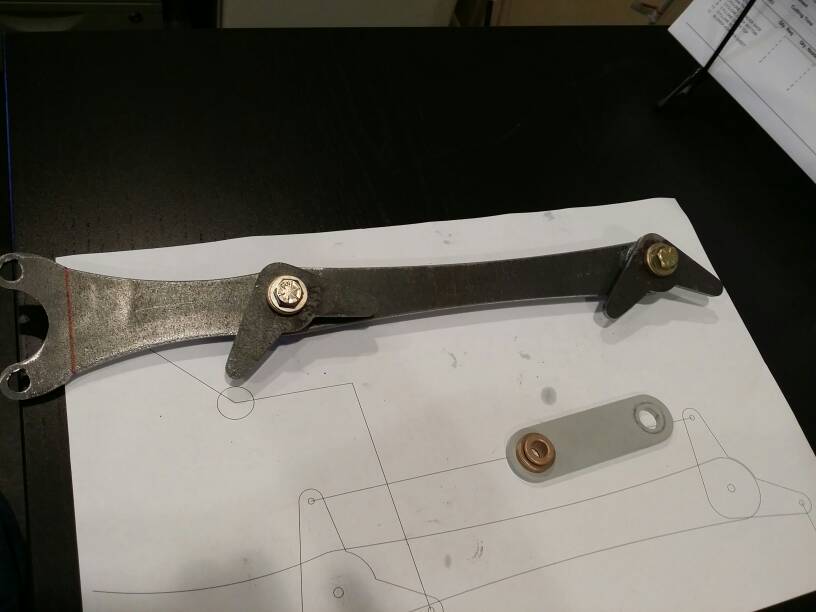

    This is what I have figured up so far. The bracket that holds the pulley itself will be broke at 90 degrees and the rest will just all weld and bolt together

    ***embled like this

    Timing belt tensioner for a 99-01 Civic SI I know I know but its small, steel, and could probably work with a custom made bracket to hold it. I'll track down a picture when I get off work.
  7. redzula
    Joined: Jul 6, 2011
    Posts: 1,366
    redzula
    Whoops looks like you already got it sorted somewhat

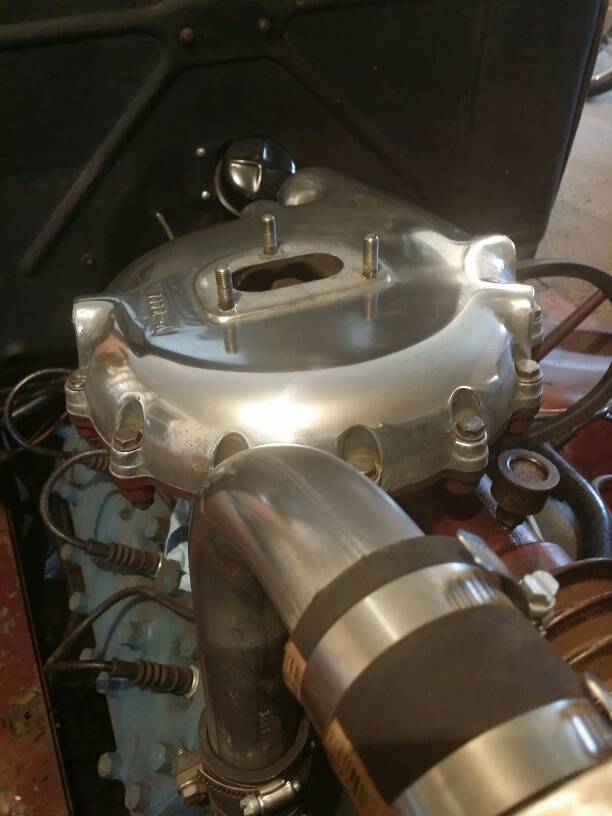

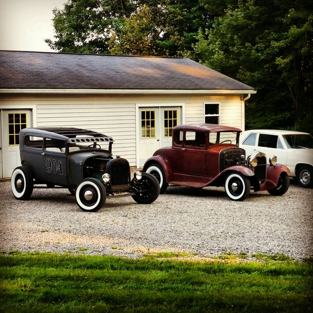

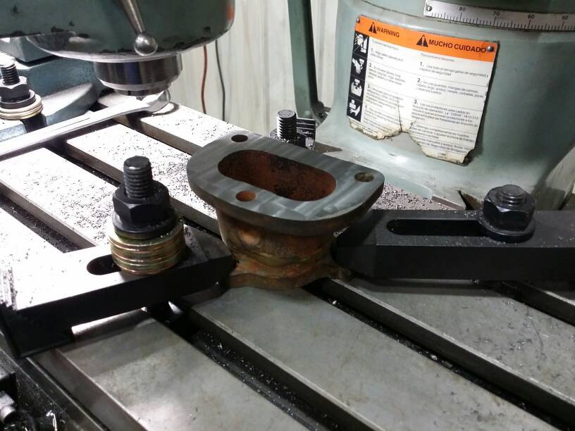

    I haven't done much to the model a in a while other than driving the wheels off of it .. I drove to Erie saturday to meet the rolling bones for lunch... that Friday night I was planning on reinstalling the supercharger but I needed to true up the gasket surfaces on the manifold adapter .. when they brazed the adapter back together , it was very crooked. So I clamped it to the bed on the bridgeport and flattened it out. It's much better now . Should make a much better gasket surface.
    Saturday, Dave carter and I left Hadley around 10 am... we ran up r 19, crossed over to rt 98 towards erie.. this was the way they used to go before the interstate was put in.. is a 60 mile scenic old 2 lane highway that has almost no traffic . My brother was going to lead the way heading north , but ended up having an issue with the pin in the driveshaft coming out and making some noise. So he headed back for home.
    So Dave and I went on without him. We spend the day In erie talking to Ken and Keith, Richie and fred, a**** the other followers of the bones .it was a great time.
    The weather alerts started flowing in about 3 oclock. So Dave headed for home.. he didn't make it in time.. I headed for home about 4 and hit a monsoon 45 miles from home.. it was a serious rain, wind and lightening storm.. but the flathead kept pulling along at 65 through the puddles. .
    Yesterday . We took the model a, along with my brothers sedan to cranberry pa . About 50 miles north of home. There was a late evening cruise in supporting a local church that we decided to go to. It's in the mountains of oil city and Franklin.. some large long sloped hills to pull. But both cars did great and never left 3rd gear. No heating issues with my brothers sedan . We have been fighting it due to some scale that came loose in the block and clogged the radiator..
    But after a few hours of talking to every old timer there, we turned on the headlights and headed for home.. I installed some late 50s bulbs that my buddy Alvin gave me in a zip lock baggy ..he said just put them in and they will be bright as hell.. and man o man was he right they are 3 times brighter than before. It looks like 12 volt low beams now! I can't out run them that's for sure. I may have to turn the generator up due to the power they use. But it's much nicer to drive at night now...
    This coming Saturday we have the Franklin pa drive and fly in at the Franklin airport on rt 8... then Sunday is metal eds backyard bbq! Gonna be a great weekend !
    I've attached quite a few pics of theses updates. . Enjoy

    I have been driving the coupe now all summer without the supercharger. Saturday we attended metal eds bbq and the first thing ed said to me when I pulled in was " your missing something and I don't like it" then he smiled. So I decided it's time to get the thing fixed and back together. I've been asked about 3 dozen times where it was or if I sold it. The biggest problem I found was someone had cut down the intake adapter and brazed it back together. When they did that. It was crooked and leaking. Plus a home made spacer was not helping the matters.. so I got to work and milled out a new spacer. I trued up the adapter on the mill also. we reinstalled the blower with all new seals, gaskets and new fuel lines... it now sits level in the car instead of leaning and It doesn't leak a drop of oil. This adapter I made is a temp fix. A gentleman I have been I'm contact with is restoring a mcculloch supercharger. He has the same issue I did. So he cast a new adapter for his and he is currently doing one for mine. So when I get the raw casting, i can mill it all out and make it factory appearing again. Here are area few pics of the parts.

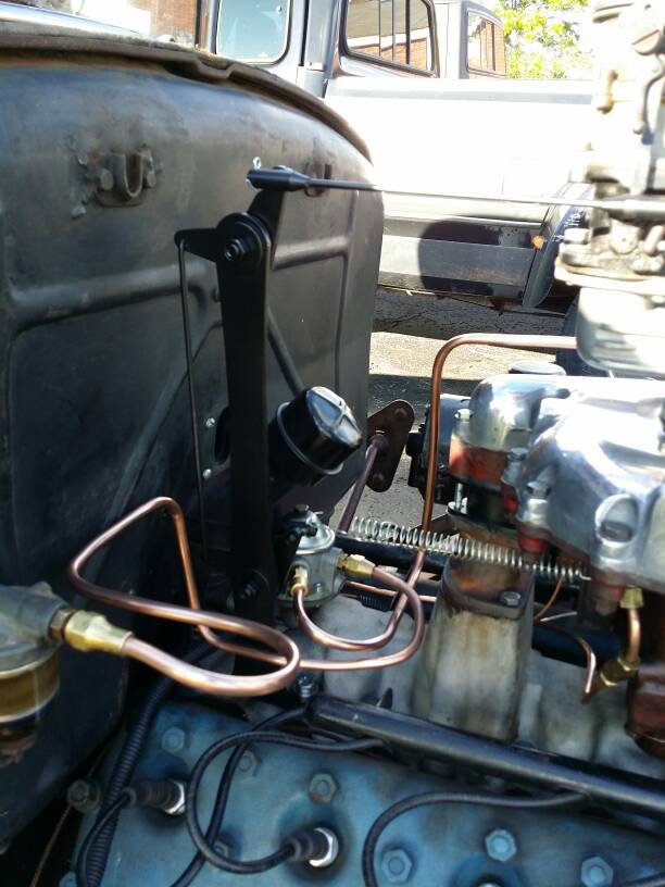

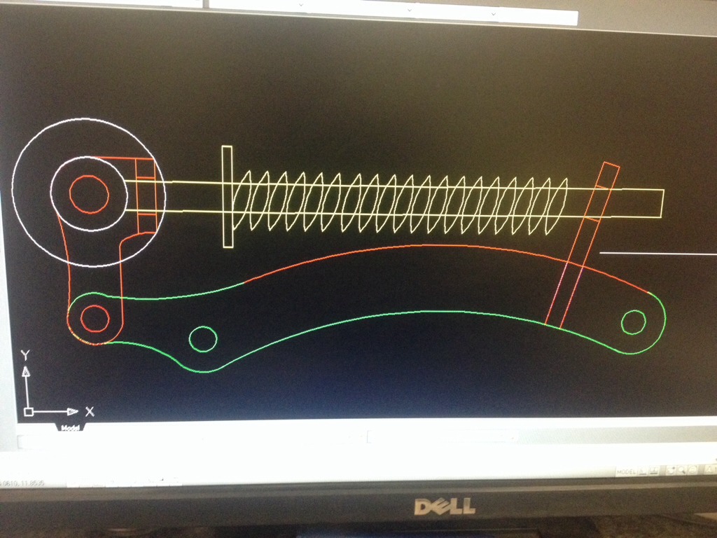

    I had to design and fab up a bell crank setup for the throttle. Previously it had a cable setup. I tried to just run a few mechanical rods and it was just impossible . So I came up with a short tower to bolt to the intake and hold the bell cranks that I made. They are bronze brushed and the allow ten inches of height to the throttle. This setup works... it may not be the most eye catcher but there really isn't to many other ways to get the job done.
