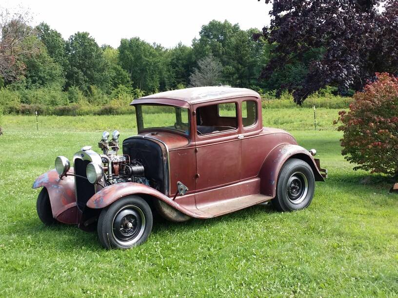

    I swapped out the wheels on my 34 for the race of gentleman. The white walks just weren't fitting for the blown race car look

    for the last month the model a coupe has been torn apart... the engine was getting tired.. so a month before the race of gentlemen, i decided to do a total rebuild.
    we yanked the engine. tore it down only to find some sludge in the pan and a pickup tube full of holes. that would explain my oil pressure situations.. and i also found 13 valves that were not sealing at all.
    so i sent the block out. had it all cleaned and i had the crank turned and polished. brought it all back home to start my build. ended up getting a set of NOS pistons, NOS pickup tube and some other small parts. i ordered stainless straight stem one piece valves, guides, keepers, retainers and springs... i also ordered a set of johnson adjustable lifters, and an isky 1007B grind cam from delta cams on an original ford core. . ***embly began.... About a day or so of carefully grinding valves and lapping them in, the motor was on its way to being whole again. i installed my set of aluminum heads and a set dual groove head mount water pumps.. Copper head gaskets helped seal it all up.. so the motor was all done, painted and back in the car..
    next it was the mcculloch supercharger.. ive been having oiling trouble with it.. it seemed to run hot like it was starving for oil. So i ****ed it up and dismantled it completely.. I found lots and lots of hard burnt oil chunks and a poorly placed shim gasket.. I cleaned it all very well, making sure to keep it in order.. i shot a nice coat of red paint on it, buffed the top cover, and it was back together the same night.. free as it could be and it flowed oil great.
    we re***emble the entire unit onto the motor.. went to fire the engine and it would not run.. not at all.. it would not even fire... after a few hours i come to realize what the problem was... When i ran this engine before, it was pooped, so when i got my new dizzy from bubba, i had to back off the brake so it worked properly with the ****py vacuum i had... so with the new engine all tight, sealing valves, and good compression, the vacuum was ten times what it was before. So i did some adjusting and it fired right up.. a few days of tuning and its really running great.. this little 21 stud is hot!!
    im not sure how or what guys do to invest soo much money in a flathead.. but i rebuilt this engine for less than $2000 there is 2 used parts inside,, the crank and the rods... thats it. everything else is new.. and i did not skimp on parts.. ive linked a few videos on here... the first one is almost the first fire.. you can here it not idling correctly....
    the second video is in the garage after alot of tuning.. its better but not perfect.. last night i got the car spot on! but no video yet.. and after a road test, this thing revs to the hill with power in all RPMS... that may be from me knocking almost 20lbs of cast off the flywheel also..... i forgot to mention that part! later on ill post some build pictures.

  10. hotrodderhaag
    Joined: Jan 22, 2007
    Posts: 2,147
    hotrodderhaag
    thanks jim,
    i do what i can with what i got. i need to give you a call about some timing brake springs and the plunger.
    it seems like i need it to advance a little faster....it has a slight hesitation and from what i can tell the carbs are giving a good shot of fuel, not too much, but enough. so it seems to need advanced faster.

    Send me a picture of the distributor you are running and i will get ya one built that has 22 degrees of advance and comes in quick with out the vacuum retard and you can try that....
    All i need to know is how many holes on the back side three or four and how many bolts hold the coil down 2 or three.....Let me know and i can get you done yet this week.....
  13. hotrodderhaag
    Posts: 2,147
    hotrodderhaag
    it a 3 bolt dizzy with 3 bolts holding the coil down..
    if you can get it out this week i would ****! it would be a good test for the race of gentlemen!! id like to get a stock condenser off you also. its very hard to squeeze that external one in there.
    ill PM you with info!
