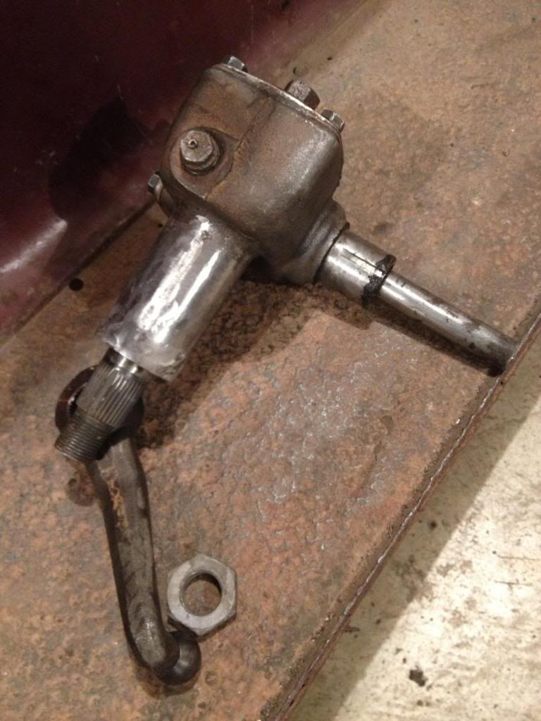

    Did you make a collar to go between the box and the model a column? Cause there so much bigger diameter than an f1.. I wanted to use my a column also but without machining a collar it will never happen

    Removed the factory flange and made the frame hole larger . [​IMG]

    I put an F1 box in mine and used the model A column because I still have the banger. I used a piece of the F1 column as a sleeve, then cut a couple of slots in the end of the model A column and clamped it down. I needed to do that to run the control arms for the banger.

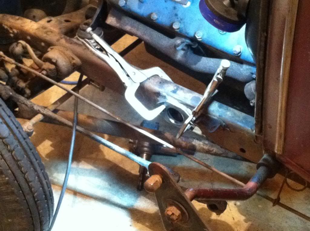

    Houston ..... We have progress . Finally the steering box fits and it even works with the manifolds that are on it!! Trans mounts are done . It's coming along nicely . Waiting on my new steering column tube and I need to build my drop bracket for it...

    It was a thight fit getting the box in there . I moved the hole down as far as possible. I used a flange on inside and a mating flange on outside to make sure it was a nice strong fit. I welded the outside flange to the frame only . I'm pretty happy with it. There is 1/4 inch between it and manifold. That's enough for me. Looks like I'm gonna order the split wishbone kit . Hope it clears my steering arm . Still wanting to do a juice brake conversion . Still hunting all the parts yet. Hoping to find a rear that has a little higher gears .. Reading every thing Brian b*** as wrote on here for some inspiration .. Tomorrow is another day

    Nice. That's cool that the stock headers fit with the lowered box.

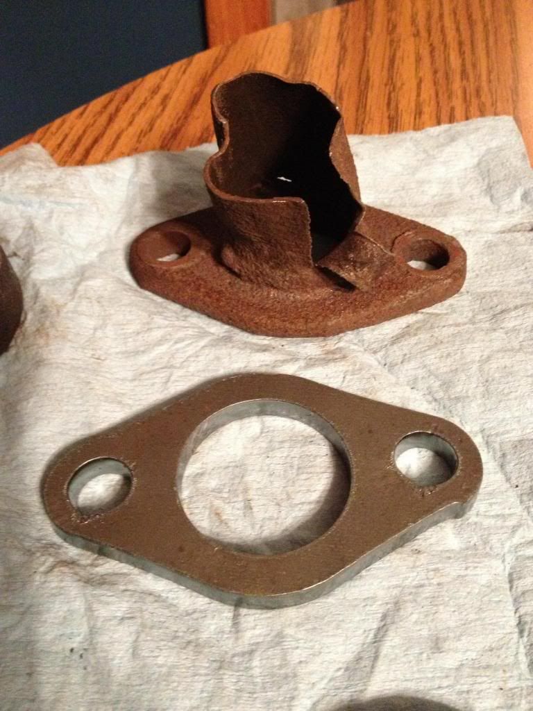

    Got the old exhaust flanges off the manifolds and new ones plasma cut. My exhaust tube should be here tomorrow to start making pipes to go back the frame . [​IMG]
