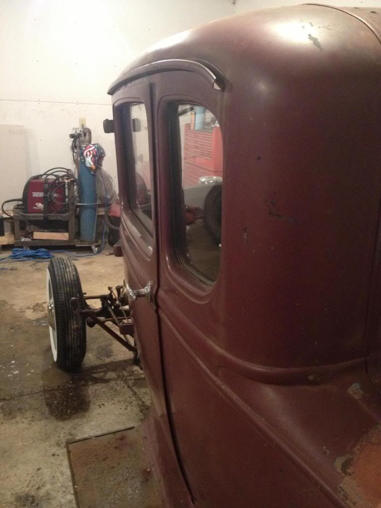

    Made some progress . I had the wheels and tires mounted... When I called Coker they claimed these wheels would fit a stock model a ford ... No chance in hell. Studs are way to short and the center hole is to small to go entirely on the drums. So there on but not all the way. It will roll this way.
    My favorite view of a model a coupe

    Definitely the fenders and hood top, no sides. I'll guarantee that was cool in late fifties/early sixties in Socal. Which brings me to the another point about California Pigs and fenders that I will start a thread on.

    tires look good though, I like the fender/no sides. But also like em fenderless too, either way it will look good.

    The fenders and hood will look great. but I'm just head over heels for that blue coupe that RUSSCO built. He sure did make a hell of a coupe.. But I'm leaning towards fenders
