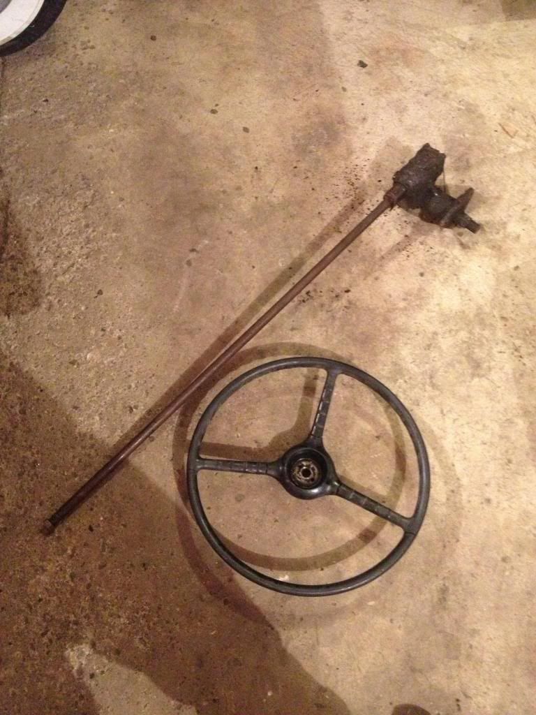

    Well I had a long afternoon in the garage ... Got the entire steering setup completed . It turned out great and everything works perfect .. I combined the two f1 boxes I had and made a complete one. Finish welded the flanges on it and got it all installed. I removed the entire mechanical brake setup, front hubs and backing plates... Waiting on my adapter kit to come for the 46 front plates and drums.... We pulled the rear end out and got the spring off it.. Time to build a spring spreader cause that was a Hairy situation the way we did it... But it worked ... Tomorrow is another day

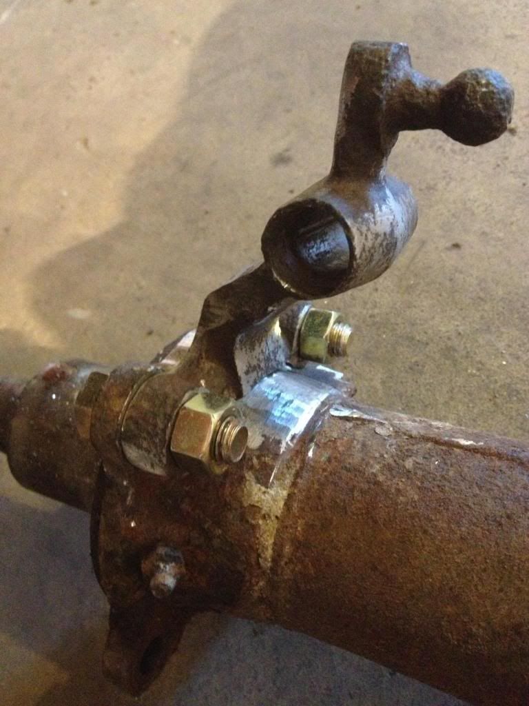

    I finally got bolts long enough to get my steering column clamp together ... I went to Dave's last night and picked up another rear axle. 3:78 gears and some misc parts ... While I was down there he handed me 2 NOS bolts for the slant windshield cars that have the factory column drop. Thanks Dave . That will get rid if the modern looking Allen heads. . I'm building my spring spreader and hub puller tonight after we get back from all the Easter dinners with the family.... Hope I can get a rear End in. I think I may even move my motor forward a bit so I can put a mechanical fuel pump and stand on it. Ill have the rad clearance so why not..

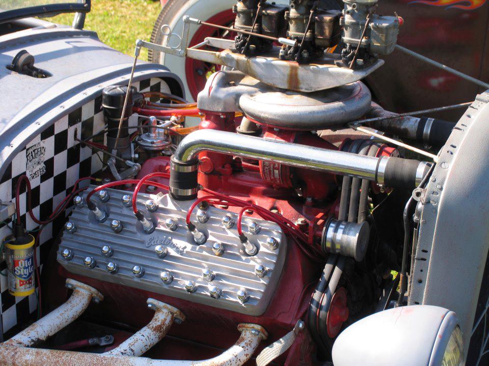

    I found my fan solution. This will mount to a bracket off my Intake and run off the 3rd groove on my supercharger ... Perfect.

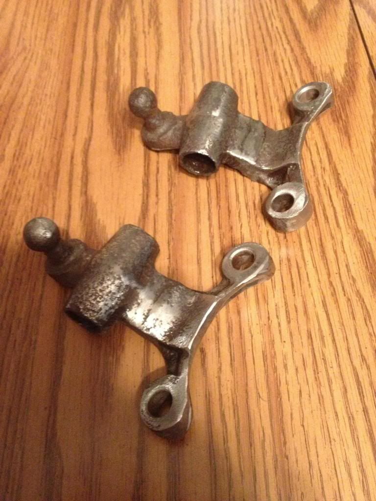

    Four long hours of fighting to get old shackles out... The bore is kinda rough, but I think once I get new sleeves put in them they will be ok... Also the shock link balls are pitted. I may mill them off and drill and tap the faces to accept te thread in style replacement ball.

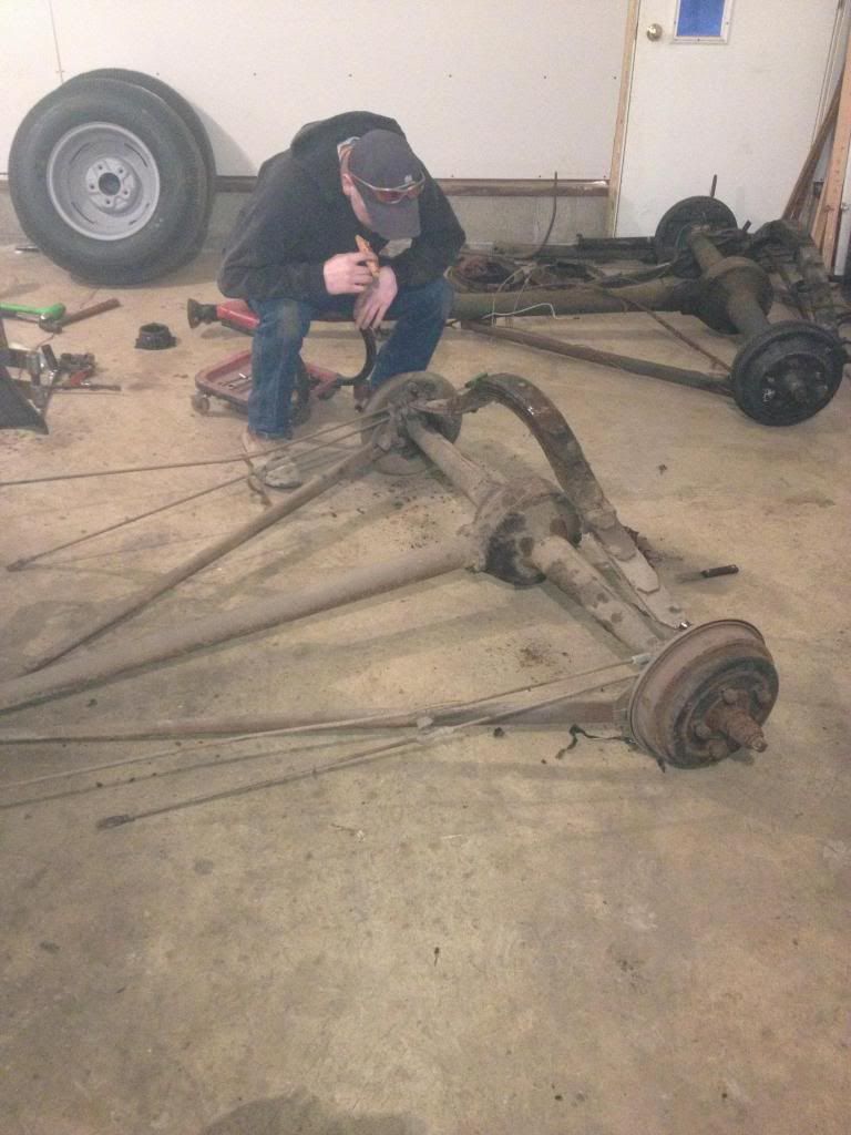

    I got the old spring bushings out of the hangers ... That was a pain in the ***. Got em all ground up and on for fit. After chipping away at 70 years of grease, I found the torque tube flange bolts and got it separated .. Waiting on shackles and bushings to put the rear in the car and get the tube and shaft cut to size
