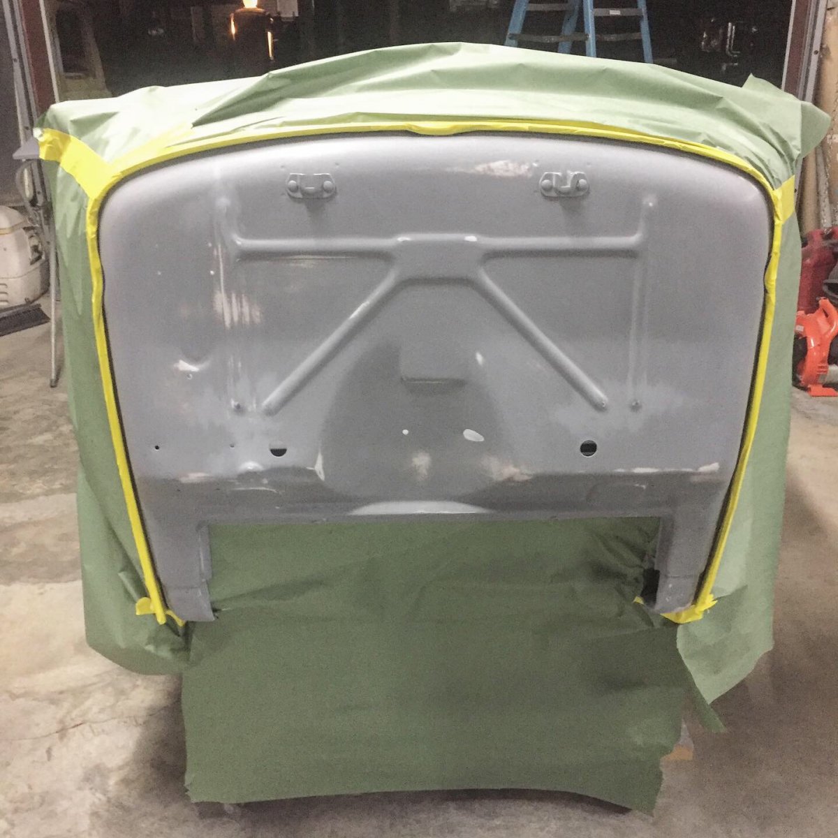

    We are leaving on a family vacation tomorrow to Gatlinburg, Tn. I thought id get one more thing done before we leave. Maybe it will keep motivated unitl i get back. Wetsanded the firewall, taped it off and Sprayed it this morning. Making progress

    Paint the windshield frame Black. :cool: JMO

    WOW> Time to go on vacation. Perfect.

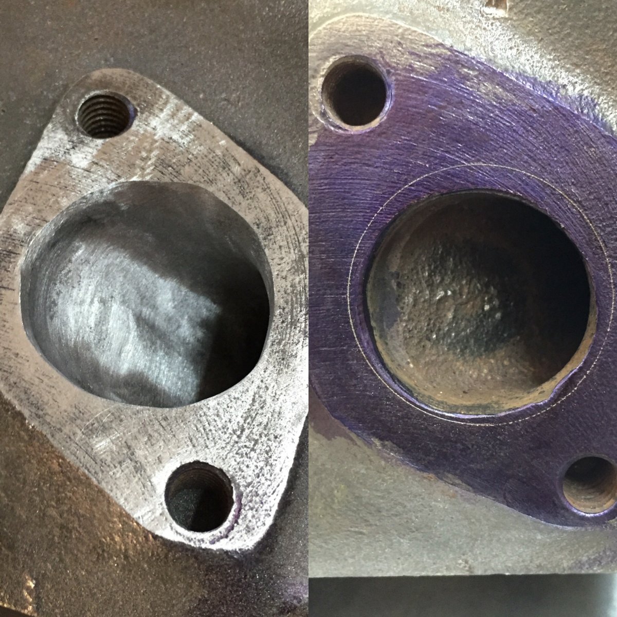

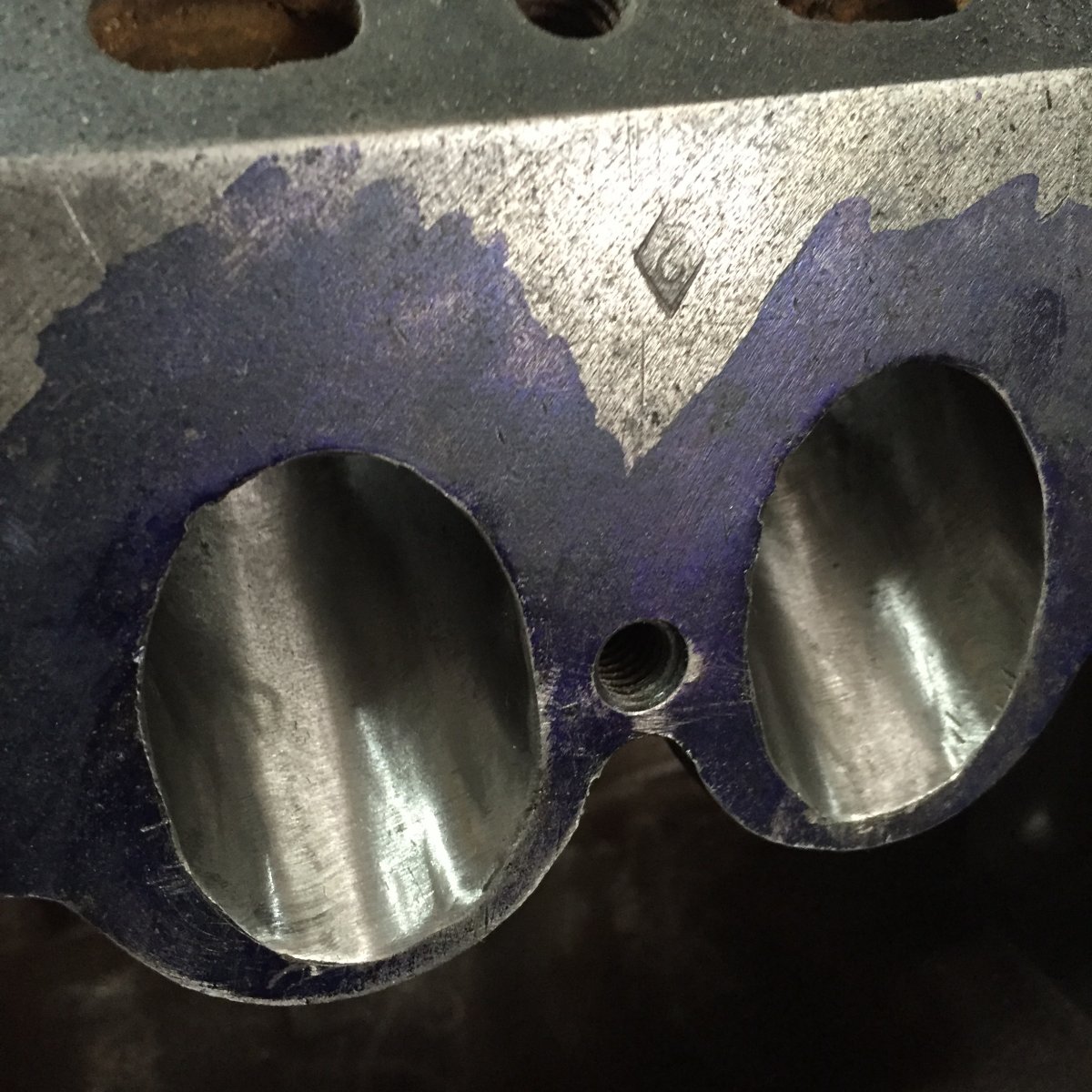

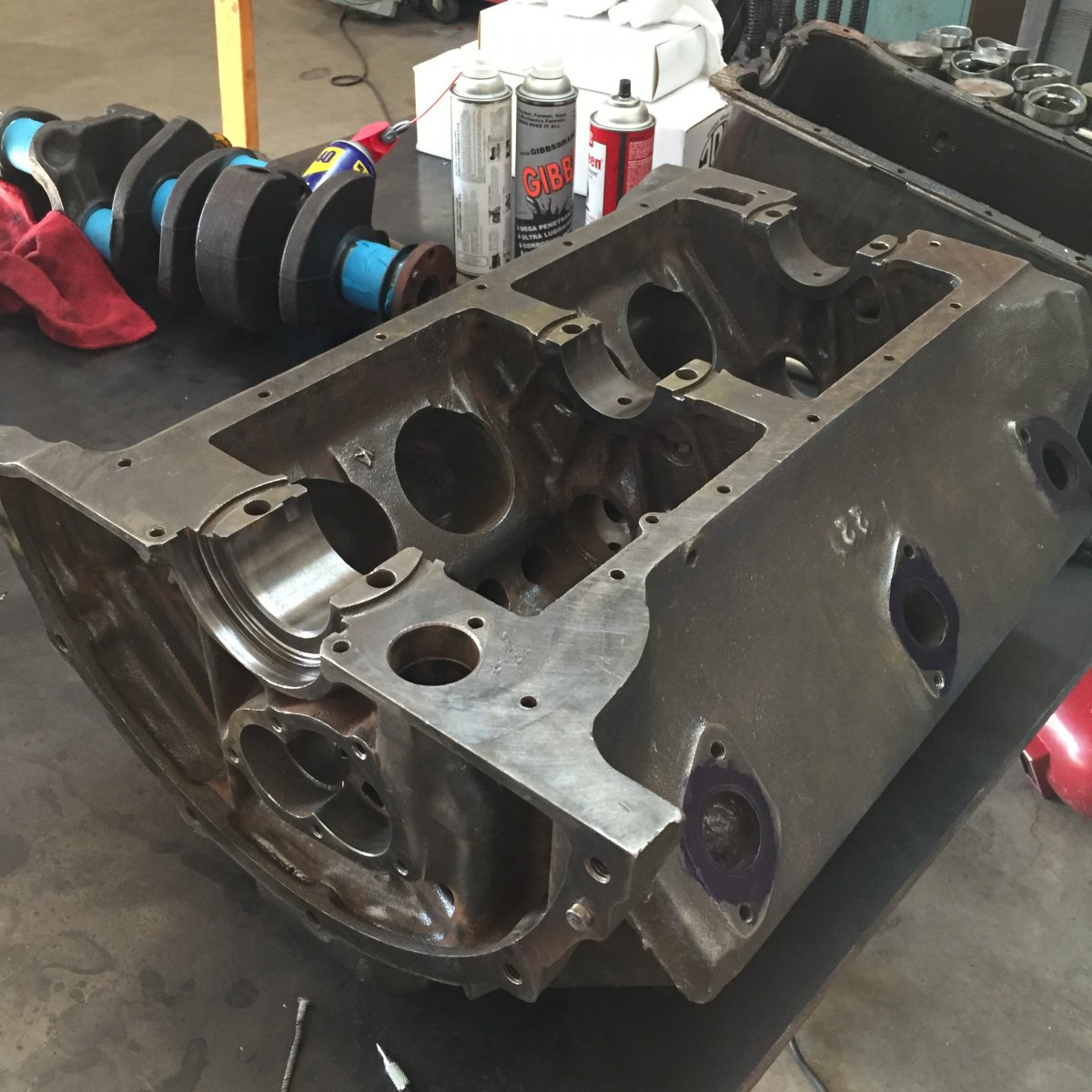

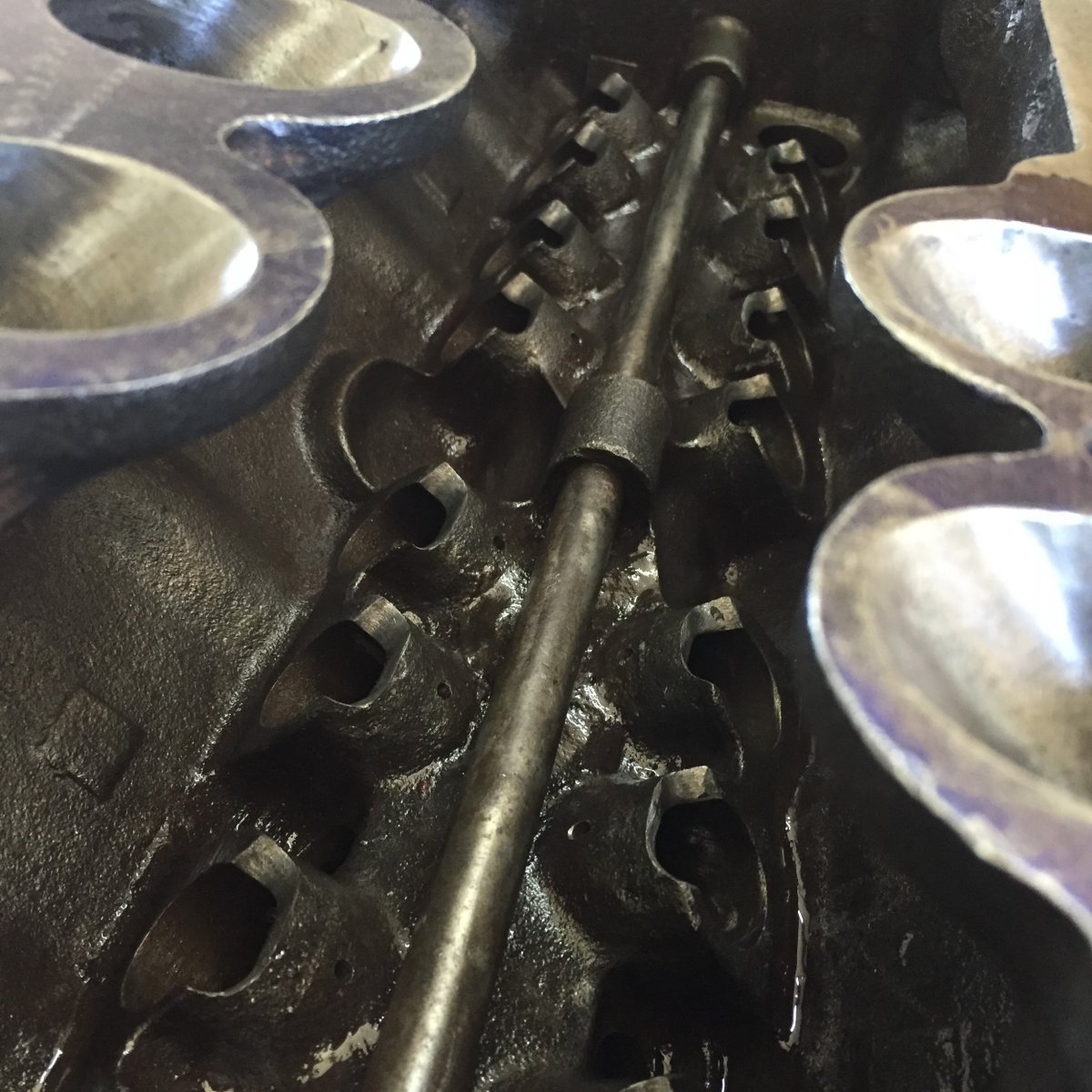

    nice build,i'm doing kind of similar but a -31 pickup.
    What measurments for the notch and hole for the lifter bore, i have read a thread but i cant find it.

    Thanks man. The notch is about 3/16” of inch. The holes are drilled 1/8”

    Man that firewall looks good. Looks like a mirror!
