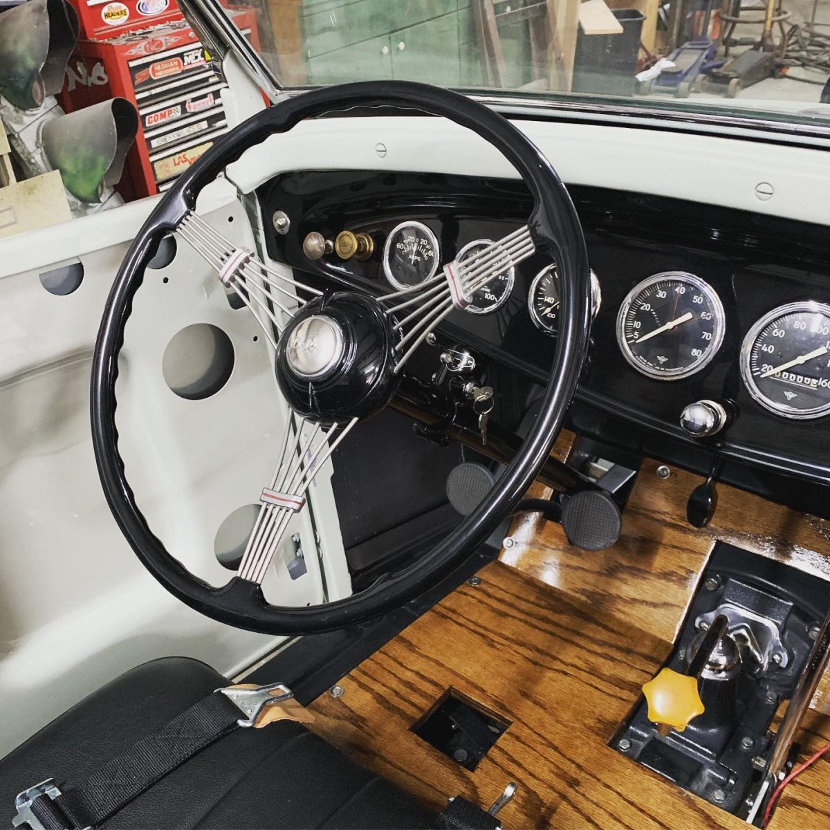

    Got my floorboards stained and installed. Still have to make the covers for the master cylinder access and around the pedals and column. My buddy called me yesterday to tell me my seat was ready. Went picked it up. I used a bengels seat frame and he covered it in a black leather like vinyl. After the car is up and running ill drop it off for him to do the door panels and kick panels. Also got my tank, battery box, and fire extinguisher installed. Tomorrow ill finish running the fuel lines and make up the battery cables.

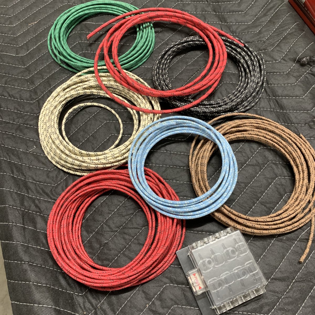

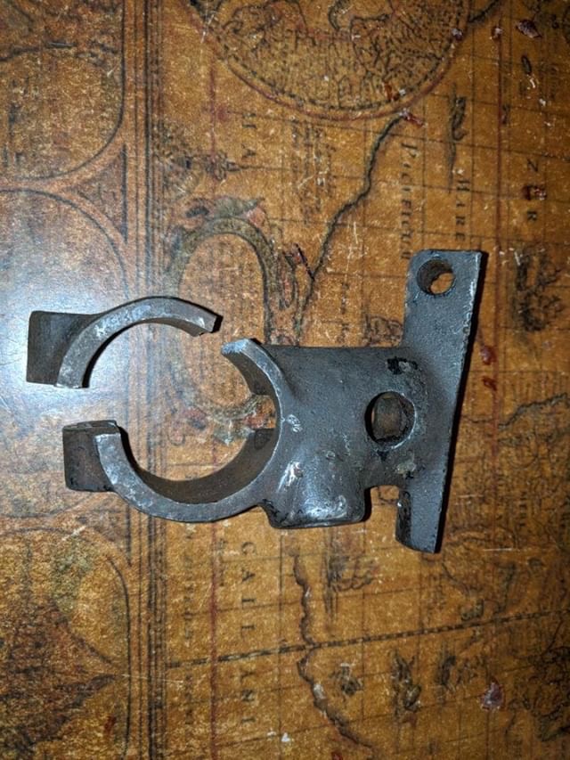

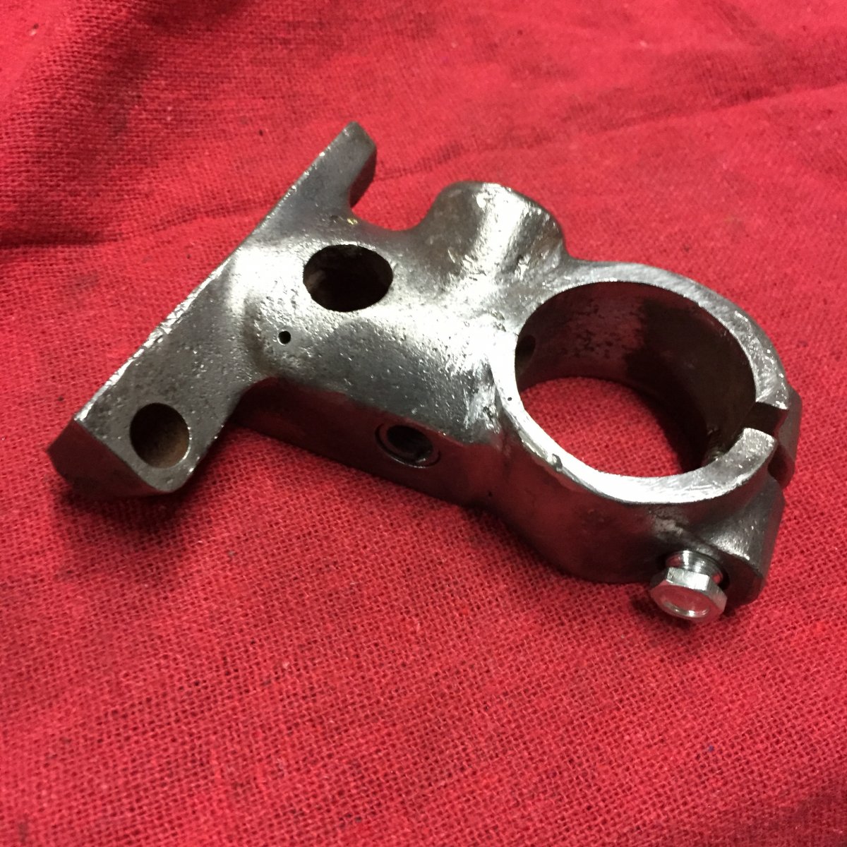

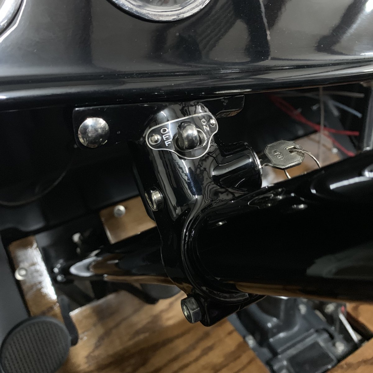

    Started wiring the car this weekend. Used all cloth covered wiring from Brillmans. They have a great selection and good prices. Also got the 32 column drop that i got from @louisb painted and rebuilt. it was broken at the column mount. I tig’d it back together with an iconel rod. I used a kit from thirdgen auto to rebuild it. Painted it with a single stage urethane. Got it mounted up, and installed my 39 banjo steering. My little one is ready for a rip around the block! Hopefully ill finish up the wiring this week.
