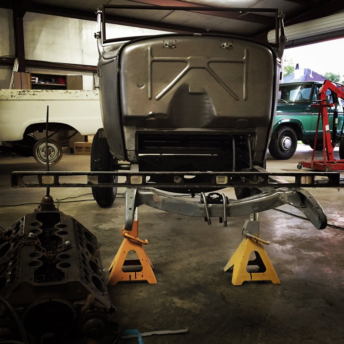

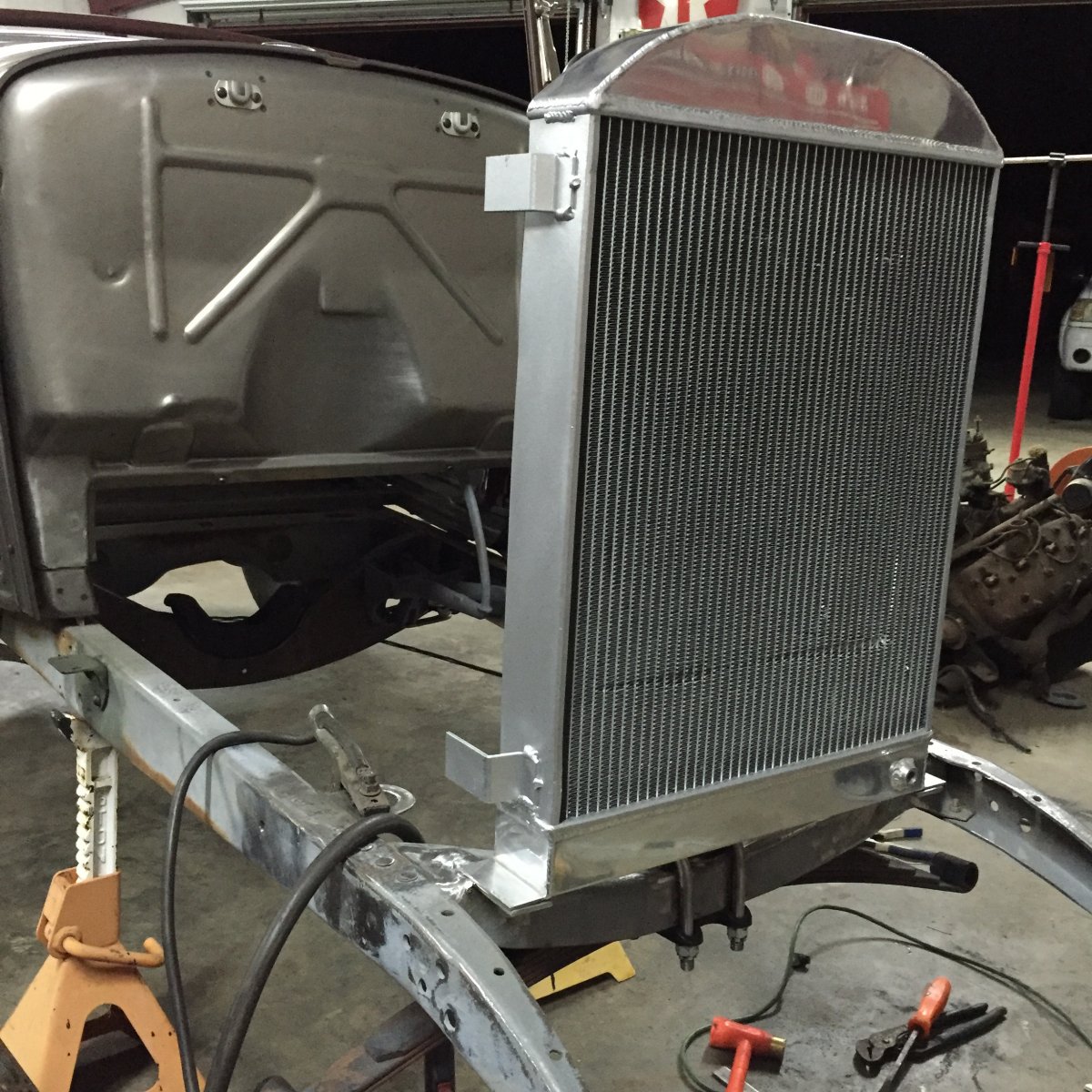

    I am building an AV8 in similar fashion. I like the way you add the radiator mount extension. I will have the same problem as I am planning on running a blown 8BA. My front crossmember was bolted in when I purchased the frame. What would happen if you moved the crossmember forward vs adding the extension?
    Stogy likes this.
  26. 1-SHOT
    Joined: Sep 23, 2014
    Posts: 2,903
    1-SHOT
    from Denton
    Years ago we used the spring shackles to move our radiator forward 74BBEE63-172A-4715-9EE5-2264A1A975F9.jpeg 92FEFA72-95B8-4468-8722-6DD706E2688C.jpeg
    Darkhorse, Stogy, WTF really and 6 others like this.
  27. lodaddyo
    Joined: May 5, 2002
    Posts: 1,263
    lodaddyo
    you would lengthen the wheelbase
    Stogy and 48fordnut like this.
