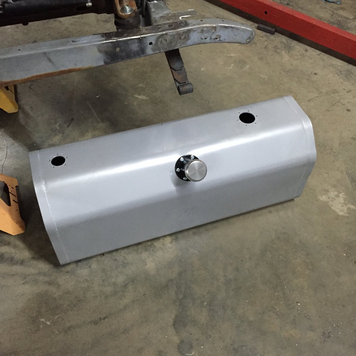

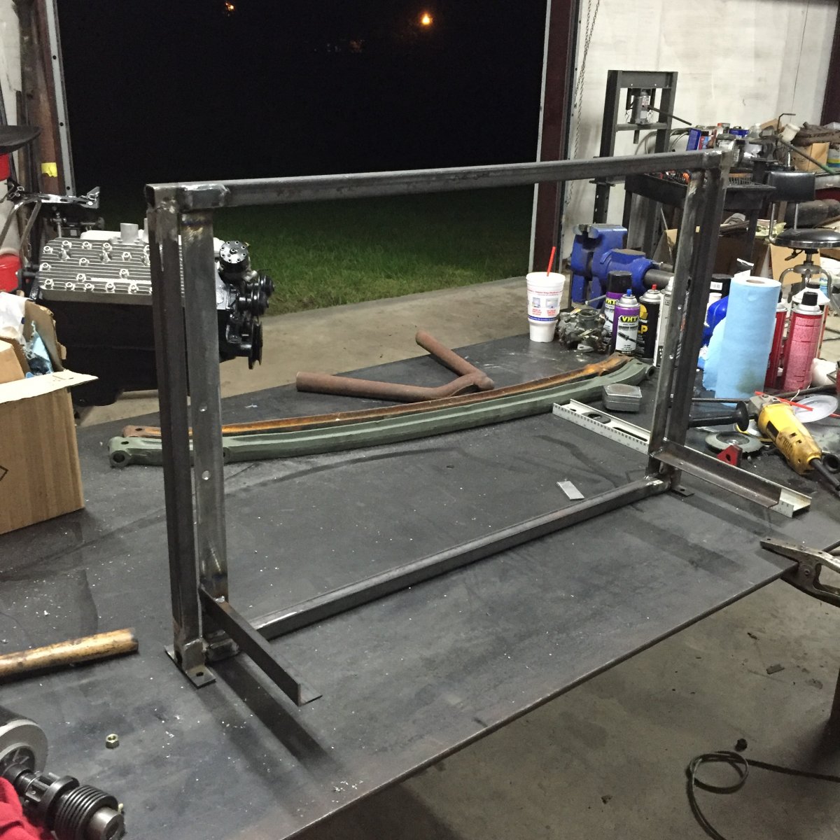

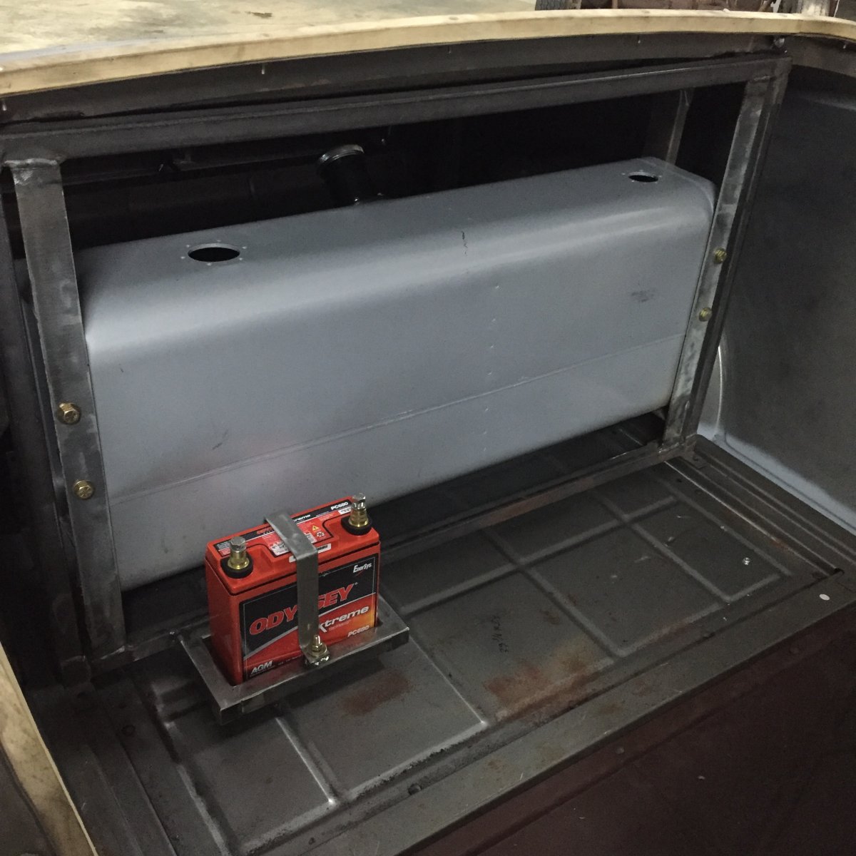

    Worked on the gas tank and battery box tonight. Im using a "tanks" 17gal universal tank mounted in the trunk. Decided to go with the Odyssey pc680. Fabbed up a mount for the gas tank that ties into the subfloor and anchored at the top to the quarter support. Should be sturdy enough. Made a box and hold down for the battery.
    Made the Rack for the tank out of 1" square tubing
    Battery box
    I need to get a piece of sheetmetal to make a bulkhead between the tank and battery. Im happy with the way it turned out
