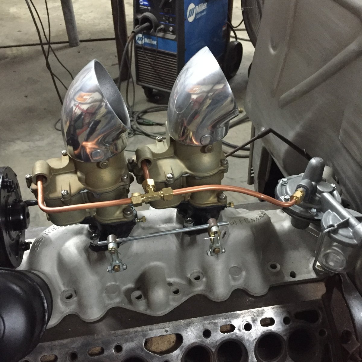

    Working on fuel lines this morning. Been to every auto parts store in this town. No "ford nut" carb fittings. I figured our local napa would have it. No dice. image.jpeg

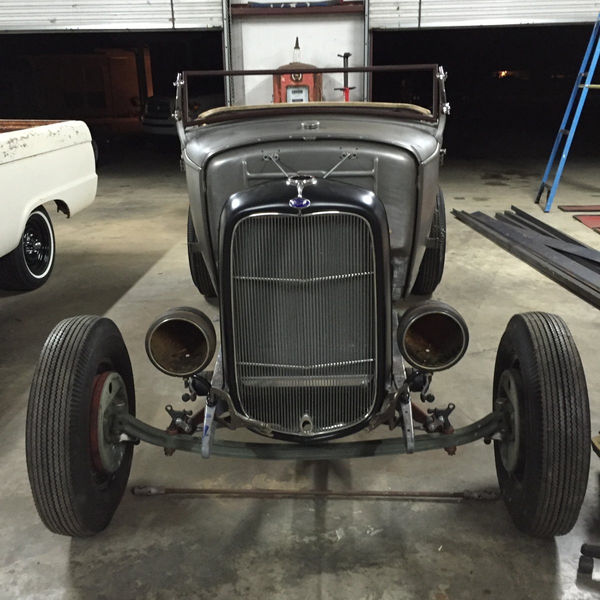

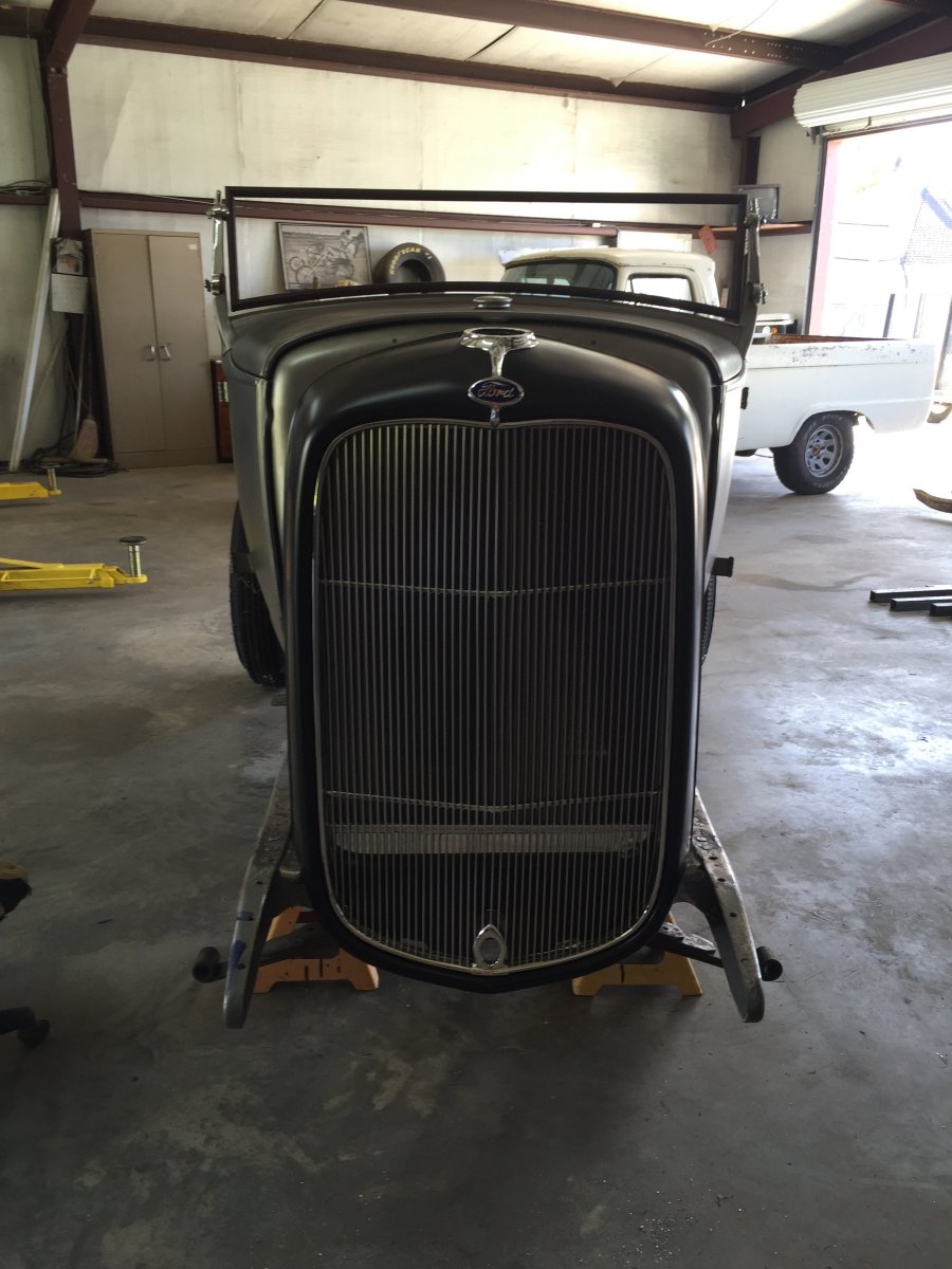

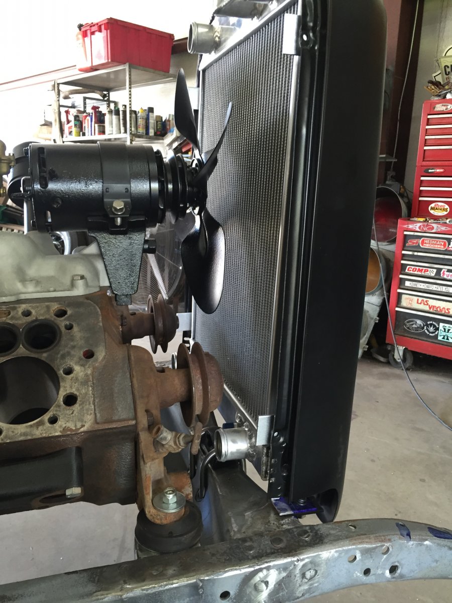

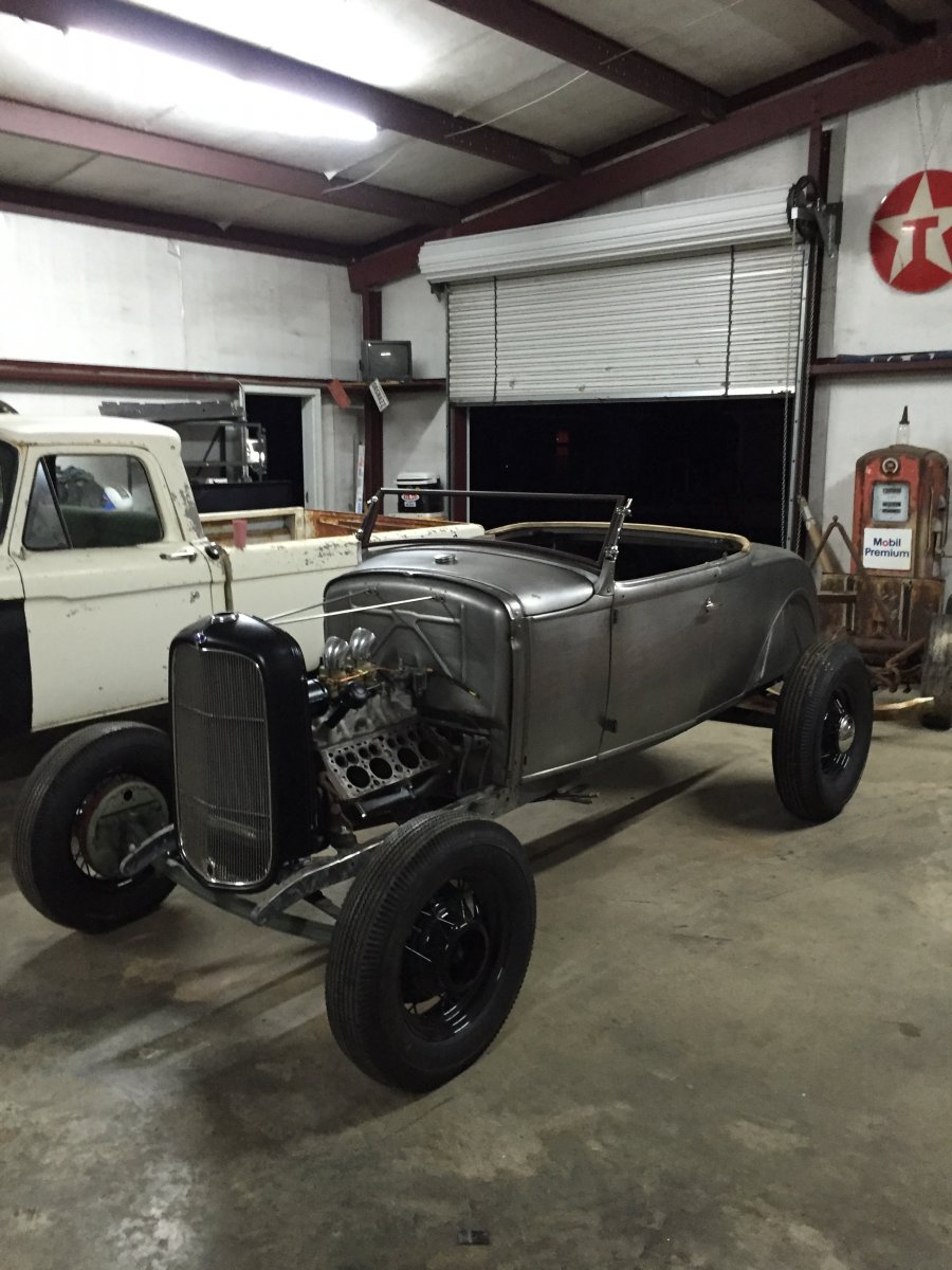

    Not much progress lately, i did weld some new brackets on my radiator, which had to come up one inch for fan clearance.
    Ordered some lower hoses from AULIZ here on the hamb. Had to trim an inch off the ends but they worked perfect to make the connection
    Grille shell mounted. Looks pretty good

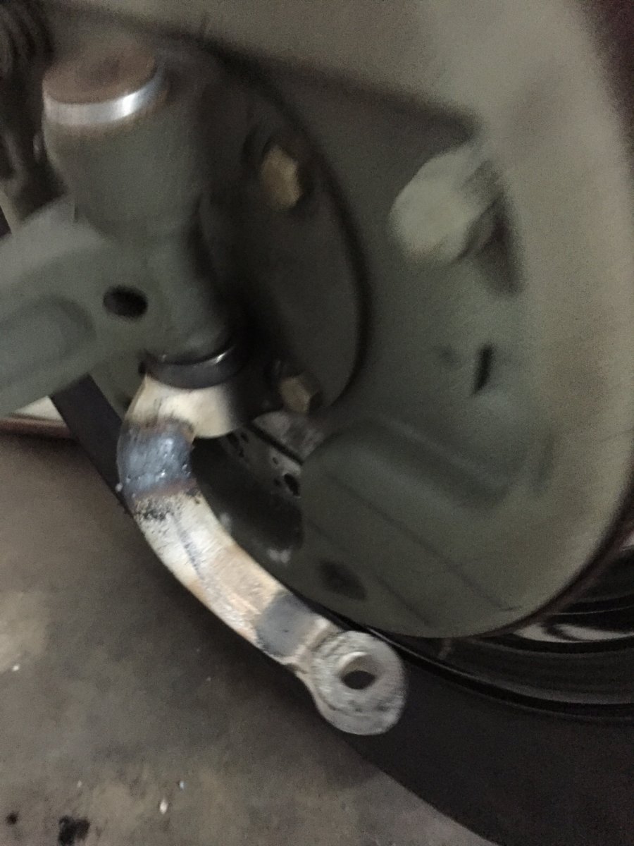

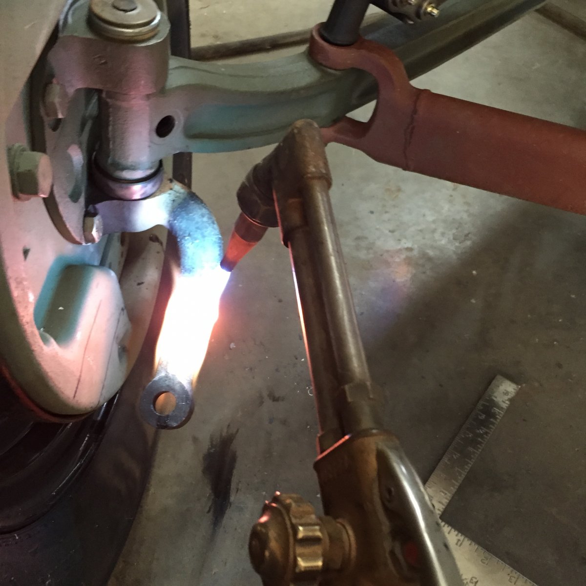

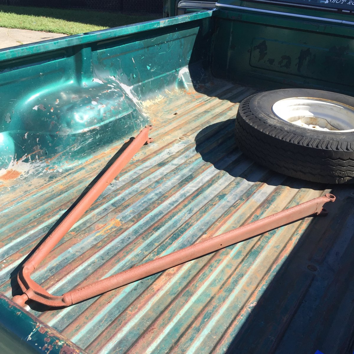

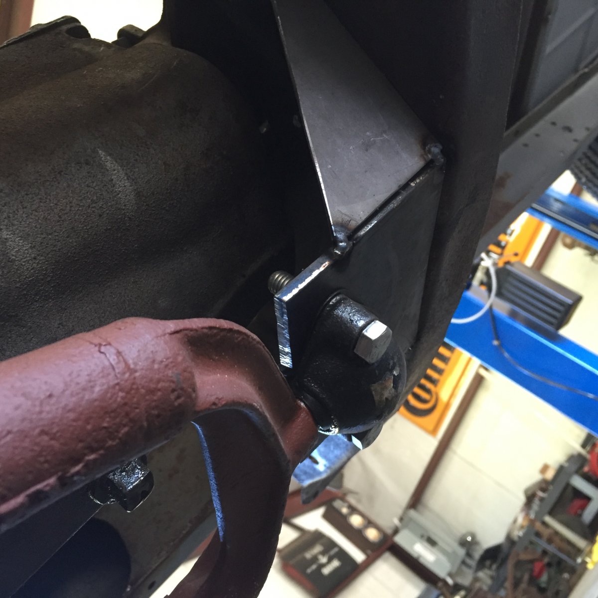

    Made a little progress lately. Ive been hunting for a 33/34 front wishbone for my suspension. I knew the 35 i had wasnt gonna work fo what i needed. I was lucky enough to track down one here locally. Made the deal and went picked it up.
    Got it installed on the axle and put it all back under th car. Fabbed up a bracket off my f-1 trans crossmember to mount the ball. Ill finish welding it when i pull the body back off
    Had to drop the steering arms to clear the wishbone to run the tie rod underneath. Not sure if i did this the right way but i took measurements and scribed some lines on the backingplates and made sure everything lined back up
    When i put the front axle back together i used a super low reverse eye front spring. Hard to tell in the pic but it lowered the front a good bit.

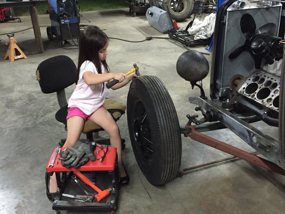

    My little helper (in high heels) working on my tire.

    Did your little helper overhear you talking about installing a nailhead?
    Randall, lodaddyo and Dannerr like this.

    Lol, no nailhead talk! She just like to weild that hammer!
