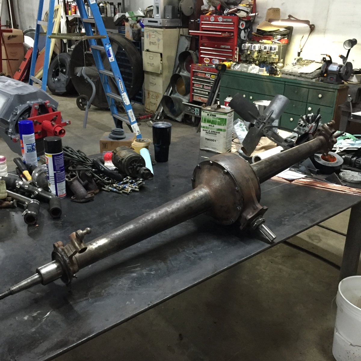

    Little update, started working on getting my banjo together. Got the pinion ***embly in the housing, set the pinion pre-load and got it locked down. Takes about 15in lbs to move it. Next up is to put it all back together and set the back lash.

    Got the banjo together and ready to go back under the car, anxious to see how it sits with the new reversed eye rear main spring
