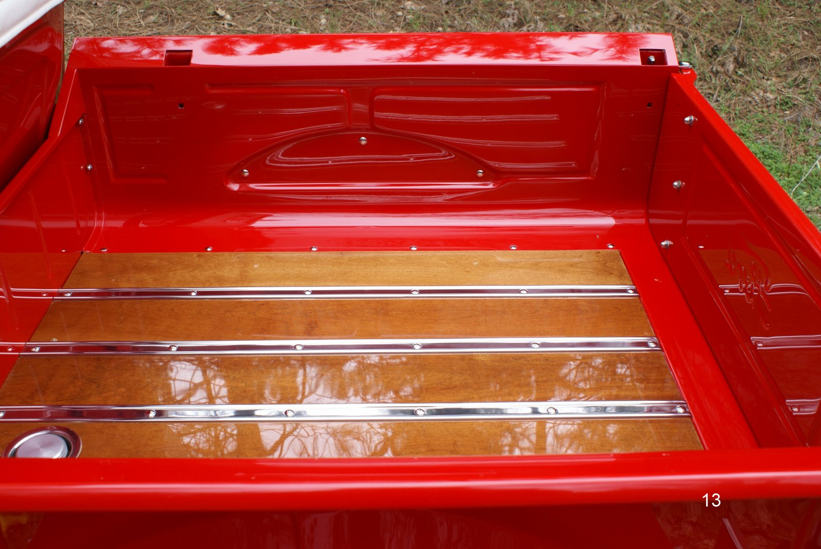

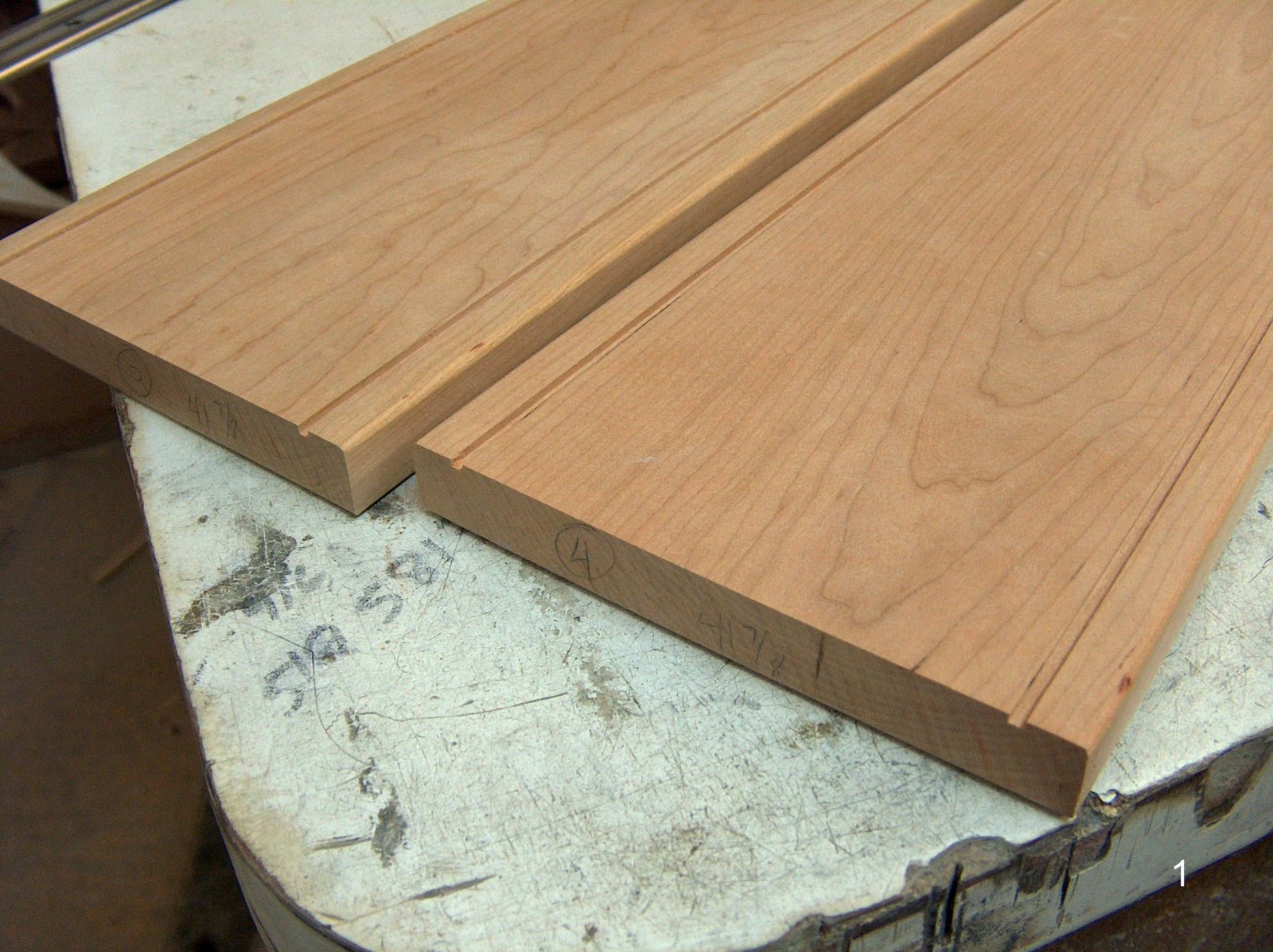

    I chose cherry wood for my bed.
    Pictures #1-2-3
    After rabbiting my wood for the un-drilled stainless strips, I decided I didn't like the open ends, so I welded them up to get a more finished look.

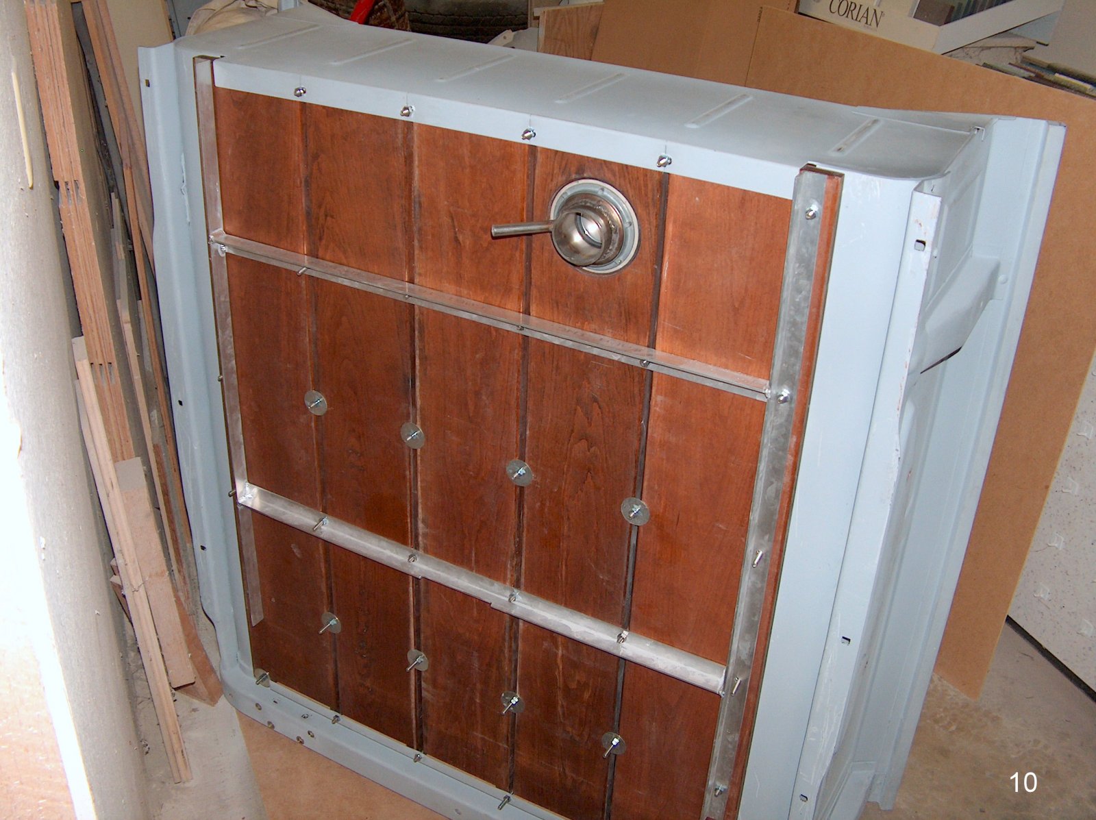

    Pics # 7-8-9-10

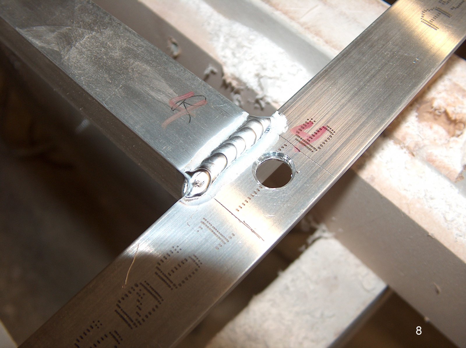

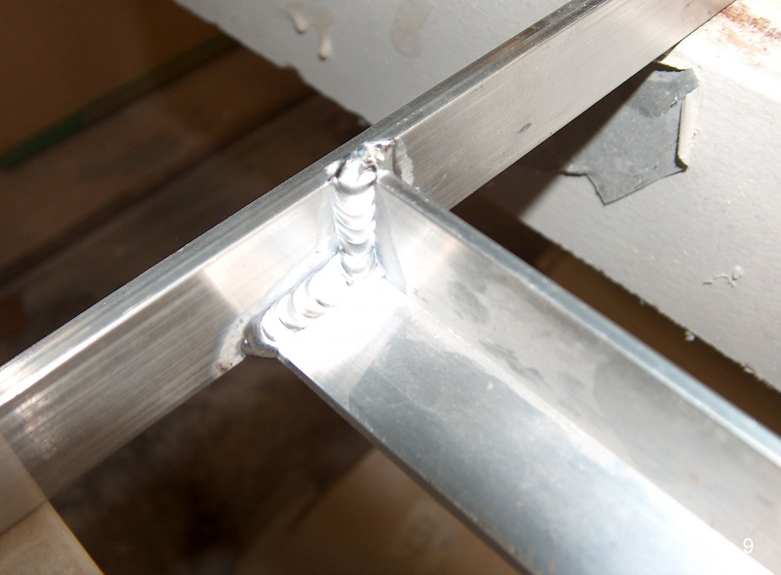

    I used 6061 1 1/2" angle to support the wood and give a place to bolt the strips. I did another trial. fit before final trim

    Pics #11-12-13
    After the trial fit I decided to rabbit the edges that go under the bed sides. I figured it would help to keep the metal

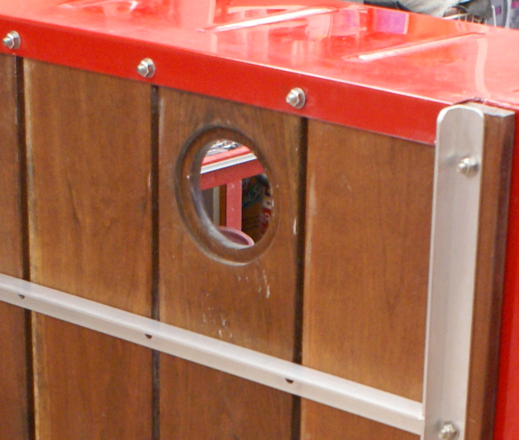

  14. willys36
    Joined: May 6, 2006
    Posts: 3,462
    willys36
    Looks good. I did the same for my '53 Chevy pickup and '59 Elky. Used iron wood on the '53 (super durable and weather proof and looks like dark walnut) and tiger wood for the Elky. Bot are common deck wood and really weatherproof and pretty to boot.

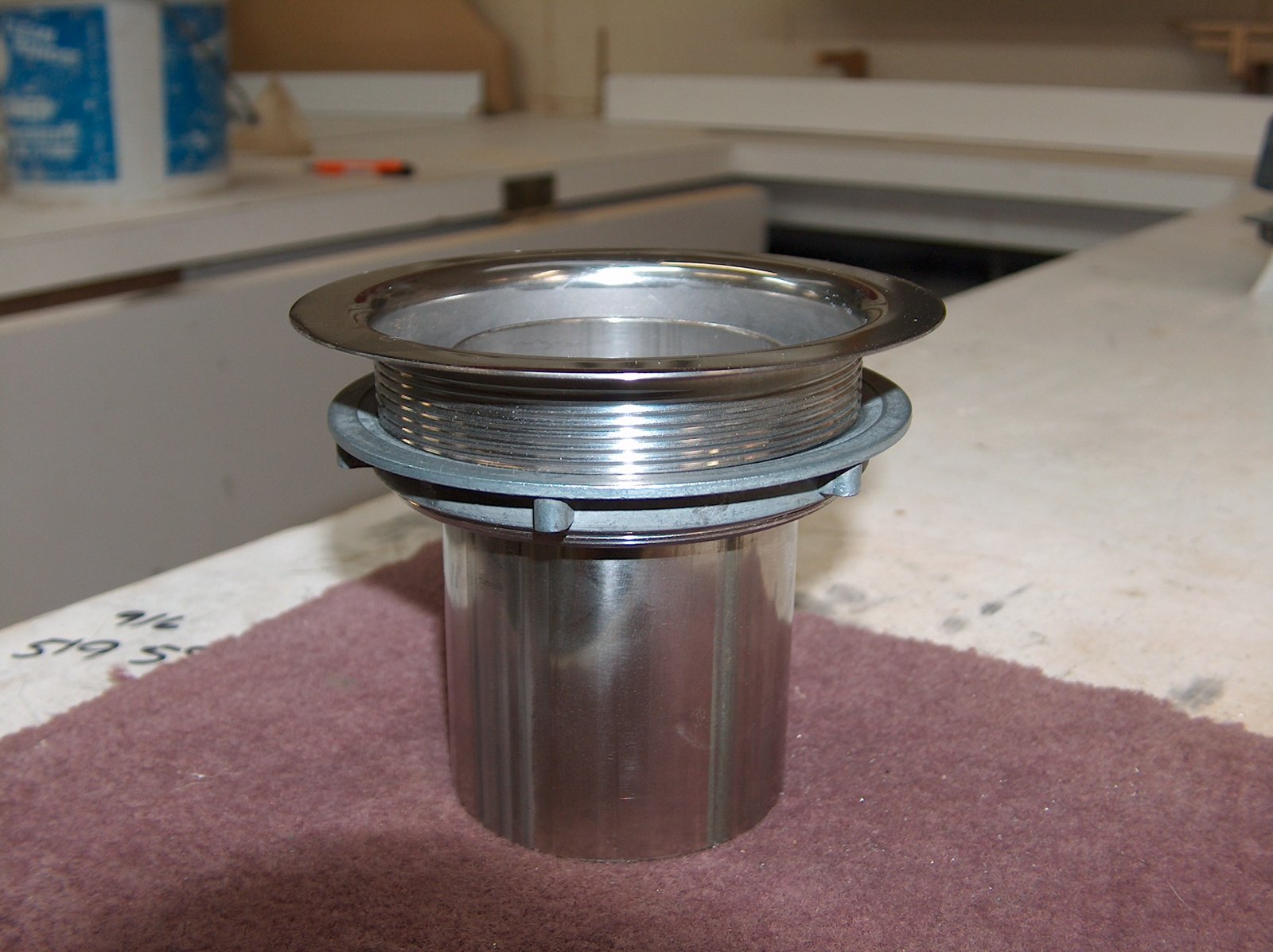

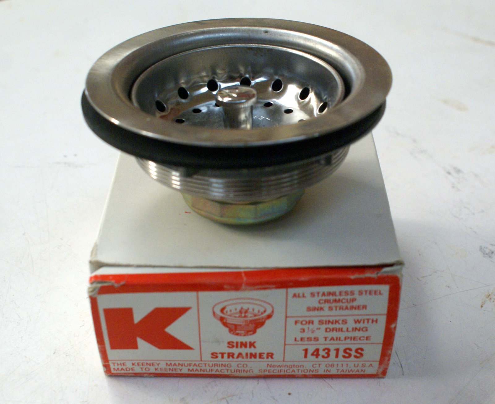

    Blake,
    This looks great, nice work! Where di you get the through wood fitting for the fuel filler? I need something like that for my 55 chevy 3600

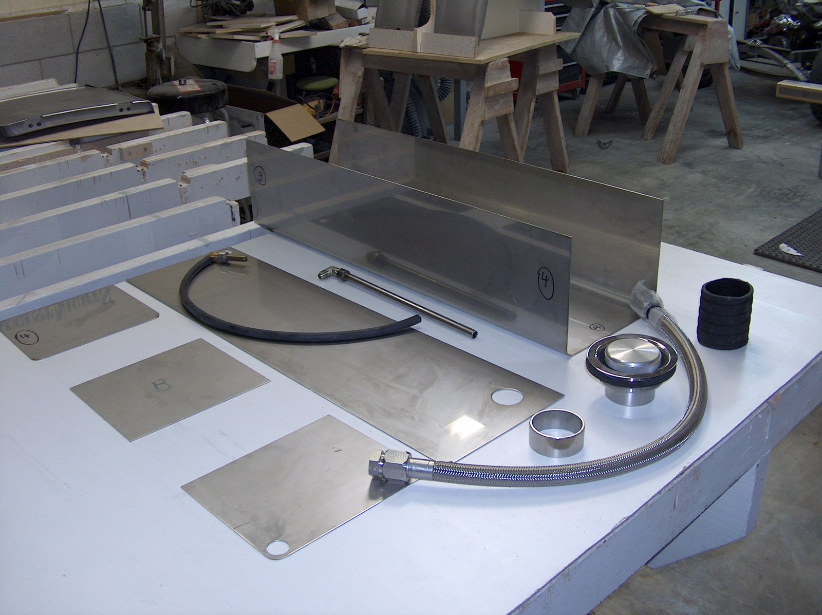

  21. Blake 27
    Joined: Apr 10, 2016
    Posts: 1,568
    Blake 27
    I used a kitchen stainless sink drain, with Rock Valley filler neck and cap, https://www.rockvalleyantiqueautoparts.com/products.htm. I added a drain tube in the cup (gas spills ETC). 1.JPG 2.JPG 3.JPG 4.JPG 5.JPG 6.JPG

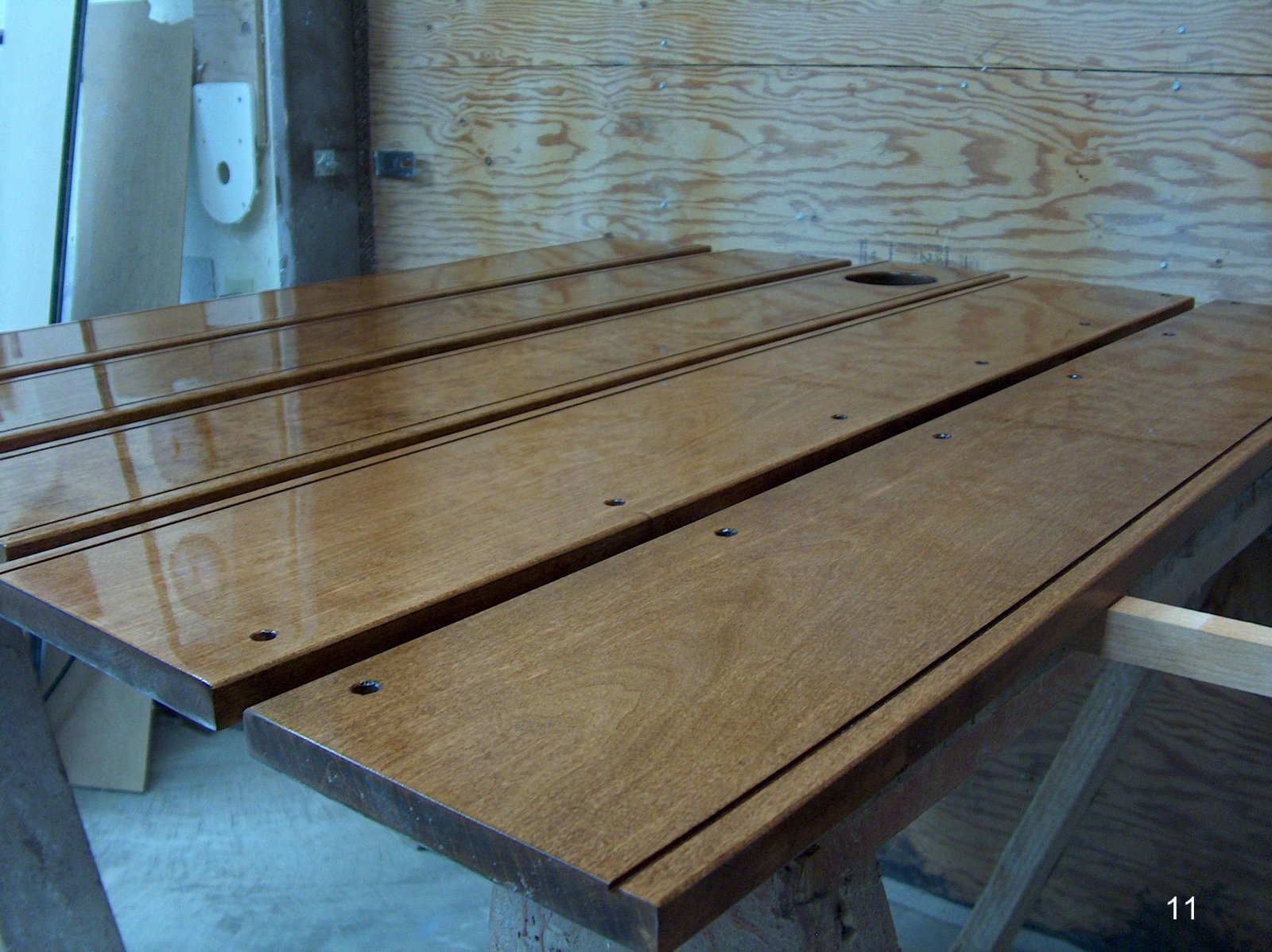

    What did you use for clear? Looks magnificent!

    This was recommended by a PPG paint rep. It's held up really well, 9 years exposed to direct sun, and 6 more after I built my bed cover. DSC04331.JPG
