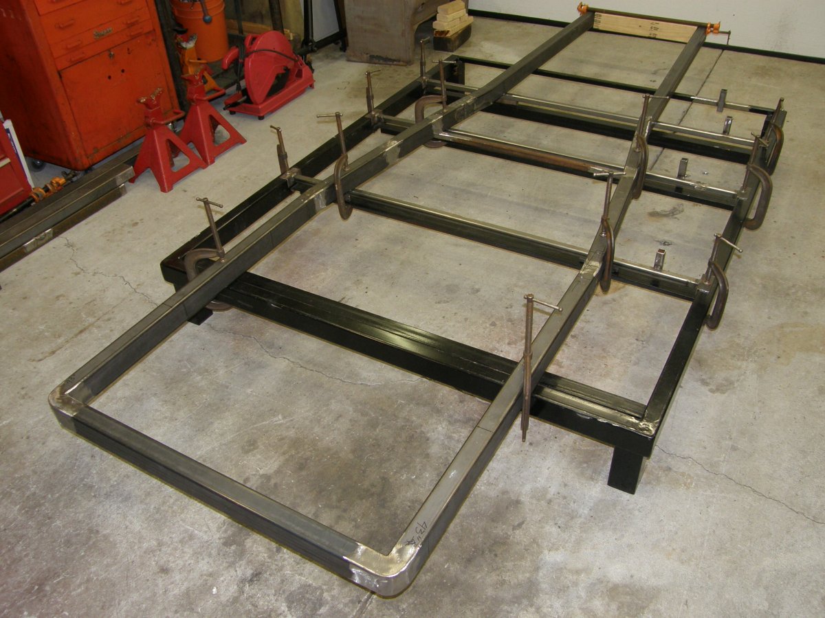

    As stated, you need a solid/straight frame structure to build on and the chances of getting that 95 year old subframe perfectly straight are slim and none. I had the same dilemma on my roadster. Wound up building my own frame. $200 in 2"x3" rec tubing and a MIG welder solved the problem..... P4280008.jpg
    Once the frame is built you can focus on the body panels. From the looks of your pics, your left bun panel took the brunt of the force. I think you'd be better off just replacing it. The bun panel can be made fairly easily. It just so happens that '80s-'90s Chevy van hoods are the perfect candidate for makin a '26-'27 bun panel. The hoods run about $40 at Pick-N-Pull and one hood is enough for two panels. Also, Howell's carries the lower patch panels for $80 a pair. I posted a step-by-step how-to in my build thread. It starts on page 3.
