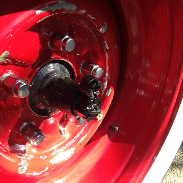

    I'm not really bragging. The friend that rebuilt my '40 Ford banjo diff. who will remain anonymous because he wouldn't take more than what I think must have been minimum wage from me and doesn't want guys breaking down his door advised me to get the '47-'48 Ford big axle nuts. He mentioned that Don at "Dons Antique Auto Parts" in Niles Ca. should have them. At the time I wondered what the difference could be and why I should go to the trouble, but thought it might be a good chance to visit Don. Don is quite a character at the Bay Are Swaps for as long as I can remember and I am 70+ myself. He must be in his 80s. I found his phone # on the internet (Just google the above) and called him. He said he had some but thought they were put on Merc's and Lincoln's. He wouldn't quote a price but said it would be reasonable. When I got there he said that I might be right that they were used on '47-48 Fords. Guys if you ever get a chance to visit Don do it. What an interesting guy.
    Anyway after I got the "big nuts" home I figured out what the big deal is. The small older axle nuts are 15/16th in diameter and the last 1/4 in. is turned down to about 7/16th and distorts so the last few threads really don't do much. The big nuts are 1 1/4 and have strong threads all the way to the end and with torque of 150 lbs + you need all the strong threads you can get.
    The small nut is laying on top of the BIG one.

    Really George if your running a banjo rear the BIG NUTS give you about 4 extra tight strong threads. It scares me to death putting 150+++lbs torque on old worn axles threads.

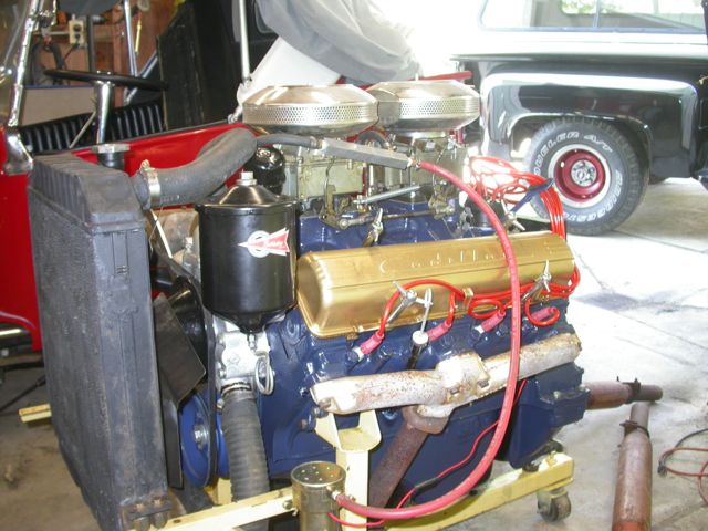

    I saw this bitchen stock green '40 Ford at LARS a couple of years ago. The only thing I could see that didn't look stock was a small V on the speaker grill. I saw it later at So. Cal. Speed shop with the hood up. It had the same engine that my '48 has. The little V was a Cad. emblem. Looking under it it had the banjo with heavy overload springs and a crate of Mason Jars in the trunk. Wish I had taken some pictures of it.
    Gary

  18. Geezzz, can't believe I opened a post about Big Nuts. Once I started reading I relaxed a bit. I got to the part about late axles and looking under cars and then I knew I was in good company. I do the same thing and I agree in most early Ford's a Banjo rear is a must. I've also had the Key way Blue's. In most cases looks mean more than how it works. I wanted more without it looking wrong so with some help I went to 28 spline 9" truck axles without cutting the bell flange off. I was able to retain the Stock spring hanger as well as the 4 bolt flange so my rear bones and Ford tube shock mounts still bolted on as if stock, and they are. No fabbed brackets welded to my Bell end housings. My next move is to machine the early rear hubs so I can add them to the 9" axle flange so it still looks stock from both underneith and at the front side of the wheel. I'm getting there and I'll add those "Big Nuts" to the threaded ends as if they still were holding my brake drums on.

    man, I got some serious air cleaner envy now! I've been wanting a pair of those for some time now, nice! The guy who sold me my car thinks it had 3.78's in it. It's supposed to be the "family" hot rod, so if they are, I wont change them, but for most of my driving running around town here, it wouldn't break my heart at all if it had 4.11's in it. Honestly, with the weight and 29.5" tires with 3.78's, I am worried its going to be pretty gutless.

    You know George I found those air cleaners on evilbay. In fact I found the engine the same place. My roadster has 3.78's, and they are perfect for a light car. You will like them in your '39. If I ever have to tear my '48s banjo apart I think I'll put some speedway 3.50s in there. It'll probably feel like taking off in second but it'll be nice on the highway.
