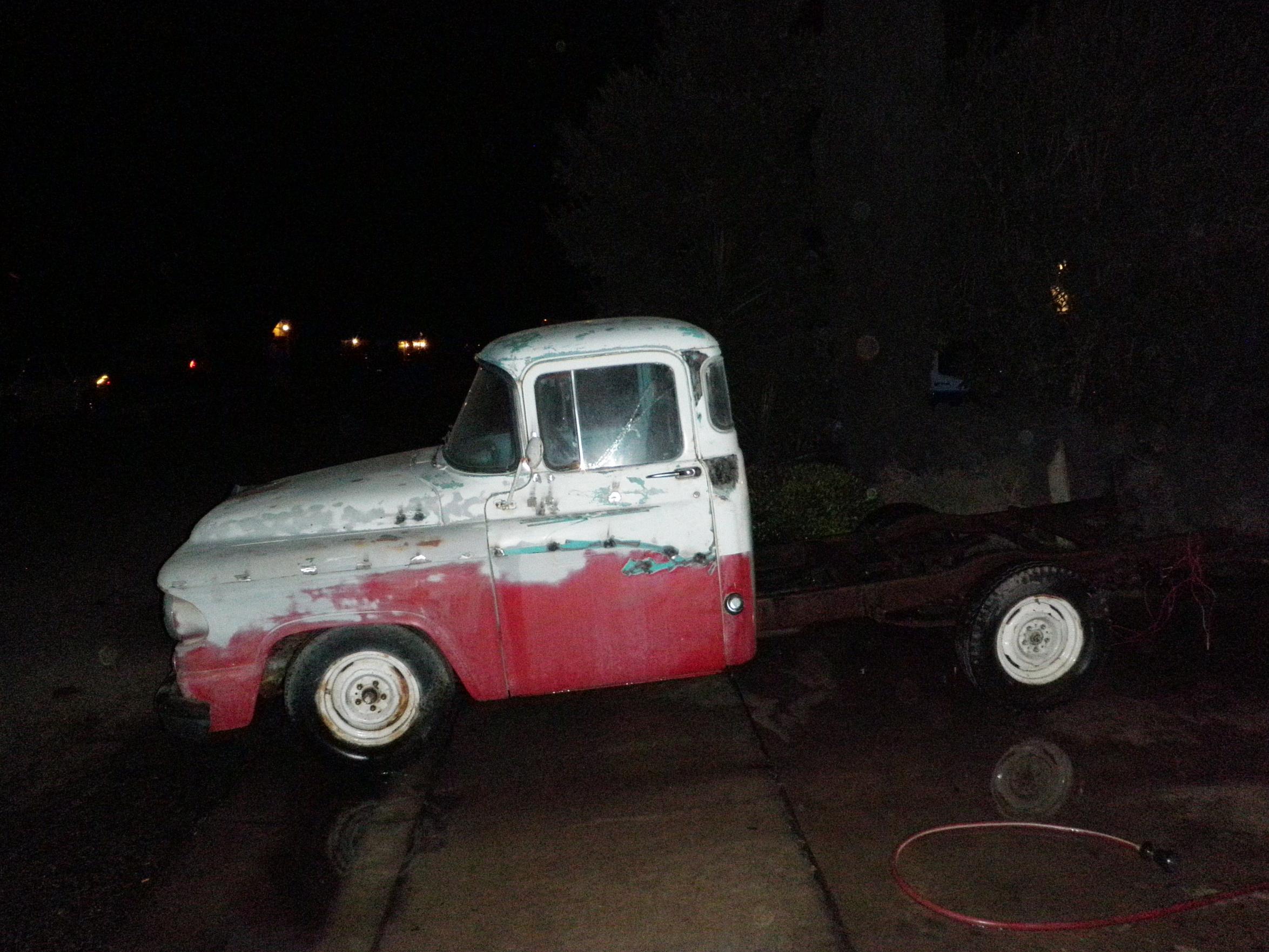

  24. newsomtravis
    Joined: Jun 1, 2009
    Posts: 562
    newsomtravis
    from pville, ca
    no pics of the progress tonight, nothing really to show, got the frame marked out and partially cut on one side......driveshaft removed for cutting tommorow at work and thats about it, will try to get some pics tommorow night when i cut the frame the rest of the way and begin putting it back together.....
    yeah ebbs......gonna put a dual circut master in it out of a later model full size sedan....used one in my 55 dodge.....bolted right up.....the one i used was out of like a 70 belvedere.....workked good....also a couple down the road gonna get a disc kit from scarebird to convert the fron to discs......and figure out the seatbelt thing.....too....thanks
  25. newsomtravis
    Joined: Jun 1, 2009
    Posts: 562
    newsomtravis
    from pville, ca
    pics from tonight....check em out.....let us know what ya think....ended up maring and cutting frame, took 6 inches out of the wheelbase making it 110 inches and bobbing the frame 11 inches, so, truck will have about a 6 and a half foot bed.....should be close to what an original shortbeds dimensions where.........we`re liking it and having fun.......

    pics
      502 KB
      144
      504.4 KB
      136
      517.2 KB
      101
