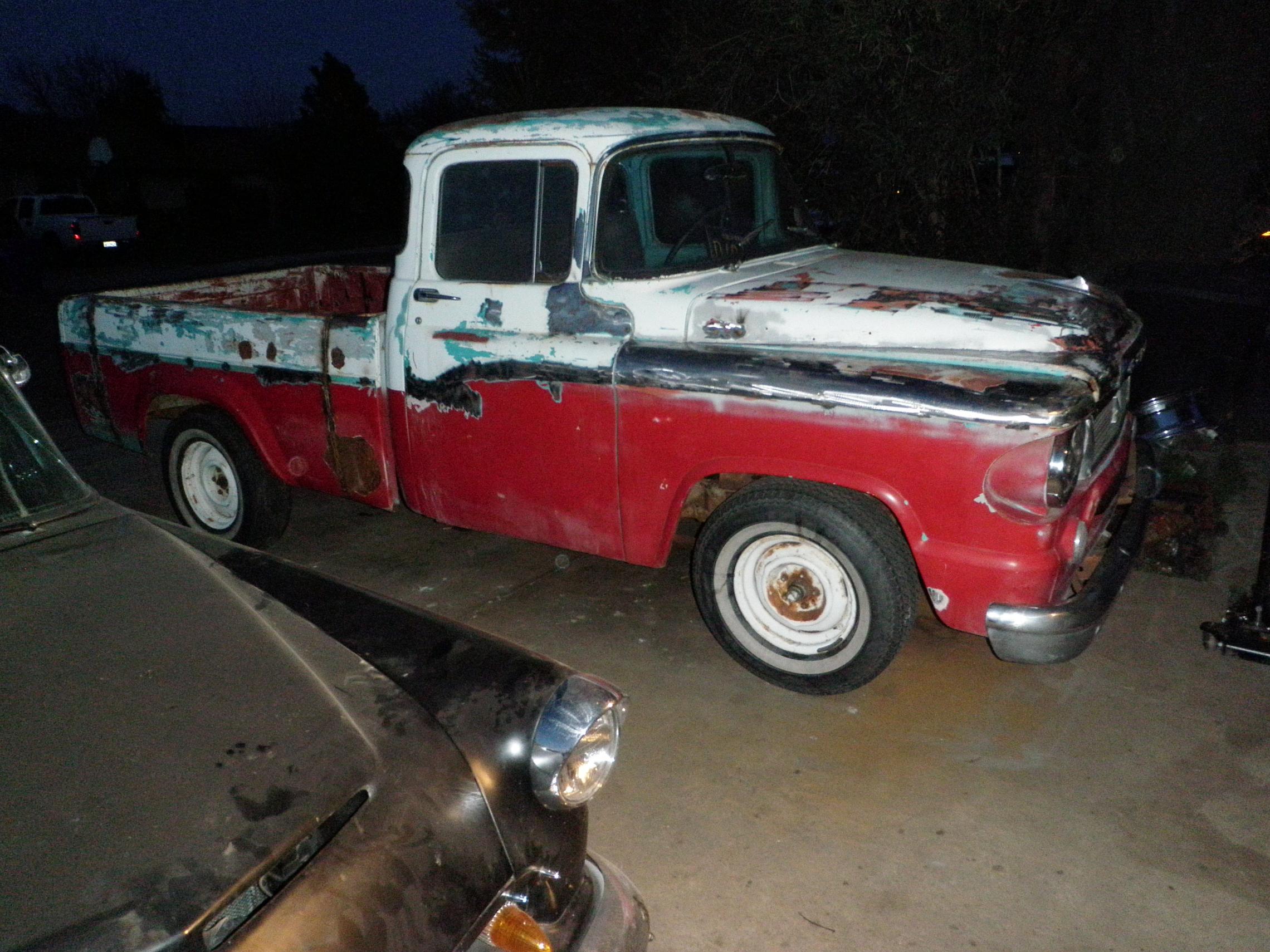

    been a few days, here the latest, got the front half of the bed cut, took out 6 inches, got it tacked back together, got the frame put back together, driveshaft shortened, and the back half of the bed started cutting, will probably reinstall the bed to finish the back half cutting and welding, running out of room around the house........anyways...check it out
      487.5 KB
      114
      497.2 KB
      135

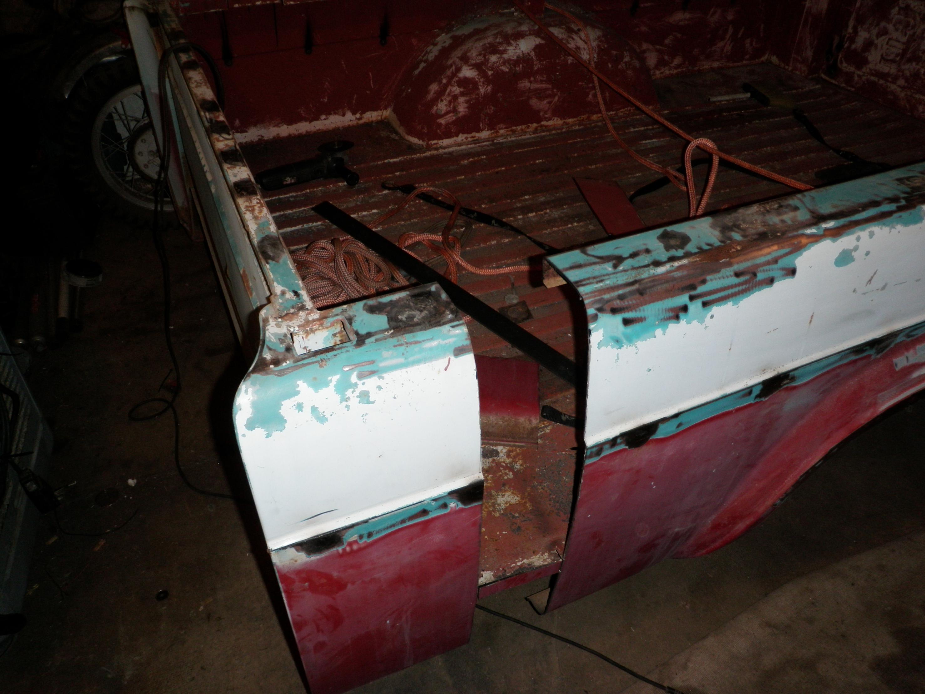

    and more from tonight, now a shortbed
      493.6 KB
      123
      500 KB
      148
      496.4 KB
      169
  6. newsomtravis
    Joined: Jun 1, 2009
    Posts: 562
    newsomtravis
    from pville, ca
    ok, so, now its a shortbed, has dual circut brakes with a brand new master, runs and drives prettty good now, will try to post some more pics later......ran into a recurring problem last night though....took her on her first more than 2 mile drive, ran perfectly drove real well, but got there and it wouldn`t start again, the starter is in bad shape and drags down so bad it won`t turn the motor fast enough to start, been trying to find parts, but very little luck, anyone here have any ideas on some kind of upgrade that can be done........any help would be appreciated.........thanks its a poly 318 with an automatic

  21. Just a heads up.. BOX PLATES!! I see that you know what you are doing.. I see plates on the inside but it is hard to tell what they are there for. I know what they are and the guys that have done frames know, but, Some others on here may not know.
    I have cut up a lot of frames . Many long to short bed. I had an older frame guy walk me thru the first one when i was 15. He had me make the cuts at 60 degrees and plate the inside. This made a very strong splice. The last one I cut. I followed his directions as I had on all of the frame cuts I have done. It was an O/T '84 chevy 1/2 ton. I welded it with my little 110 volt mig. Had a pretty stout 327 / 700r4. I put many miles on that truck and sold it to a friend that loaded it down untill the bumper was almost dragging on the ground and drove it to Pennsylvania. That was 12 years ago and it is still on the road today.

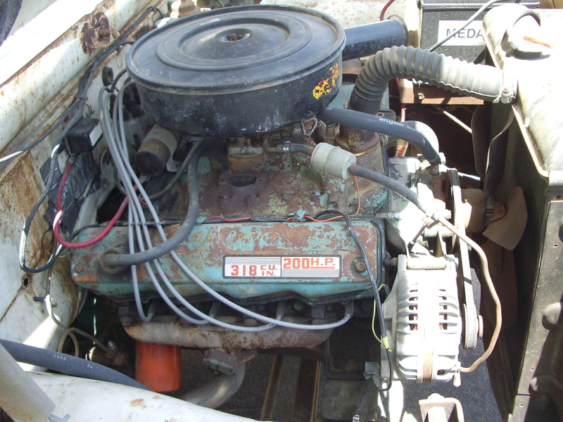

  26. Your poly 318 has more in common with the newer LA 273, 318, 340, 360 engines then it has with any of the early hemis....there is a lot of confusing info on them. The chrysler Poly motors share a lot of the chrysler hemi parts, and the earlyer dodge/plymouth polys (the 270-325) share a lot of parts with the dodge red ram and super red ram hemis. The 318 Poly was the new "A" series engine for '57, before they went to the "LA" series.
    There are a few threads on the differences and the parts interchange. Just wanted to through some info out before someone goes looking for those super rare "318 Hemi heads".
    Here is a shot of the 200hp 318 that was in my '64 dodge. And just FYI, most of the rotating ***embly is the same between the A and LA engines, it is fairly easy to piece together a stroker kit from the after market supplyers. I have seen them out to 390ci and 408ci, mutli carbs, headers and all the normal rodding tricks with modern parts inside the old blocks. They can build great power with a little head work, but build great torque with just a swap to a factory 4bbl intake from the original 2bbl.

    hey tumbleweed, yeah, that would be they way i would and do normally do frame, cut at a 60 or even a 45 degree angle, but in this case it would have been a ton of more work, so, its a straight cut, and instead of boxing, made plates that fit inside the frame in a smaller channel shape, fully welded with my 220 machine, my boss helped, i`ve done a ton of this stuff, but nothing compared to his 50 years, so, i think it`ll hold up......
