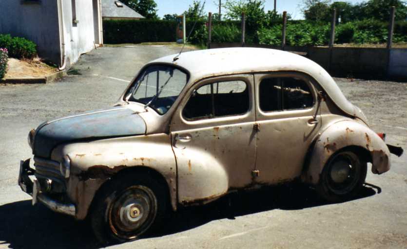

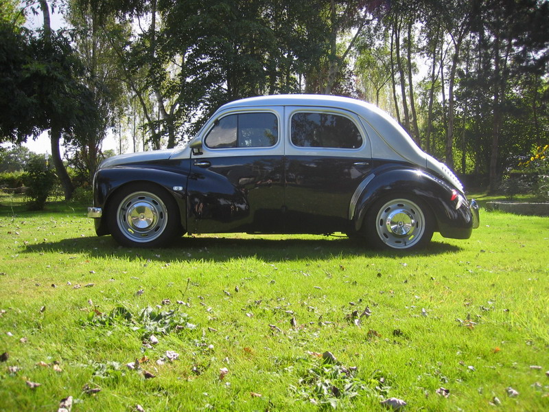

    So, Christophe aka Schoum, french hot rodder, 27 years old....

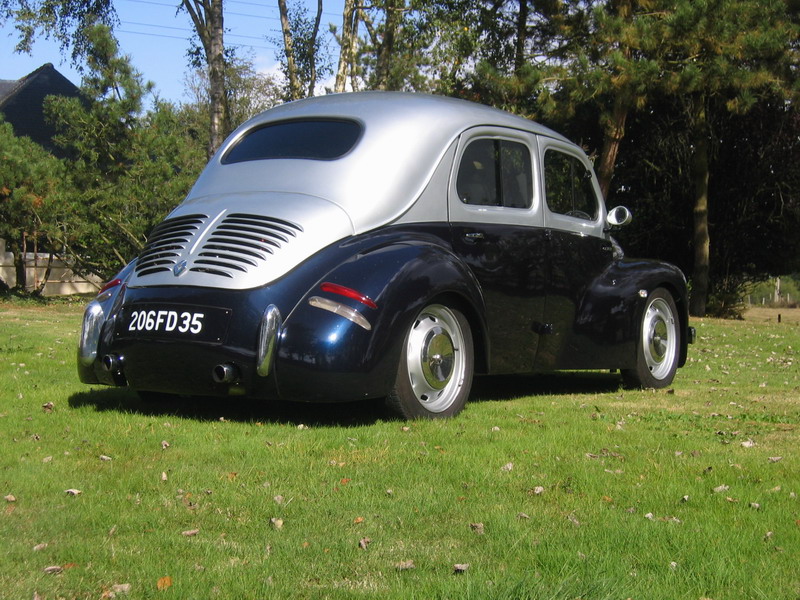

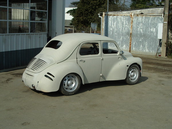

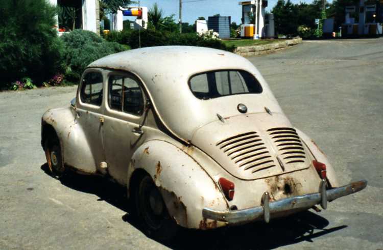

    My first car: a french popular, renault 4cv.

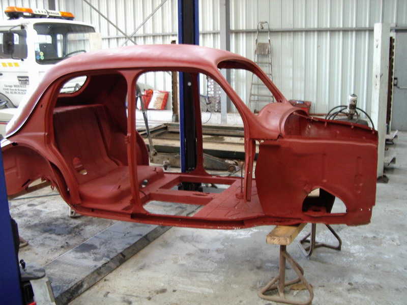

    the base were very very rusty! the body is totaly rebuild and the original engine is replace by a bigger. A renault 8 engine; 1100cc (67ci), new cilinder head with big vavles and home made headers and intake manifoild with a weber 40DCOE carb
    all the rear and front end come from a R8, so, I have 4 disques brakes and a 4 speed gear box
    In this configuration, there is 80Hp instead of the stock 20Hp....
    it's a very funny car to ride...

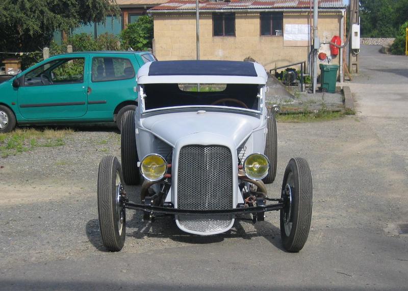

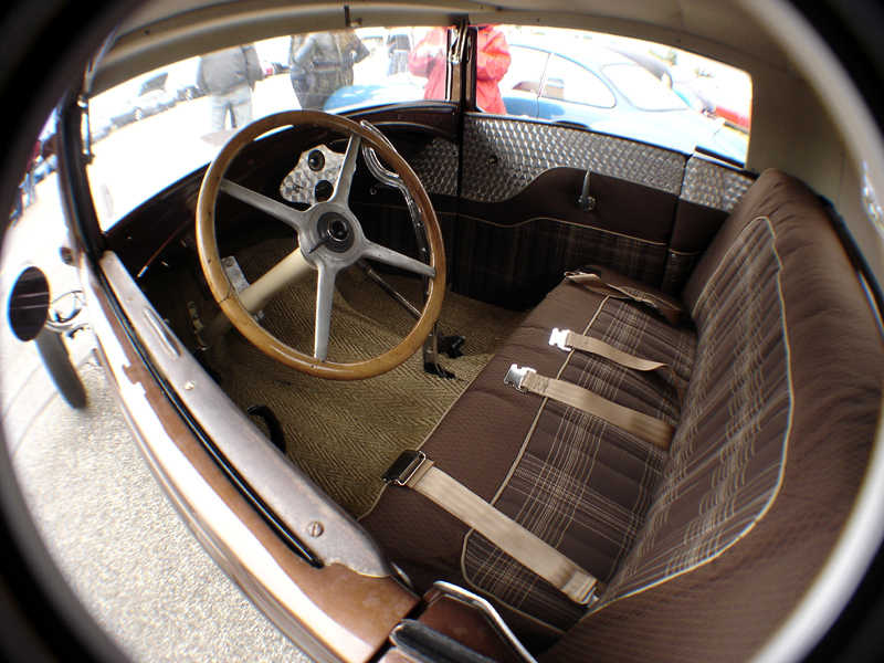

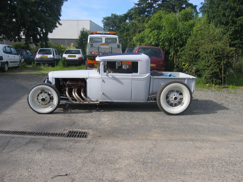

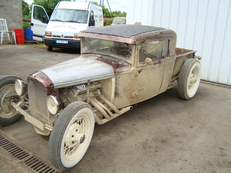

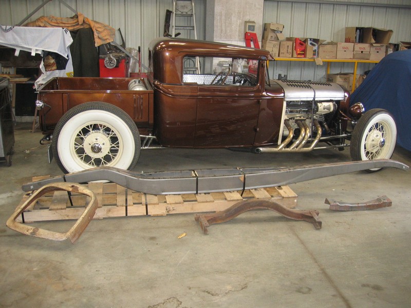

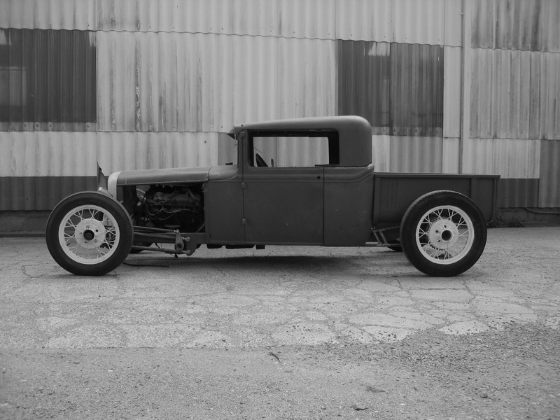

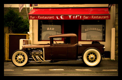

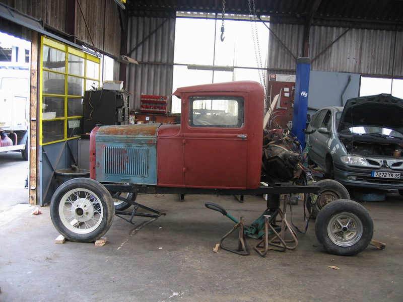

    I continu with my 1st rod, a 1930 A pick up
    I buy the base in south France whith his original french title...
    My job: home made frame, combo 350ci buick/th350, extended cab with hard top, home made bed, home made hood, 32 repro grill, suicide front axle with ford juice brakes, home made upholstery........

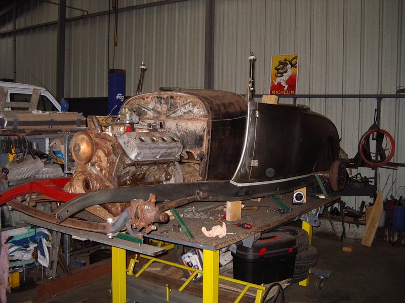

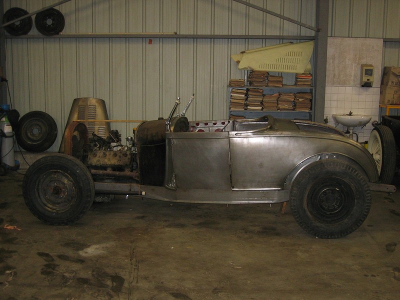

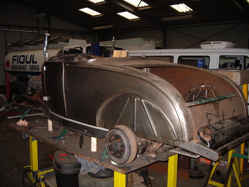

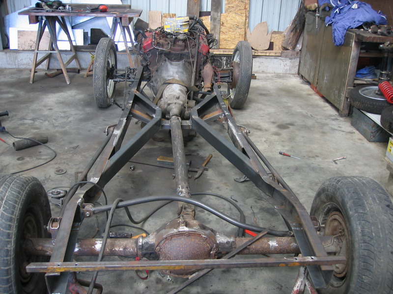

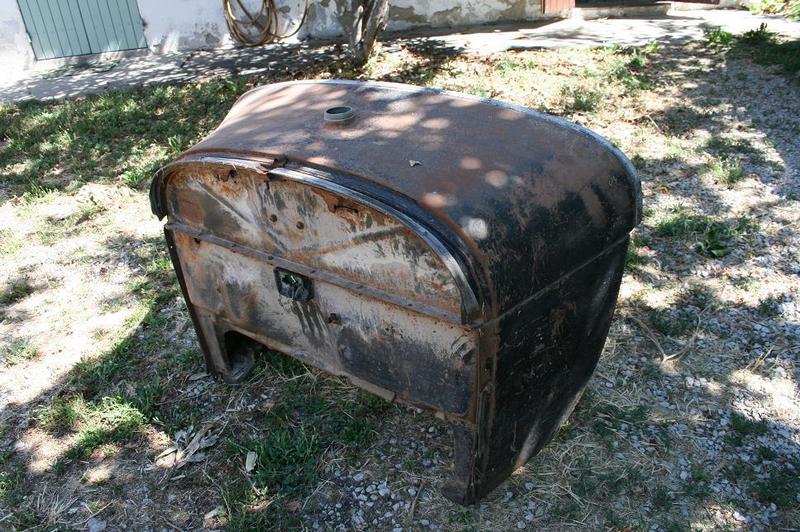

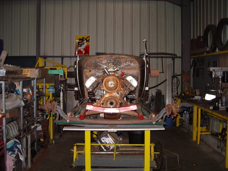

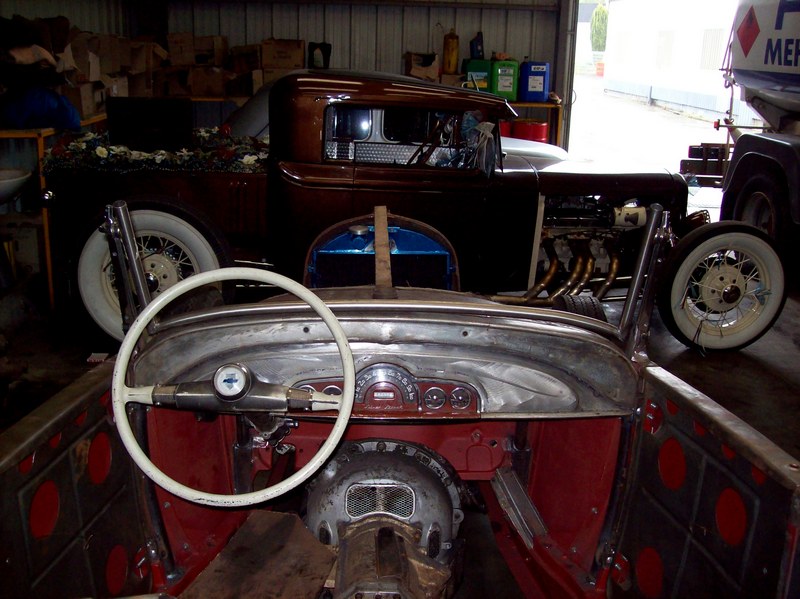

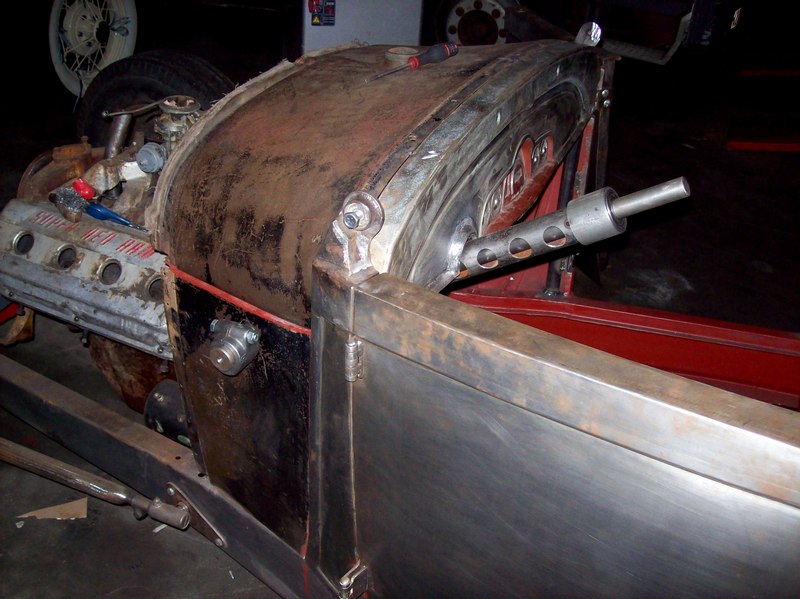

    now my actual project!
    a ford 28 roadster..... 95% scratch build on a 32 frame with a dodge hemi...
    only the cowl is original...

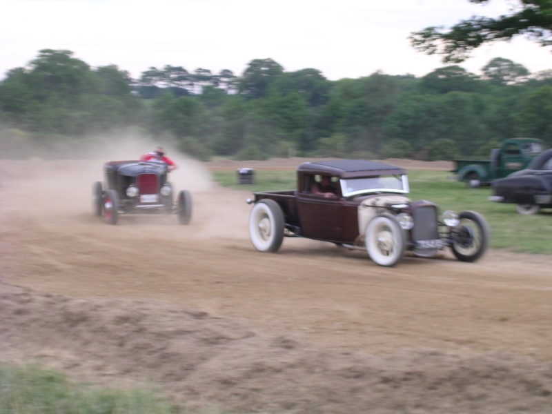

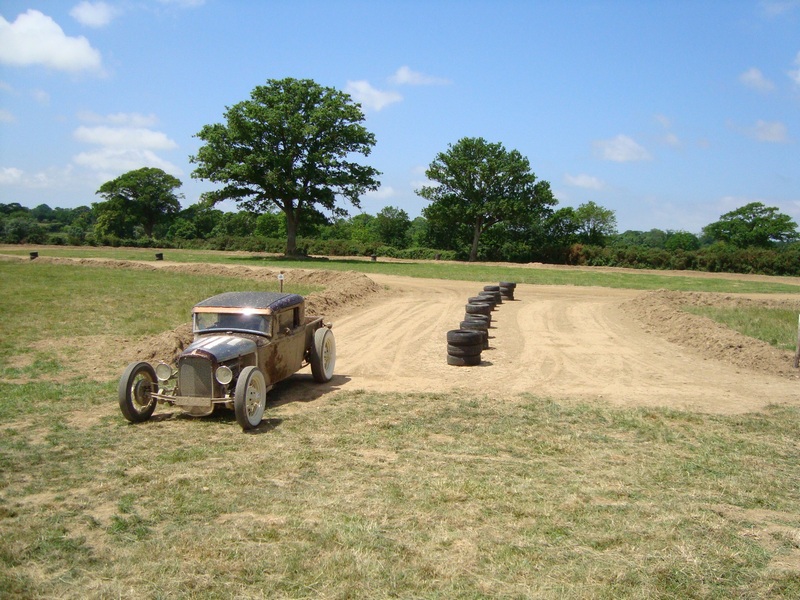

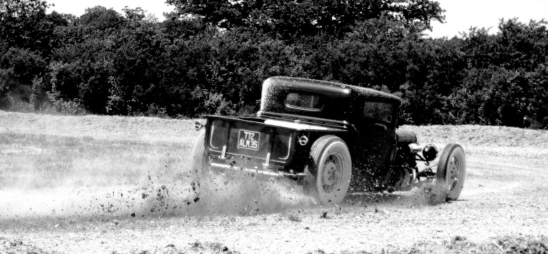

    some new pics of my pick up in action on an oval track....

    That truck on the dirt is a priceless memory!!! Waaaay bad ass.

    The truck is bad ass!

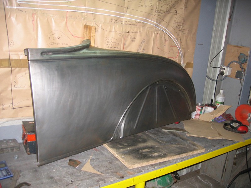

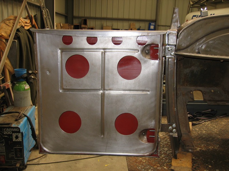

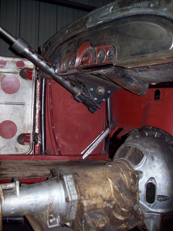

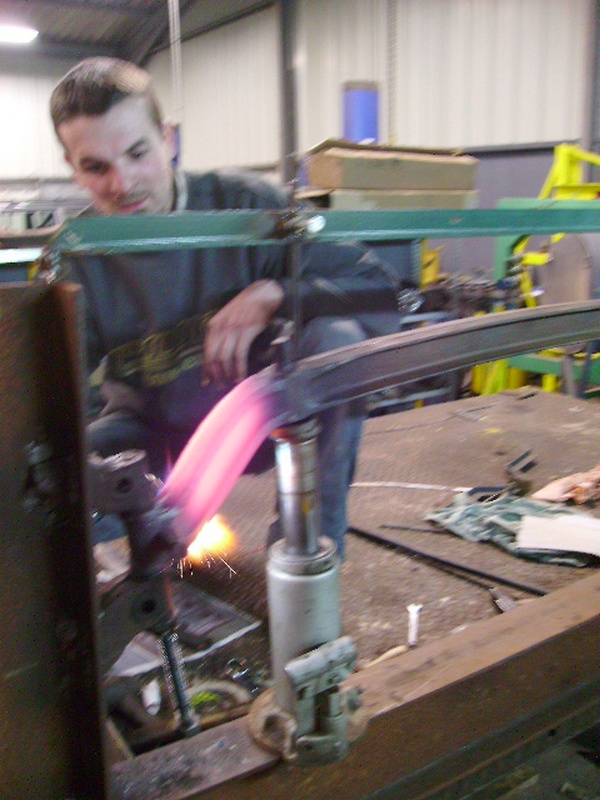

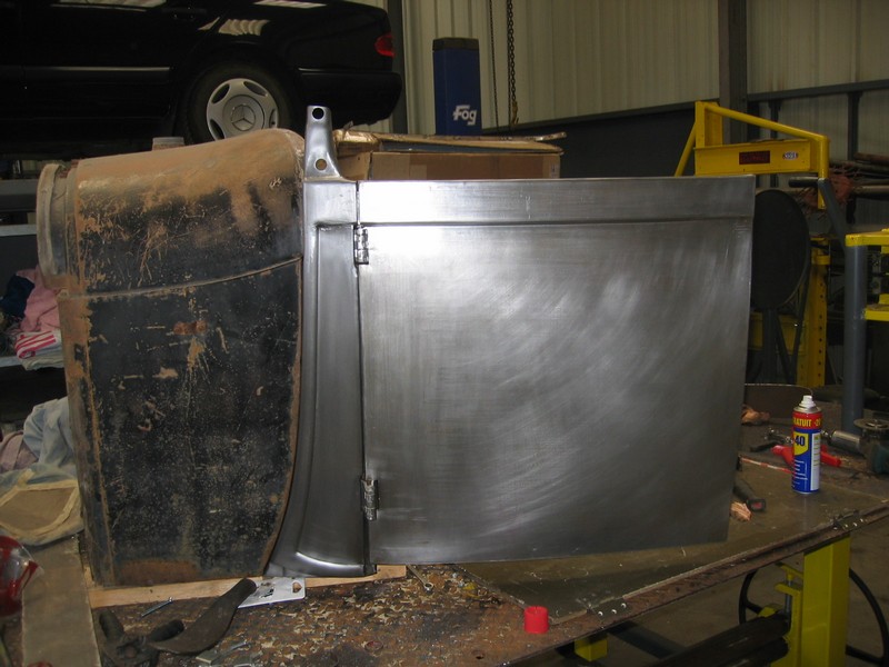

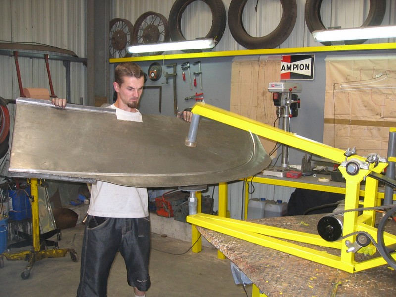

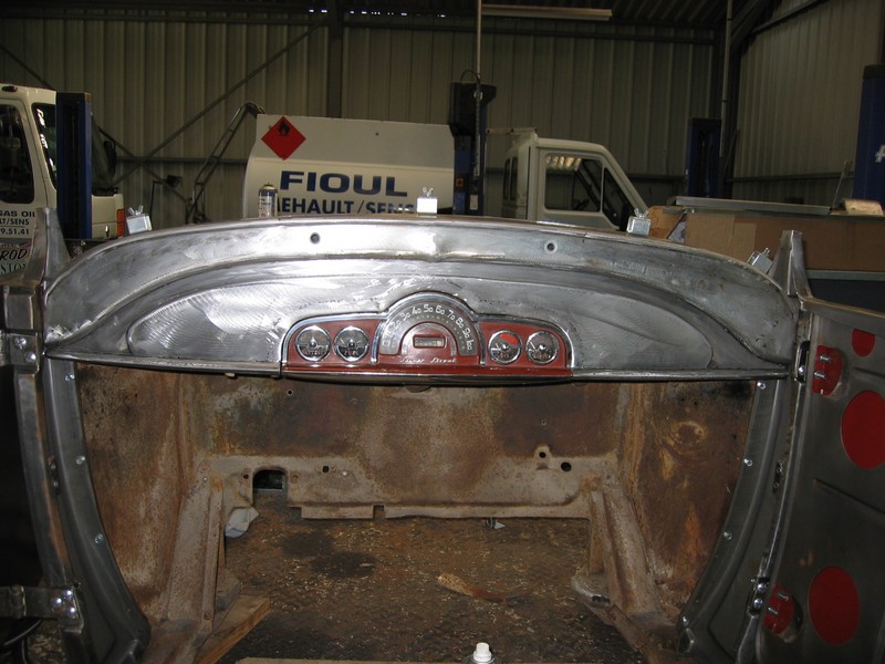

    News of my roadster....
    Modified Citroen Traction headlights with 3 hand made ribs
    new rear floor
    custom cowl steering arm
    head lights bar with shock mounts
    modification of the left headlight for the steering arm clearence
    hand made motor mounts
    home casting tail light bezel (olds 98 1951)
    from left to the right
    -ready to polished home casting reproduction
    -original bezel
    -fresh casting
    new rear panel with the olds tail lights
    finaly, I will intall the complet tail lignts like the right side, so I will reproduce the second parts of the bezel to
    fabrication of a trans adaptator to fix a muncie to the dodge hemi
    ready to buid the X member
    brake links
    rear shocks and whishbone (ford 36) mounts
    welding of the boxing plates
