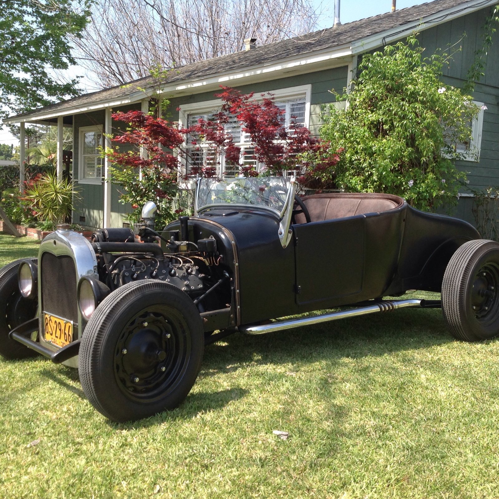

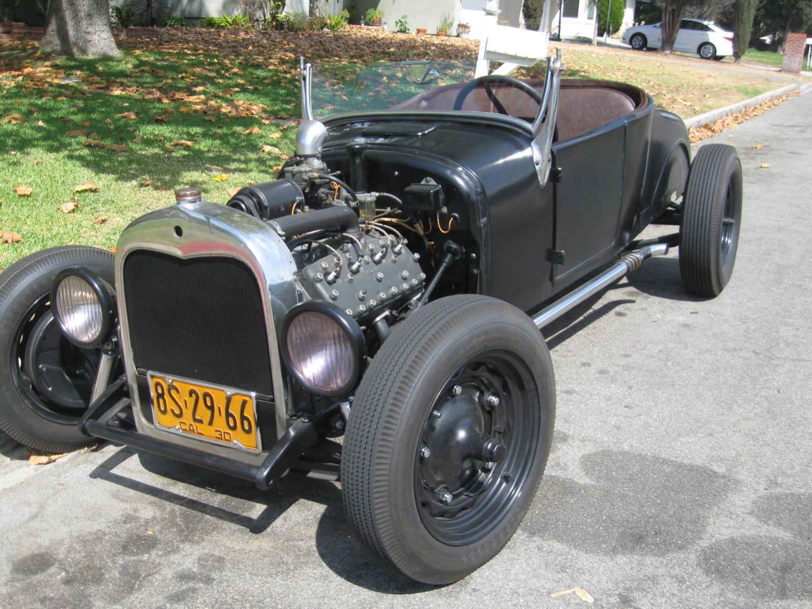

  11. Southfork
    Joined: Dec 15, 2001
    Posts: 1,465
    Southfork
    Are those early Lincoln brakes up front? What's the steering from?
  12. Dennis Lacy
    Joined: Apr 27, 2008
    Posts: 1,482
    Dennis Lacy
    We helped set up the front axle so I can answer that.
    The brakes are '39-'40 Lincoln with '36 wide five drums. These drums have the correct bearing offset to line up the shoe surface with the "deep" Lincoln's. The spindles are '32-'34 which have a built-in steering arm for the drag link. The steering arm originally is fairly straight and was reshaped to follow the curve of the axle and decrease the angle on the drag link as much as possible. The axle is an original '33-'36 that was dropped, '33-'34 wishbone uncut, Model A spring/perches/shackles. The steering gear is an F-100 truck and the adjustable drag link is a shortened '32-'34 tie rod.
    The spindles use a special kingpin kit (that we package and sell) which places thin Torrington bearings between the spindle and bottom off the axle. This is necessary because the original early kingpins have a big knob on top (as part of the mechanical brakes) which would not otherwise allow the brake plates with their deep spindle pockets to fit over the spindle.
    kidcampbell71 and patmanta like this.

    That T is just nasty (in the best possible way). Great job on the fan as well; most guys woulda' chickened out & went with the E-fan. Very well done, sir.
    Would like some info on your seat construction...that's exactly what I'd like to do with my T; at 6'3" I could use the extra inches a seat like that provides.

    Squablow
    Great car, any pics of how the exhaust is routed? Is it baffled? Are the pipes stainless, and was stainless exhaust tubing in use in the late 40's? I'm doing a very similar '26 and I like this setup for exhaust, would love some details.

    from ma
    very cool T! you are missing a couple post 48 items like the steering box and whatever that master cylinder is off of though! both my 32 and my 28 have similar ch***is, minus the 8ba in the 28 and the 283 in the 32.... love it!

    trosa54
    Thanks 117harv for the jump start, Just brought it out for a spin Sunday, nothing's changed, just keeps on pleasing me.
