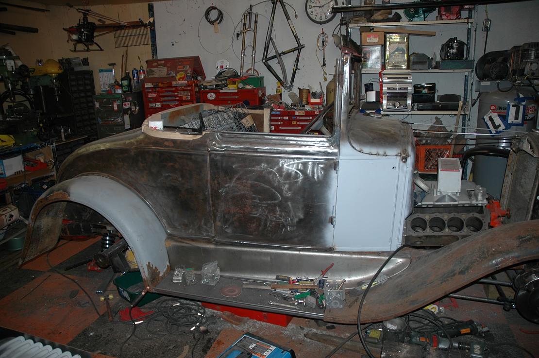

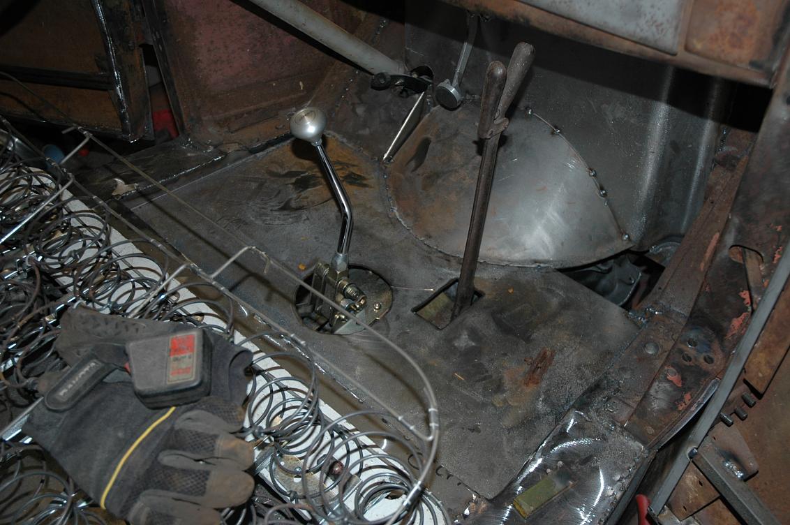

    I must ask that you excuse the messy garage...too much junk, not enuff space.

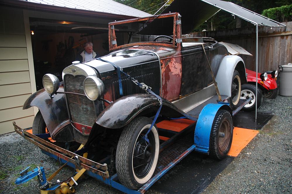

    Some earlier stages.

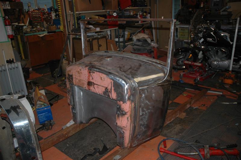

    A couple more pics..1 of our old rod, 28 Sport Cpe.
    and some more of this project
    32 rad shell (Medium).JPG rear floor (Medium).JPG Drivers door (Medium).JPG hinge now (Medium).JPG
