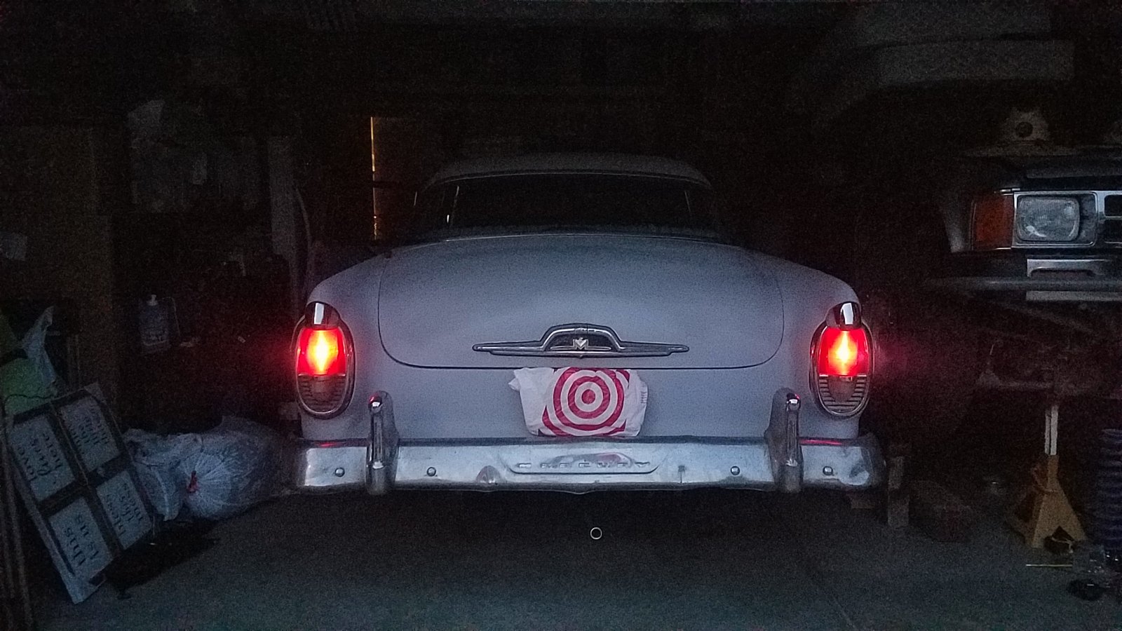

    Late response... Sorry. I mounted LED trailer lights inside so it is brighter then the halogens:
    Hope the pic is allowed
    To mount the lens I actually put some clear silicone to hold them on

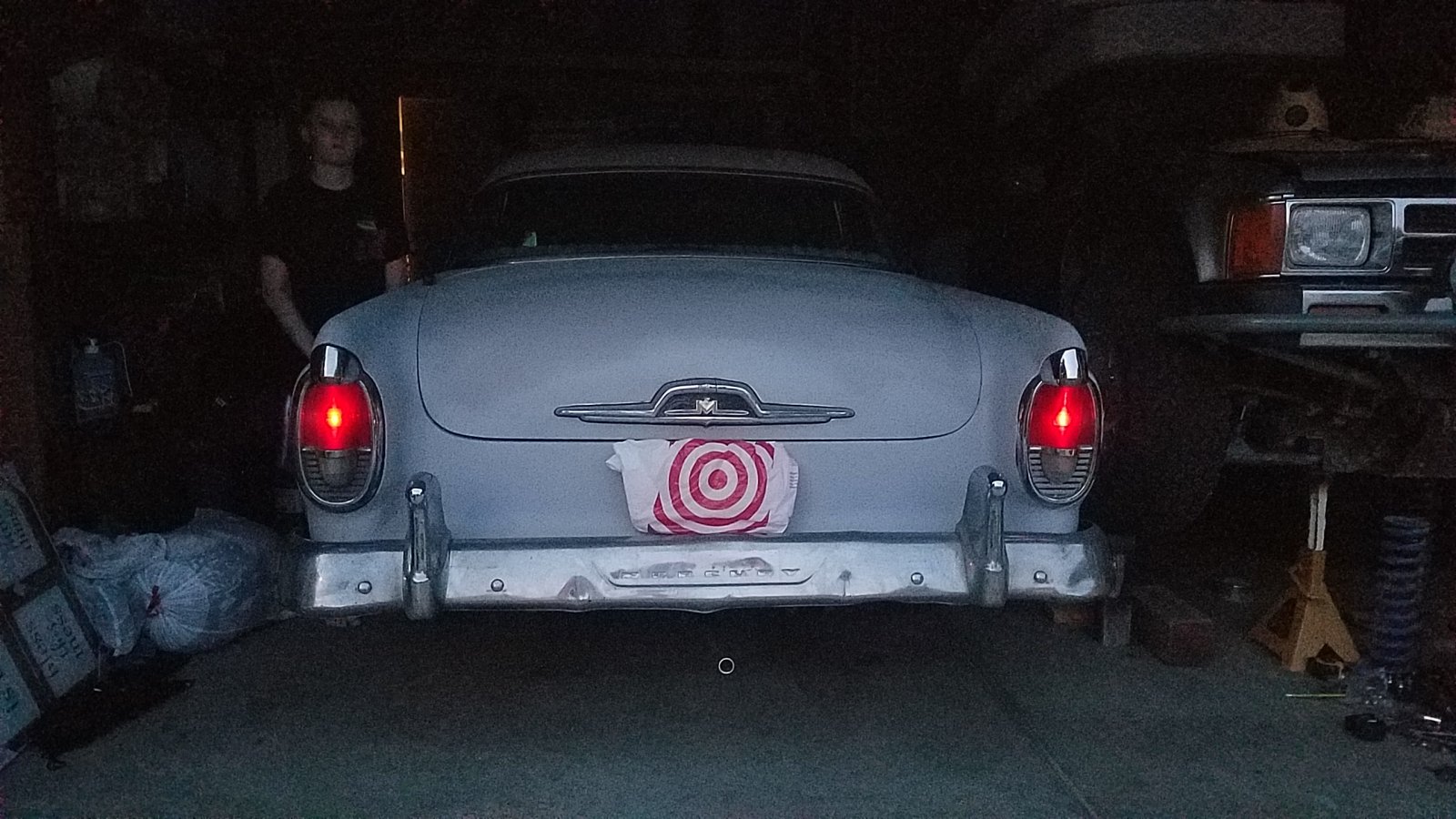

    Picture of inside my light:
    Lit up on car. Night running and brake lights. LED on right Stock on the left.

    I didn’t even think to use an existing led unit under the lenses. From your pics, it appears to be very effective. I’m glad I have not started on my overly complicated light array I designed! :)

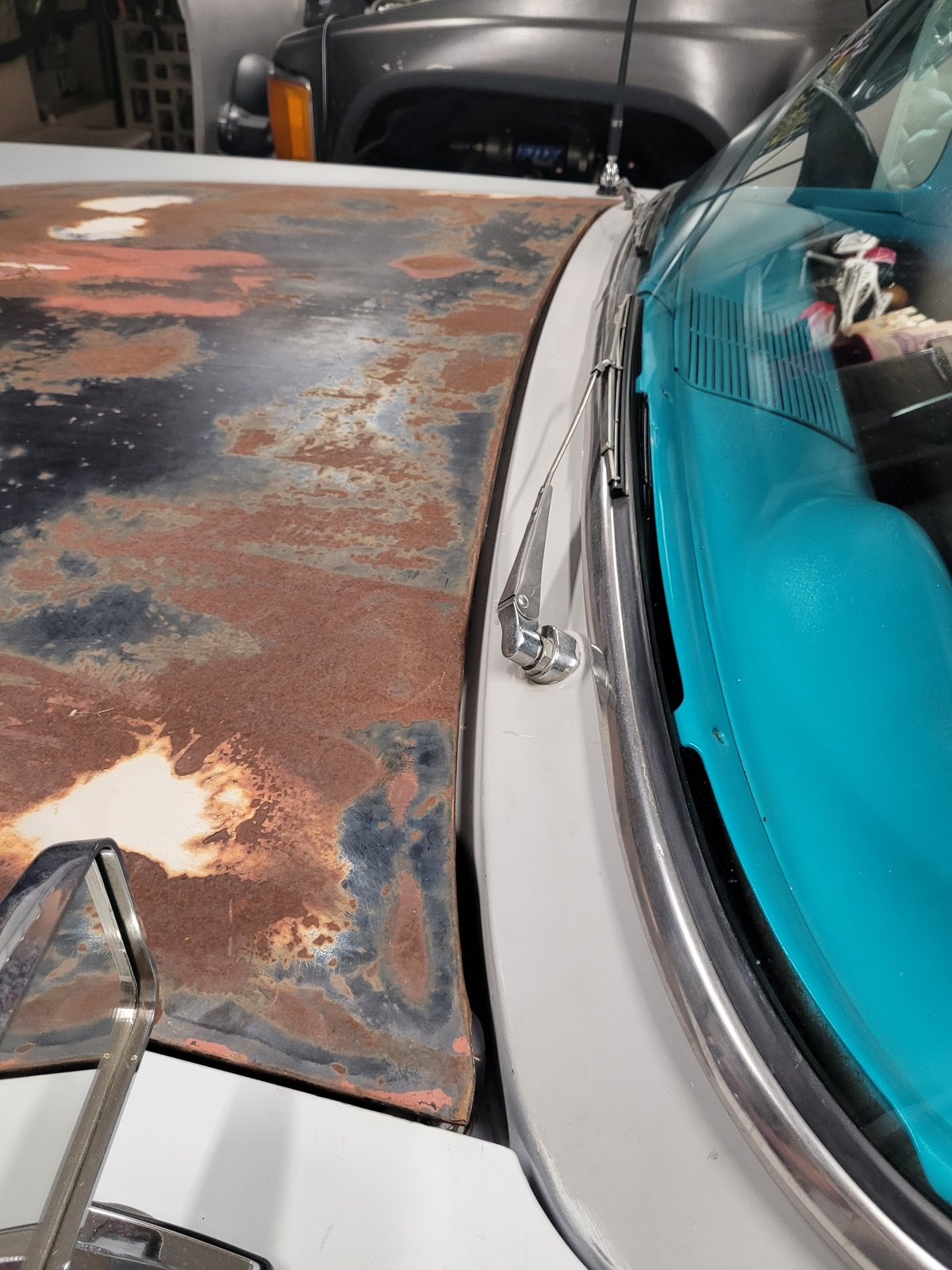

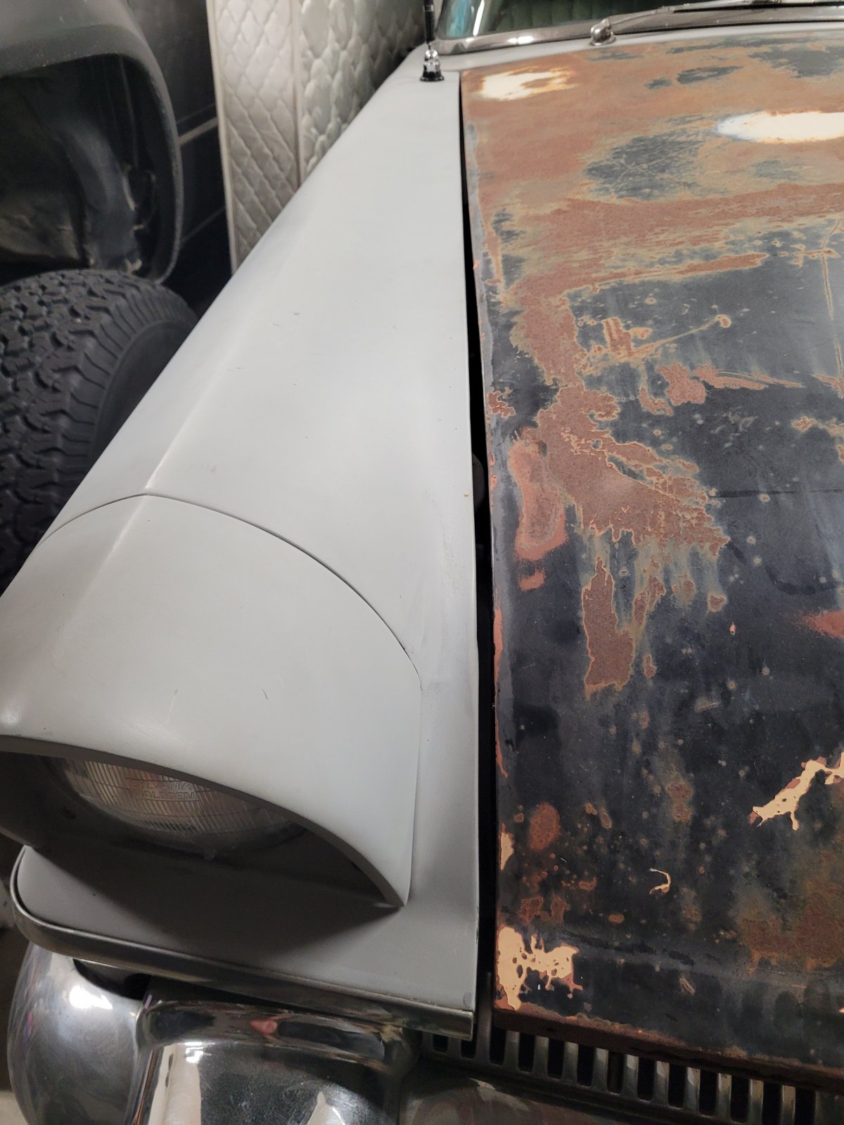

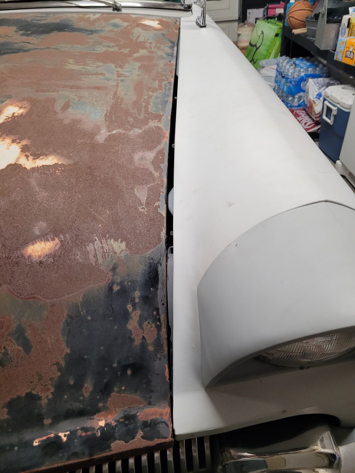

    Does anyone have any tips and tricks to get these gaps smaller and more uniform? I have the bolts slightly tight allowing me to move it around but it is either good on one side and bad on 2 or bad on all. I tried loosening the fender and moving it around also.

  12. jimmy six
    Joined: Mar 21, 2006
    Posts: 17,143
    jimmy six
    ^^^^ Welcome to the world of 1956 ***embly. Mallets and rubber hammers. Sorry to say these are not new Hondas or Volvos and Kendig is not ***embling your car at $500.00 per hour. Just do the best you can and paint it a dark color.

  13. Adjust the hood for best fit at the cowl, then adjust the fenders. You'll need some body shims (U-shaped washers) for the fenders along with tweaking the inner fenders. It's an exercise in patience....

  14. 56MercMan

    Thank you Steve. Still playing with it but got closer tonight. I believe I need to slot some holes a little at the very front of the car as the fenders are ****ed in as much as I can and the gap still gets larger towards the front.
  15. Keep in mind that it's sometimes better to use shims rather than move an attaching part and possibly mis-align some other part.

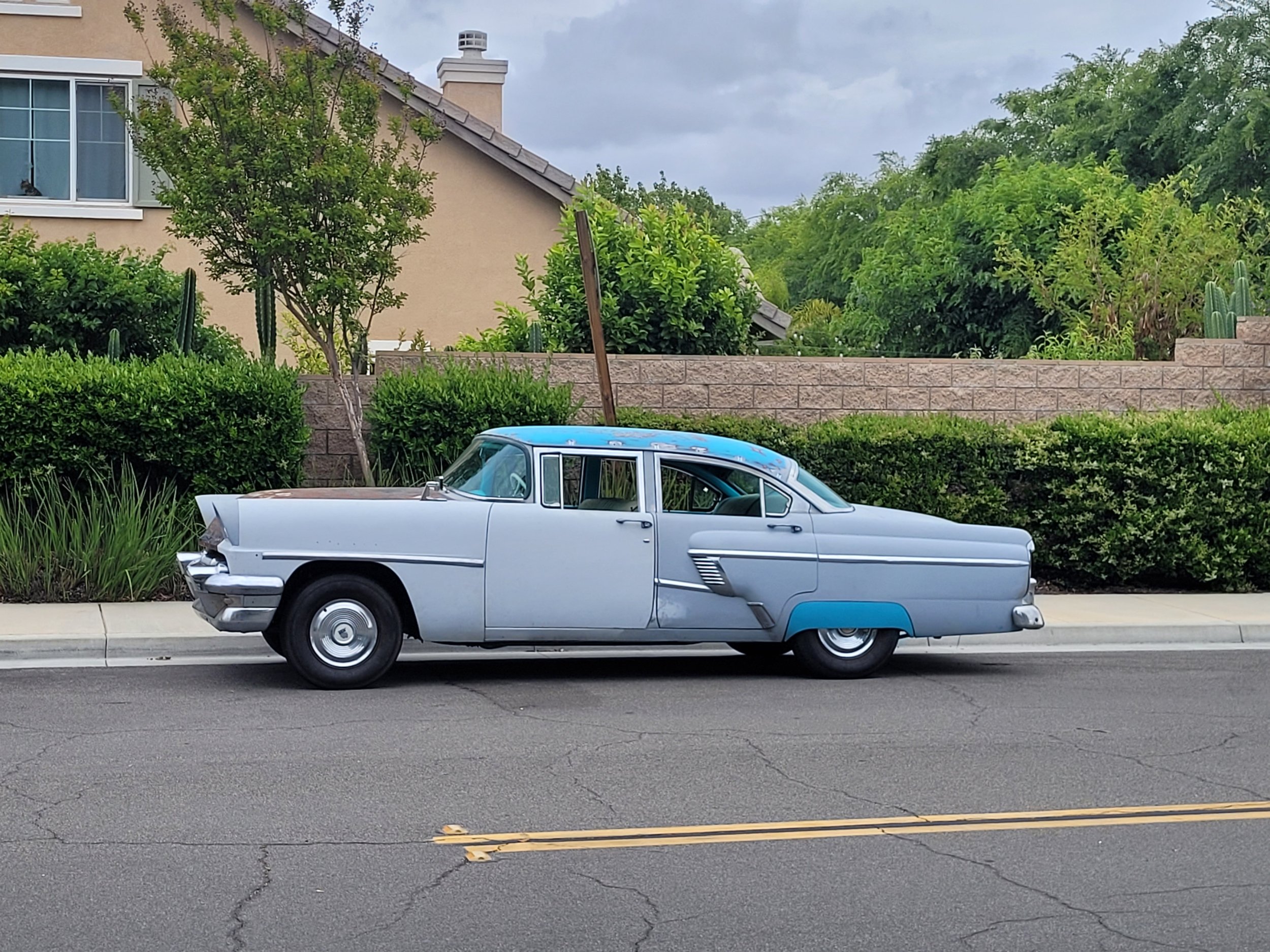

    Spent a lot of time on getting the car lowered after a trip to the grocery store and they gave me some extra bags. Never dealt with them before so a lot of trial and error to get where I am now.
    Got a factory driver side mirror that needs a little work but got it really cheap. So I can replace this plastic one and put it in the correct spot.
    Looking into drop spindles now but I have the Performance Online disc brake kit on it already so not sure what would work with that and options very slim. Wondering if buying stock spindles and making my own would be an option. We have built offroad spindles in the past. I am trying not to cut the frame up so that is why I want spindles instead of just cutting the coil bucket more to allow the suspension to set down.

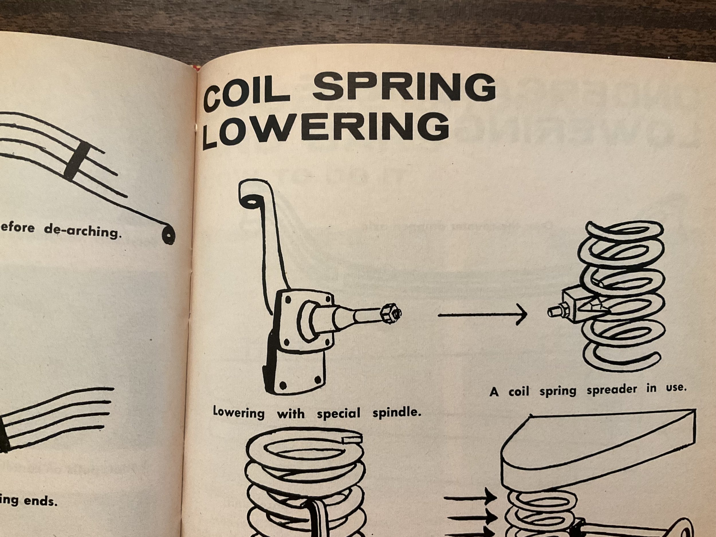

    Here’s a drawing of a dropped spindle from “Hot Rod Magazine Custom Library - Custom Car Wheels and Lowering”. (It’s one of the Petersen Spotlite little mags)
    I would liked to have used dropped spindles on my ‘55 Mercury. I intially used the one inch blocks to lower the spring pocket on the lower control arm. That gave me about 2.5” lowering on the front. I recently changed the front springs to Aerostar springs and removed the blocks. I don’t have any miles on the car since the swap as I’m still sorting out the power steering. Hopefully, I will have about a 3” lowering in the front to match the 3” block lowering in the rear when I finally get back on the road. :)

    Stance looks great! :cool: My Ford is just sitting on Aerostar springs in the front and Posies 3” dropped springs with 2” blocks in the rear and sits similar.

    How is your ride? Right now at the lowest it is sitting on the stops. If yours rides at that height normally I would ***ume you are bottoming out frequently. No? Or did you modify the stops so you had more up travel?

    I cut the rubber bumpers in half in the front and do occasionally bottom them out, but not very often. I think I put the Aerostar springs in about 10 years ago or so and have driven on them for 30k miles or so. They probably settled an inch since I put them in. And, the rear is maybe too low to be honest. I'm debating either going to 1" blocks or putting some helper bags or something on it. I love the look, but it is too close to the bumpers and bottoms out regularly. I did just have 2" blocks for the past 14 years, and just put the Posies springs in. I was hoping to lose the blocks all together, but it wouldn't even be as low as the stock springs and the 2" blocks when my goal was some lower going to the Posies.
